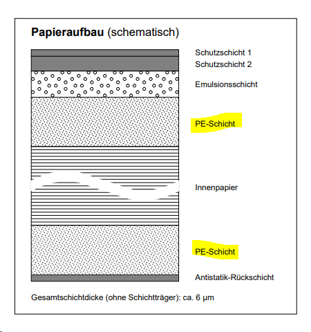

This is strange; I always thought (and still do) PE and RC mean the same thing. From Agfa's latest MPC pdf:
So what does RC stand for?
I guess so. And yet you state that resin coated papers do not exist.

How do those two differ? I always thought PE was the British (and other countries') term for what we in the U.S. refer to as RC.
PE means the paper base is polythene encapsulated, with a thin film on both sides when you tear a print which isn't easy you see the polythene stretch slightly then break, so quite different to RC where the paper base is coated with a resin...
As a side note, that's yet another instance of two countries separated by a common language. It's still referred to as polyethylene in the U.S., not polythene.
OK, the main question remains a mystery to me. What is this "resin" if not polyethylene/polythene?
Looking at it from a historical point of view early PE waterproof papers used plastic encapsulation of the paper base, using thin layers of plastic film applied to both sides
The difference is that RC papers have a Polyethylene polymer resin coated on the paper in liquid form, Polyethylene Glycol for instance is liquid so are other polymers.
