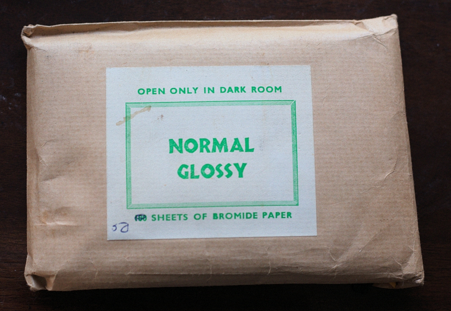

I acquired this paper last year, unbranded. However I did buy some similar Waterproof paper new in the 1070s, before the release of the Ilfospeed RC papers.
It's a PE (polythene encapsulated) paper. It would have been UK government/military surplus stock, made my Kodak Ltd or Ilford, or maybe Barnet or Kentmere. I would guess the term American Glossy just meant it air dried to a high gloss, without glazing.
