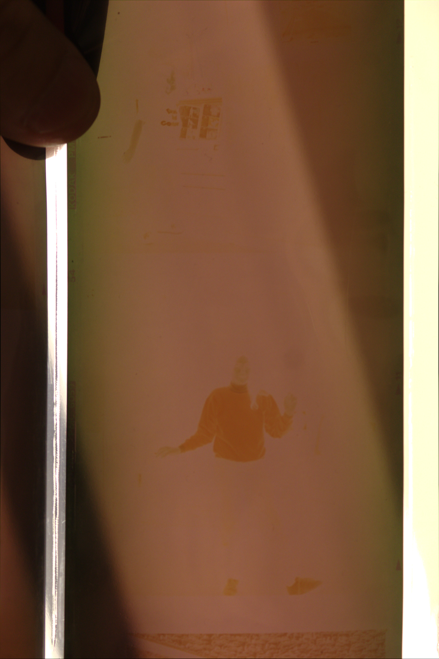

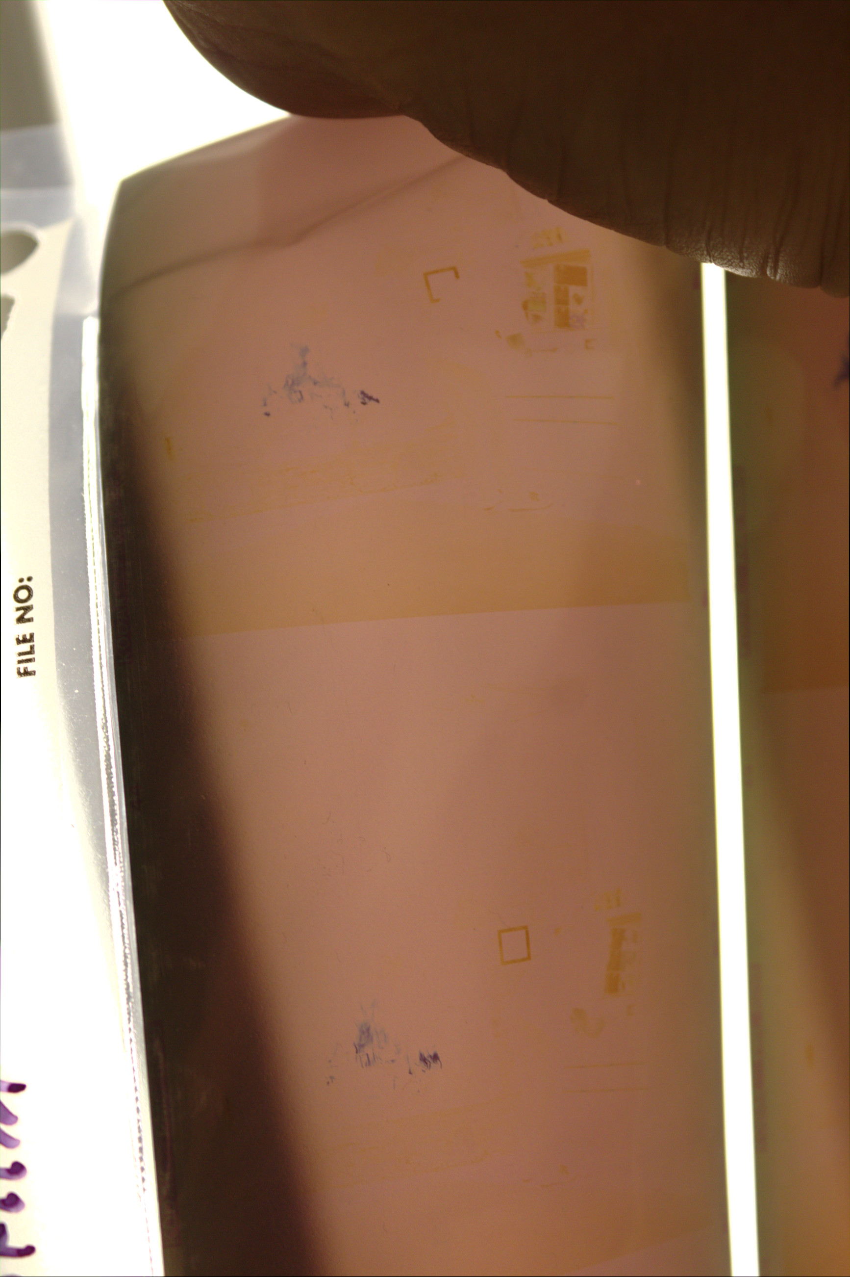

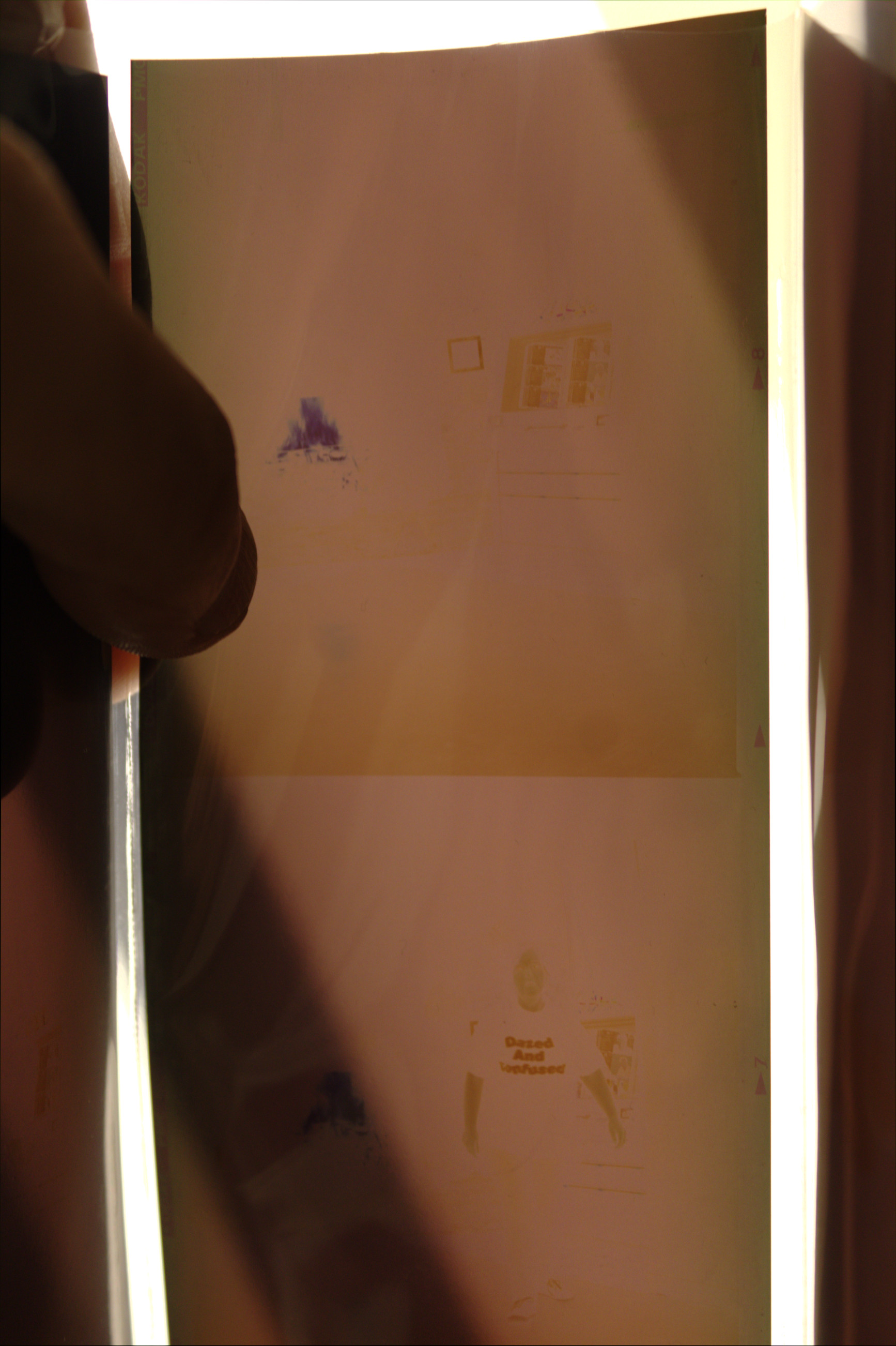

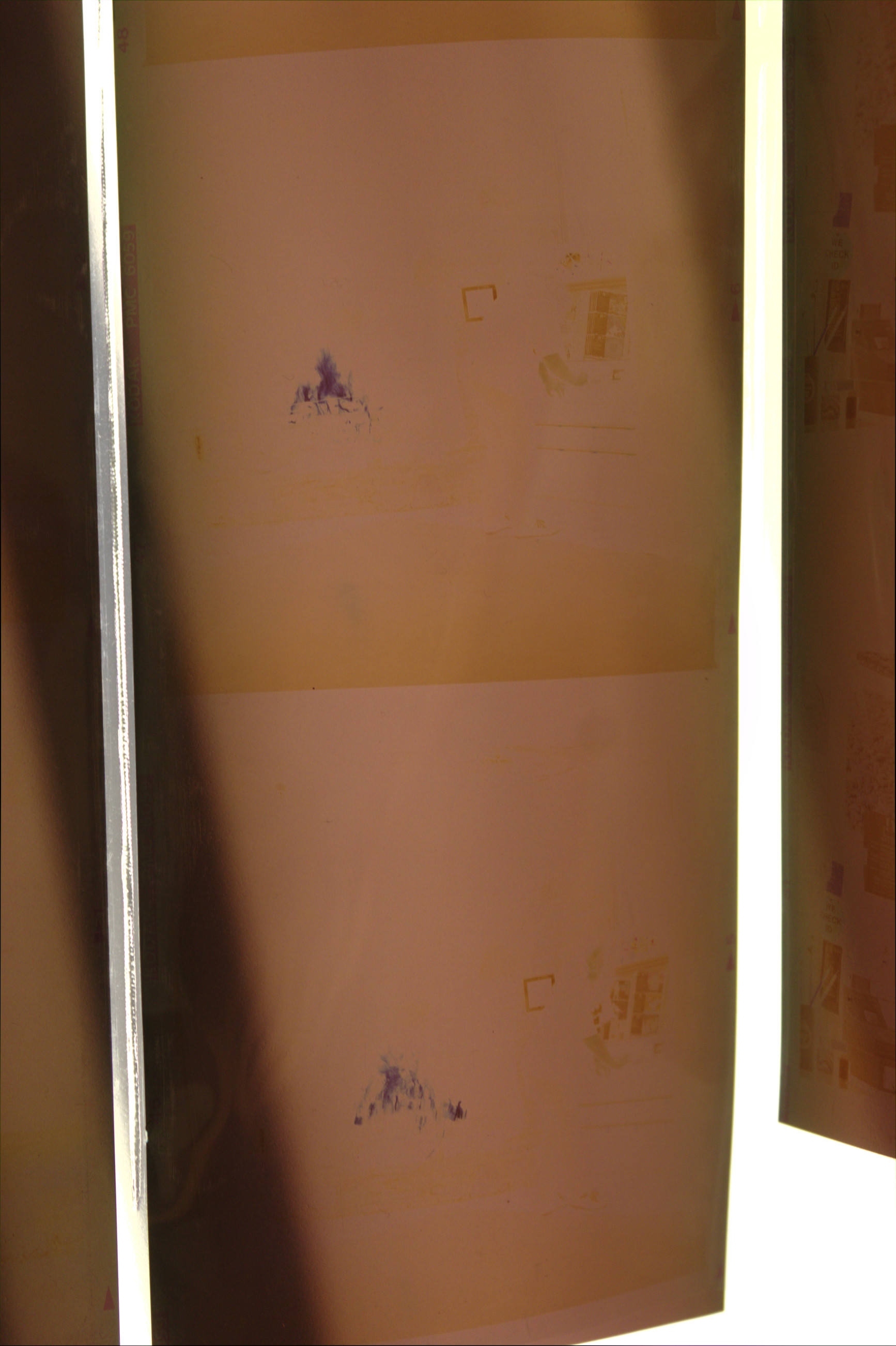

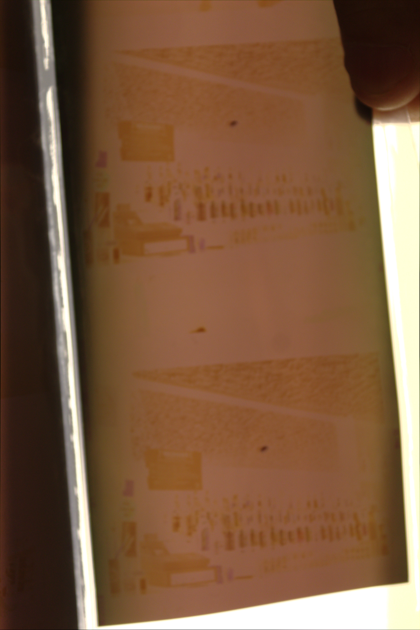

I used my Canon T5 to take pictures of the frames up against a light source and then I brought them into the computer. I had to play with extreme curves and I have an idea what this film was used for and as far as subject matter and intent; I was more than likely drinking that night and it may also be very possible that my exposures may have also been on the underexposed side.
The side markings on the film are visible but not as strong. So there is slight fog, underdevelopment and maybe underexposure. My guess is that even if I developed this roll back then it may have not been optimal but prints would still have been possible.
I am surprised at one thing. That wasn't me wearing that Dazed and Confused shirt. It was my mother wearing that shirt! I have other older photos of mom so this isn't a total loss but it does suck.
Below is what I am working with. I don't have a film scanner.

No, once the film is fixed after bleaching, there's nothing you can do. You really have to skip the initial bleach, then fix, then expose to light and develop again. At that point you can either repeat the whole process, or bleach and fix if you're done.
There doesn't seem to be much on the film; regardless of what you'd do, there's not much to be salvaged there. Bummer.
