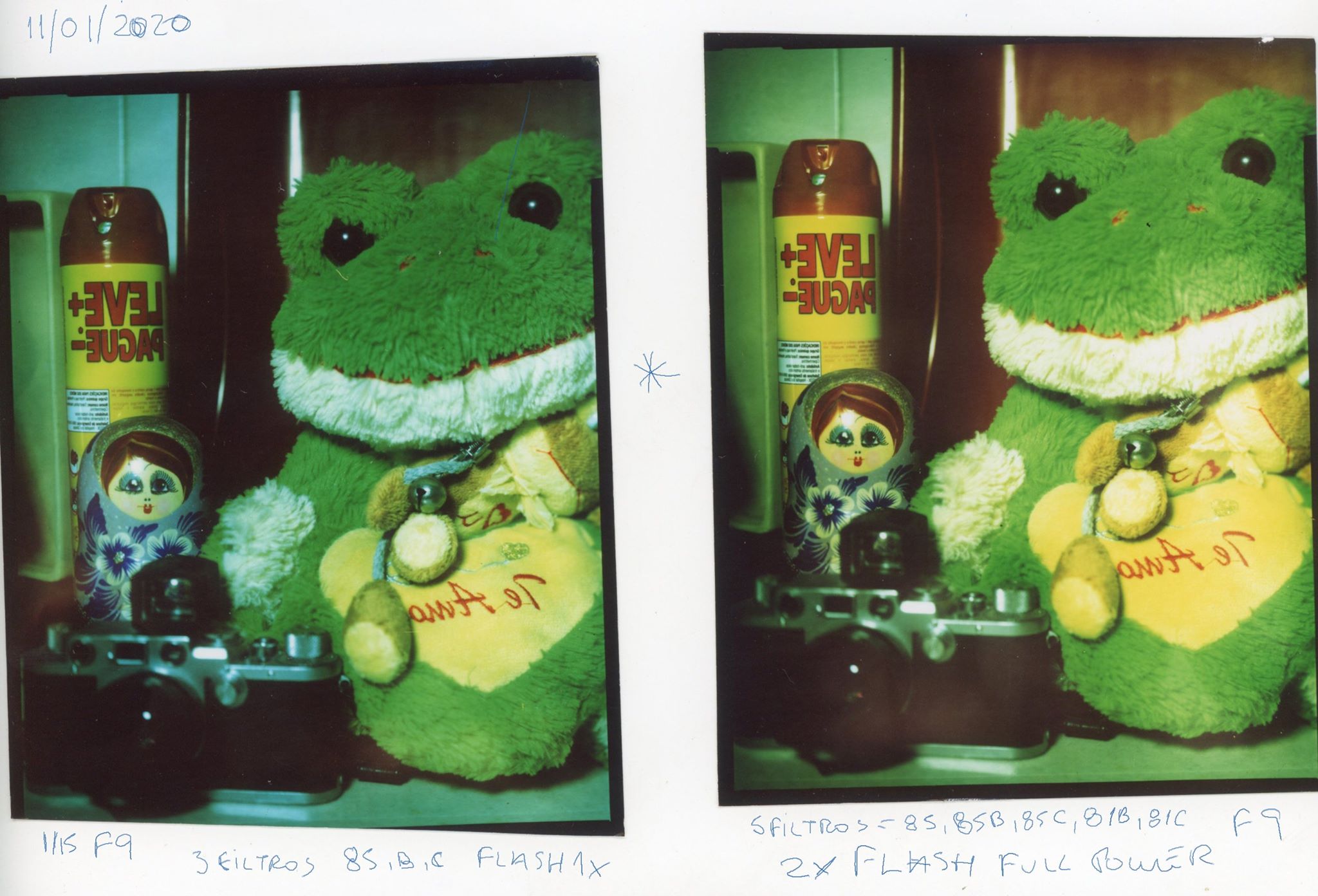

It is certainly not the original and he does not claim to be the creator of the process, even he mentions that he used forum references. But showing the whole process on video brings new enthusiasts like myself, for example, who have never seen anything like this and now I'm very excited to test with my 4x5.

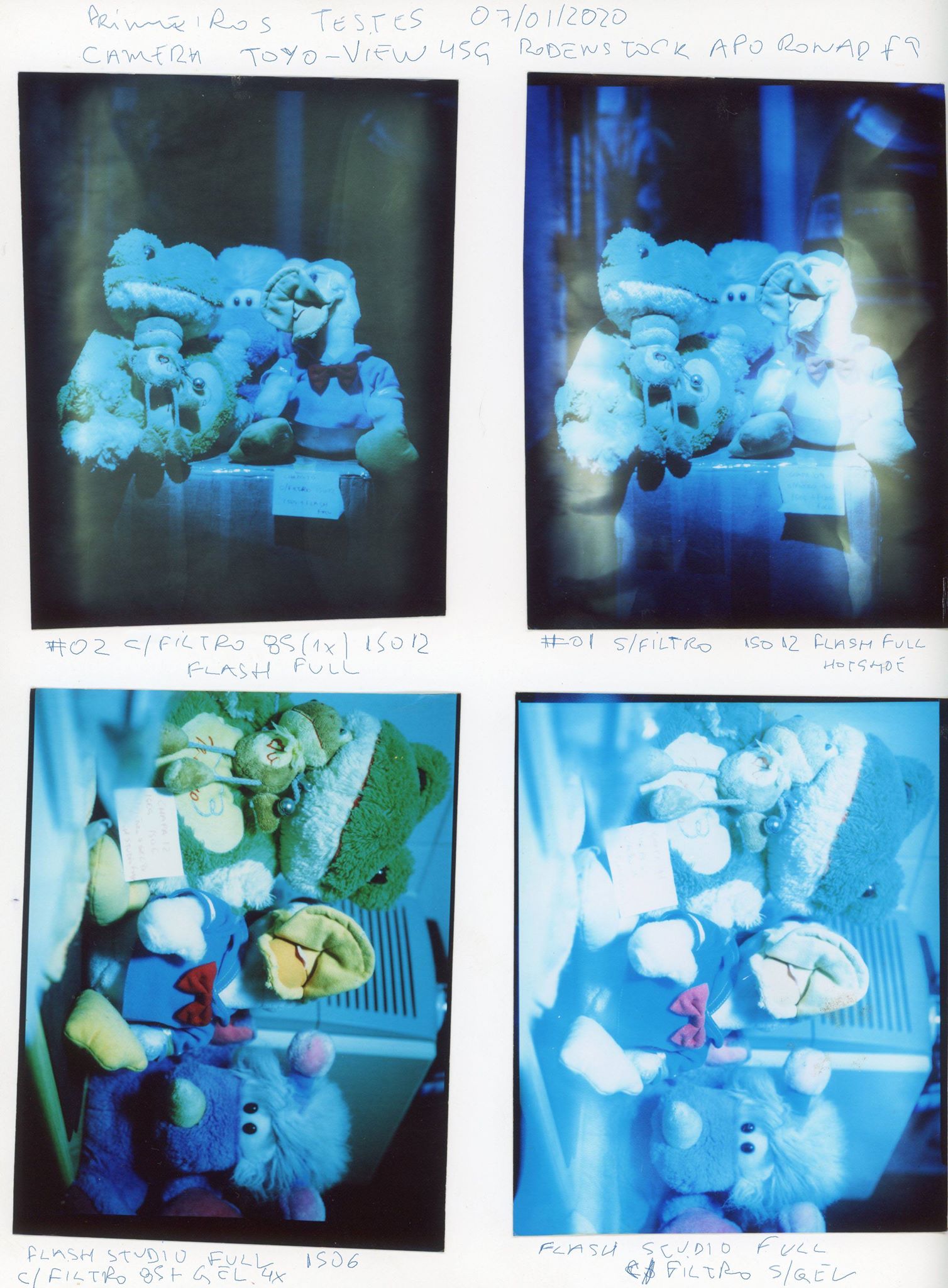

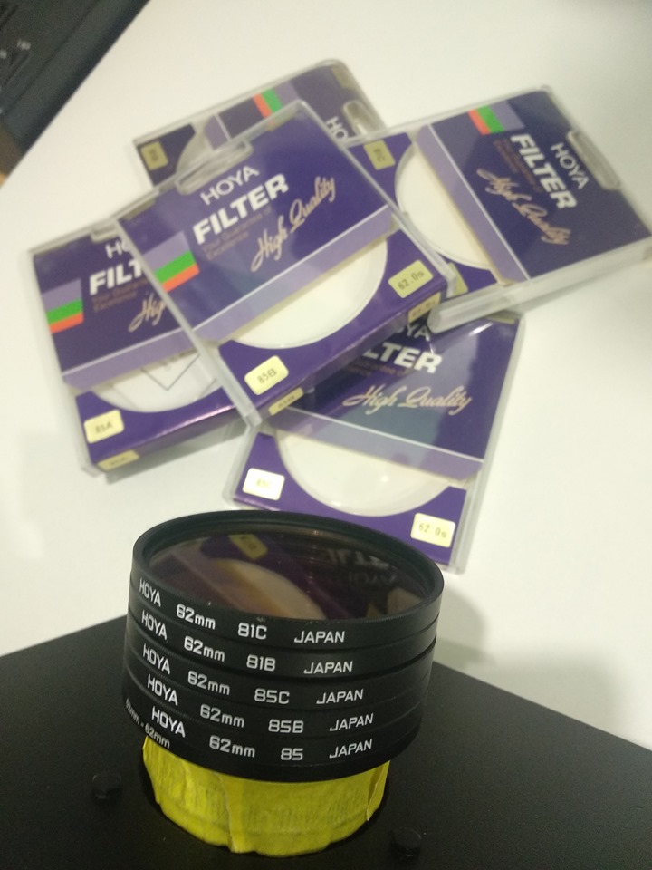

I just got some paper (using Fujifilm Crystal Archive) and I'm already doing my first tests for now using warming filters Type 85 and 81.
Here are some of my results...
81702242_2930096817023570_3818963569597218816_n.jpg 82016124_787160891760133_7126435742997282816_n.jpg 83089260_939358326460114_380359318731489280_n.jpg
Now trying to find a set of Cibachrome filters for fine tuning and maybe be able to apply the process to portraits with flash.

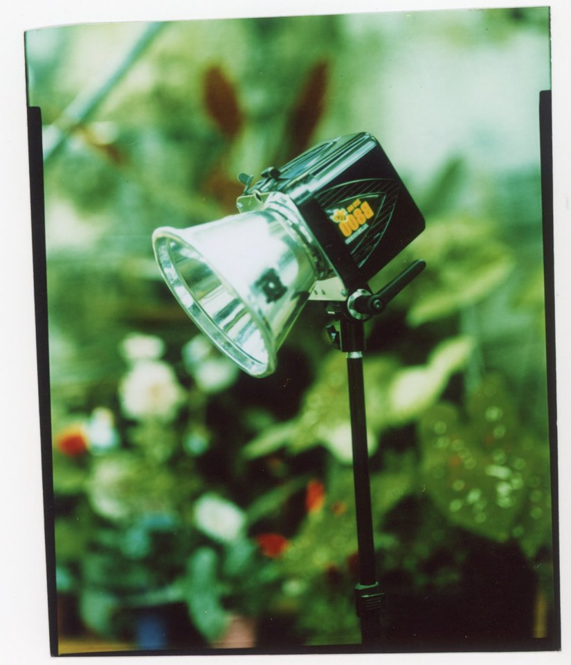

Continuing the tests... I would like to share my best result so far.
I rate for about ISO 1, filtration is 3x 85 + CC20M light source flash.
Dektol 1:2 (1:30min)
Stop (20sec)
Wash/ expose to white light (1min)
RA-4 (1:30 min)
Blix (1min)
