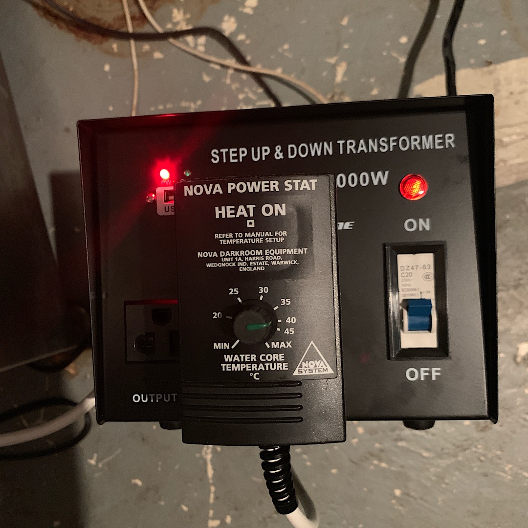

I own 3 different Nove slot processors in the USA from 8x10 to 16x20. I use this converter box without issue on all three https://www.amazon.com/LiteFuze-con...00545NKNU/ref=cm_cr_arp_d_product_top?ie=UTF8 On Monday, call these guys here about the 50hz vs 60hz issue. They make the Nova slot processors in house. https://www.theimagingwarehouse.com/Products/Nova-Print-Processors
Thanks for joining the thread, it’s really appreciated.
From their website their opinion is pretty clear, could you expand on which Novas you have, and are they meant to operate at 50 hz but you are successfuly operating at 60 hz ?
USA & CANADA Customers - Unfortunately, this product is unsuitable for use in the USA & Canada owing to highly sensitive electronic microchip controls which require a 230 volts 50Hz electrical supply. Although a step up transformer can be used to create 230volts from 110volts, the standard frequency of 60Hz also has to be converted to 50Hz in order for the unit to work. You can use a frequency converter but they tend to be expensive.

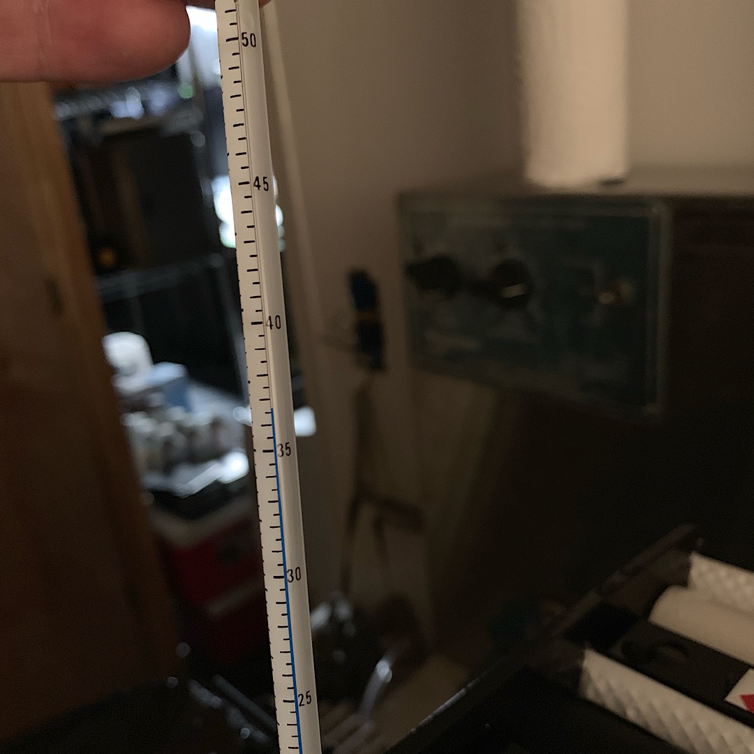

I plugged it in, and it works. The temperature control runs 3 or 4 degrees above actual. I ran the unit for several hours. I’ll run it again tomorrow.

So you cranked up your mains from 110V/60Hz to 230V/60Hz.
The actual bath temperature however turned out to be 36° instead of the set 40°.
Question now is whether this is due to the frequency mismatch of 60Hz instead of the standard 50Hz.
