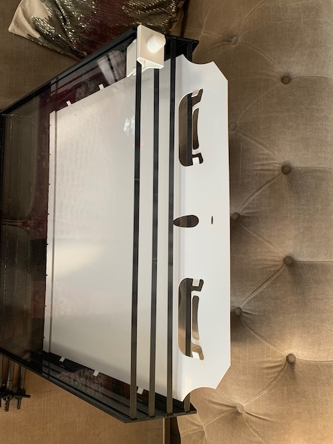

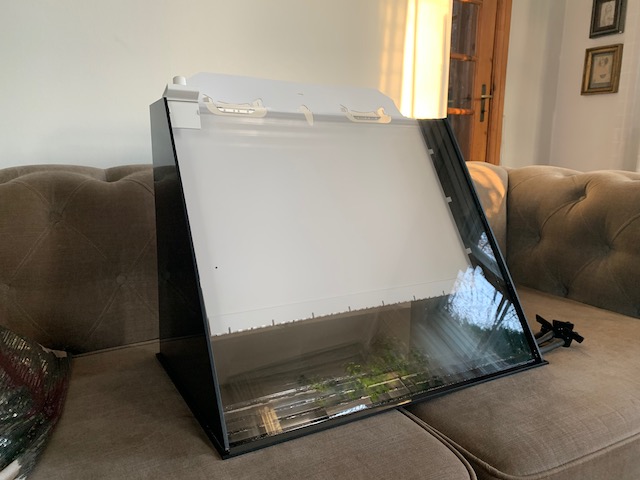

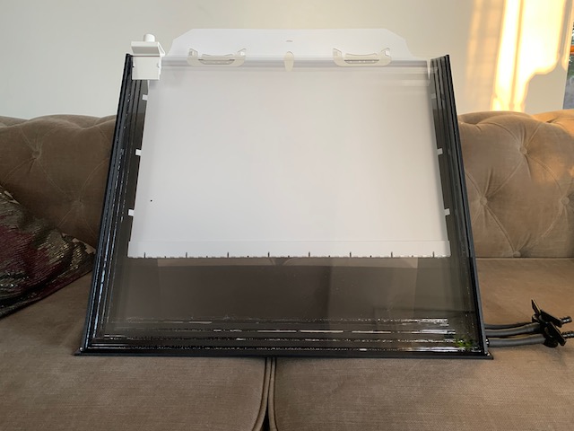

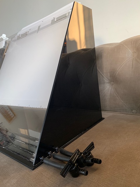

hi, made a new - slanted project and I think it will make the first prototype...

Just curious, what would be the advantage of the slanted slots over vertical slots?
Wrt the edges of the slot divider wall, I use the non-rounded edge as a wipe by gently pulling the paper (non-emulsion side) over the edge and thereby minimizing the carry over of chemicals to the next slot.

spijker - handling of FB paper and preventing to stick with processor wall. Paper lays on the special tray supporting its weight.

Maybe it's different with sheets of 50 x 60cm, but I have no issues with 28 x 35 cm (11x14 inch) FB paper in the vertical slot processor. The textured walls on both sides of the slots prevent the paper from sticking to the walls.
To me, the slanted design and paper carrying trays seems more hassle. And in the end you still need to get those sheets in your vertical slot washer. I suspect that using two clips and vertical slots is easier to use. You can simply lift the paper from the fix slot and then lower it in the washer slot. Compare that to getting a big wet sheet of FB paper from the tray and into the washer. Since you already have the washer, I'd suggest you try what it's like to move wet paper with 2 clips from slot to slot in the washer. You can flip one divider panel in the washer so that you have the texture on both sides of the slot.
The slanted design will be more difficult to build and takes up more space.
