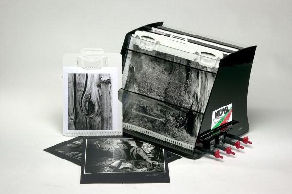

Not anymore, see what they got :smile:, magic’s there.

For your info; the current vertical non-slanted processors although labelled as RC processors also work very well with FB paper. The slanted model in your previous message has been around for years. I don't think it's a new model. I recall reading that this slanted FB processor with the special paper holders is not as easy to use as the clips with the "RC processors". I have a 4-slot version of the heated trimate and use it with FB paper.

Right, i think that model has been around for a long time. But someone at Nova did tell me they were redesigning their processors and their web site confirms it. But I don't see any details or photos at the moment.

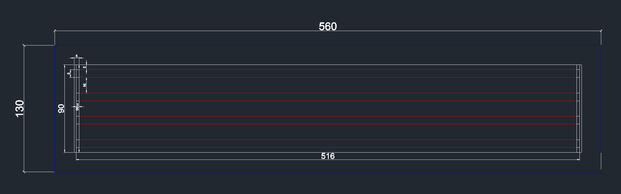

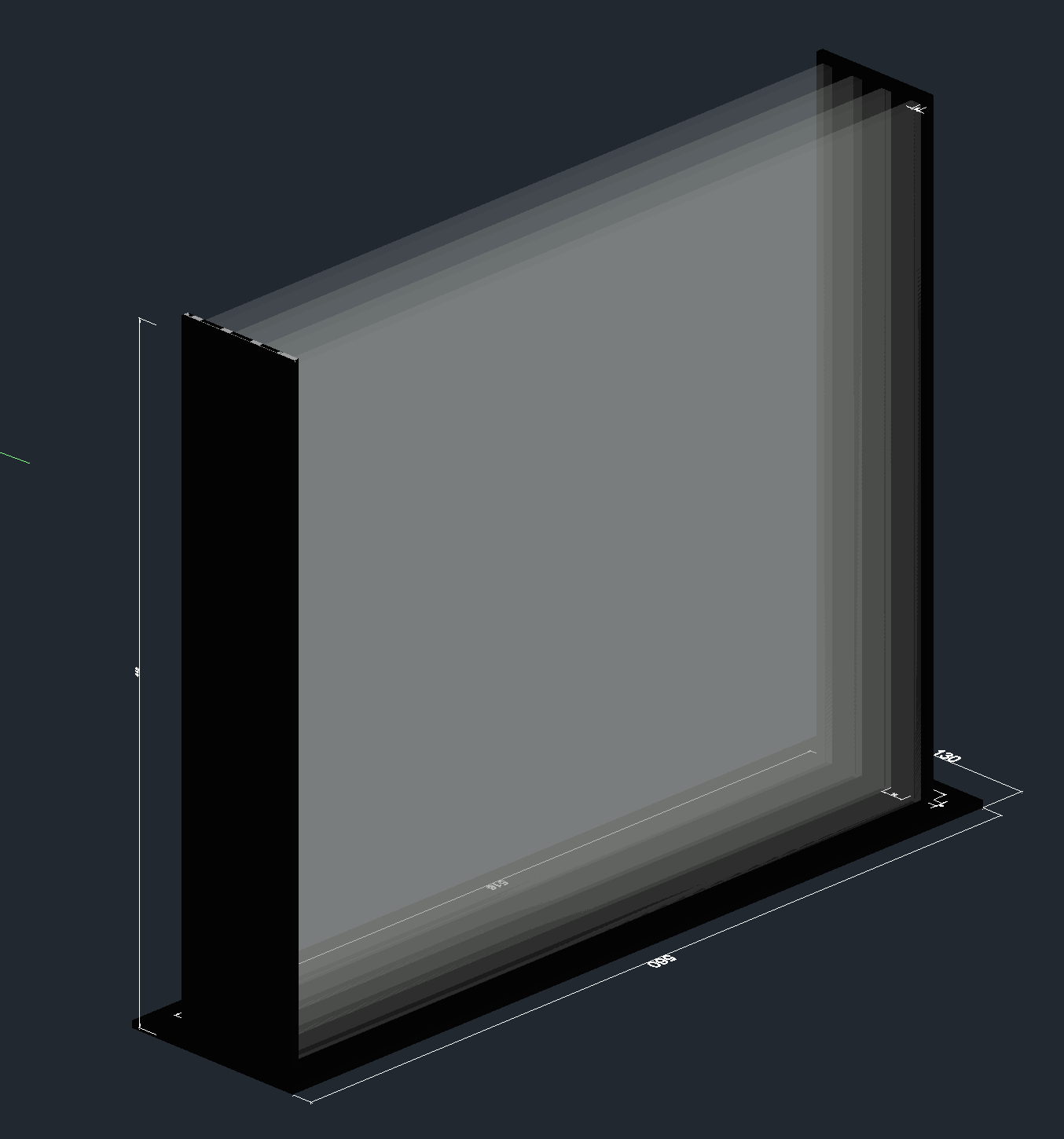

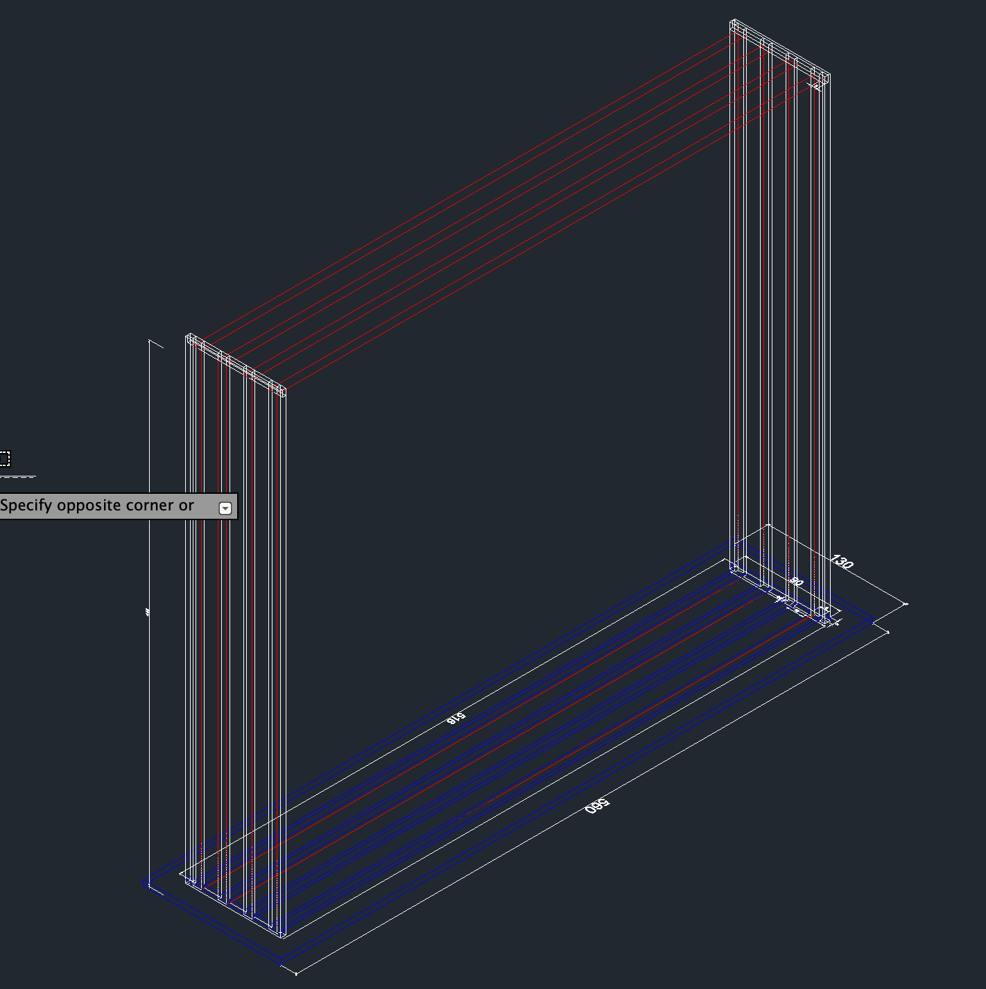

Hi again, I've contacted Nova, and their relaunched processors will appear somewhere in April. As they have already delayed it, it may be May as well. So I decided to act proactively and started the project to build one myself - to be specific by external company, but of my design. I'm enclosing the first version of the projected device. This is vertical, not slanted, not heated three slot processor for 16 x 20 prints. I have not included draining taps holes, as I do not their diameter yet, but each slot will contain one for sure. Everything seems to work, what bothers me is that I plan to use smooth surfaced plexiglass while Nova uses rugged ones in their vertical processors. Any ideas on that? Is it must have feature, or just nice to have? What do you think?

Looks interesting. The textured plexiglass will help prevent the prints from sticking to the panels. That is particularly important for the emulsion side of the prints.
