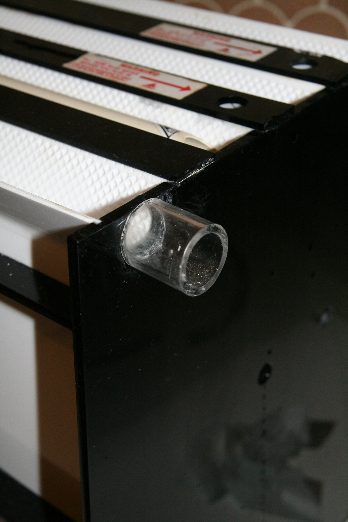

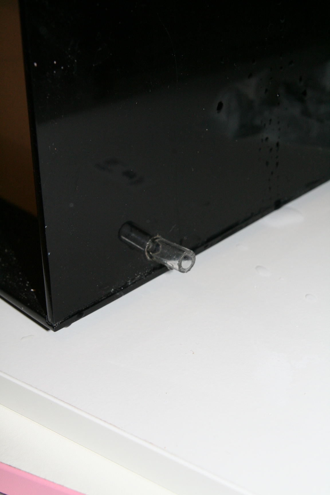

1) How to use the washing tray : does the water has to enter into the big input at the top ( IMG_5612.JPG ), or into the small input at the bottom ( IMG_5611.JPG ) ?
=> in the first case, do I have to find a cork for the bottom pipe ?
=> in the latter case, what is the top pipe for ?

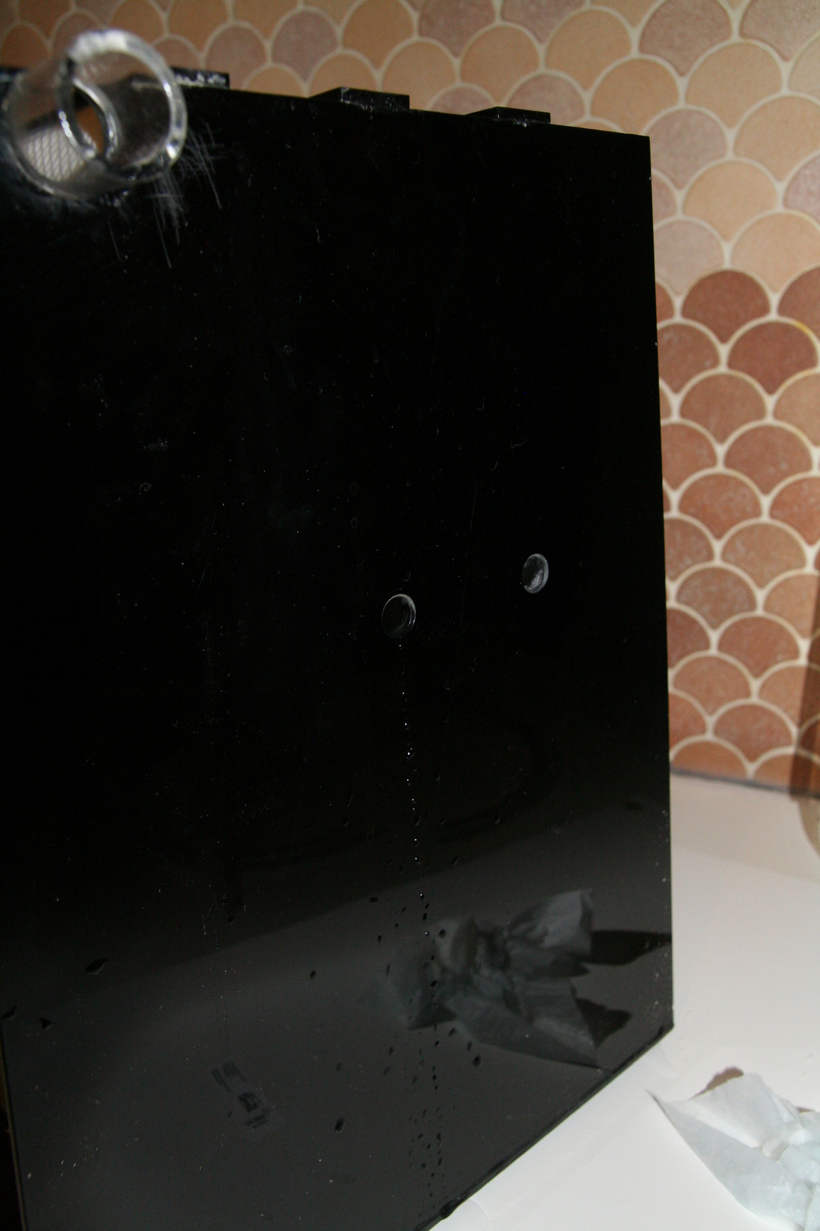

2) I tried to raise the processor once filled up with water and solution, but it's damn heavy, as I suspected. As I use it in my bathroom, I need to move it at the end of each session, so I guess I'll have to empty it, however I don't figure how to empty the water tanks, do I have to lean the processor to make water flow by the two holes on the side of the processor ( IMG_5610.JPG )?
Is there a easyest way of emptying the water tanks ?

To empty the water jacket I remove the two plugs in the middle on the side and tip it to empty it from those holes then lift and do the rest from the fill holes on the top.
For washing, I think you're supposed to fill from the small tap and empty it from the large one on top. They sell a plumbing kit with an outlet hose and such for that. If you're in the U.S. you may well need that, as that fitting is apparently metric, I've not had good luck finding a hardware store compatible piece. I'm going to order the kit next time I order parts.

Regarding the washing slot, connect the tap hose to the small bottom connector, and connect the drain hose to the large top connector.

To drain the water jackets, use a thin tube and siphon out the water, or buy a small pump designed for fish tanks.

flow enters from the bottom and exits from the top.

Don't turn on heaters without filling the water jacket up to the holes in the back, that will break the heaters

I just realize that the tank plugs on the side were not provided when I bought the processor, I'll try to find some plastic pieces to replace it (maybe earplugs?).

those are small plastic faucets inserted in a plastic tube which inserts into the rigid processor tubes. Nothing you can't find in the right store.
The faucets aren't necessary, but they're handy to manage replenishment.
