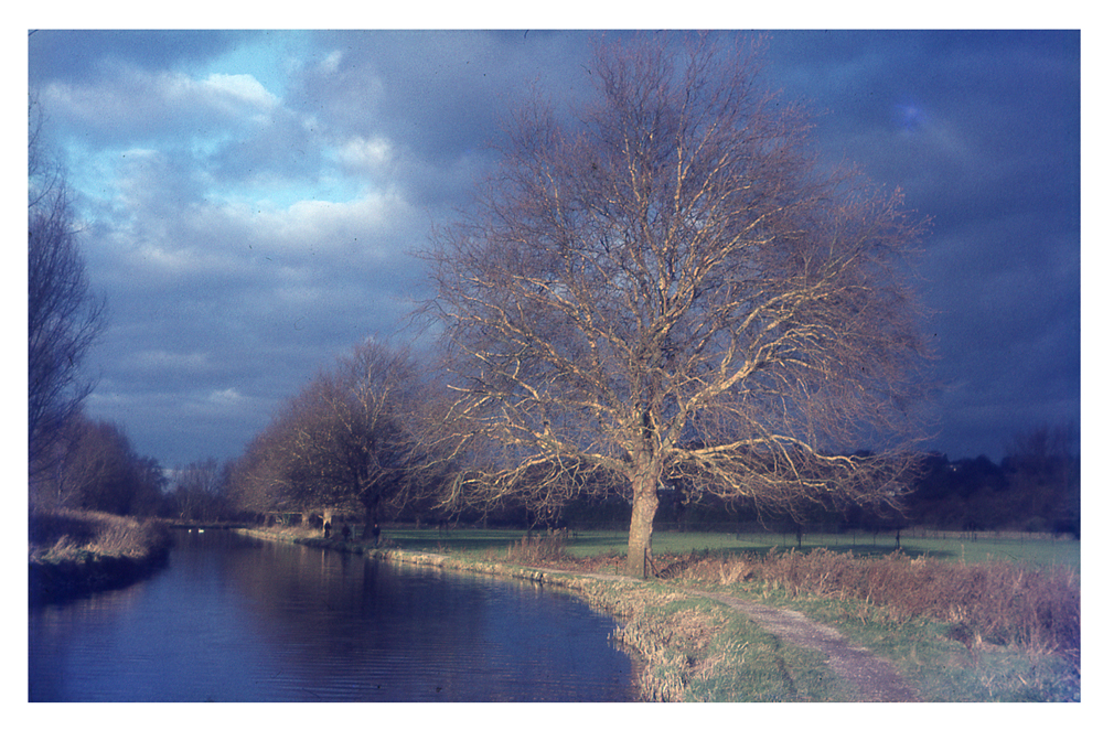

In my opinion, Kodachrome was the best colour film ever.

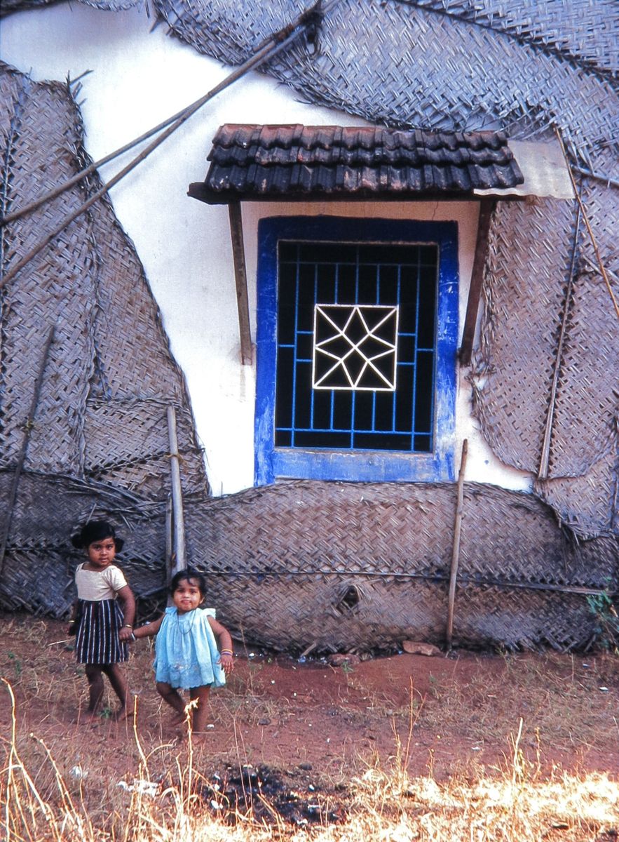

And yes, I miss Kodachrome! The colours and the resolution are outstanding!
Goa, India, 1990.
Rollei 35 LED.
Kodachrome 25.

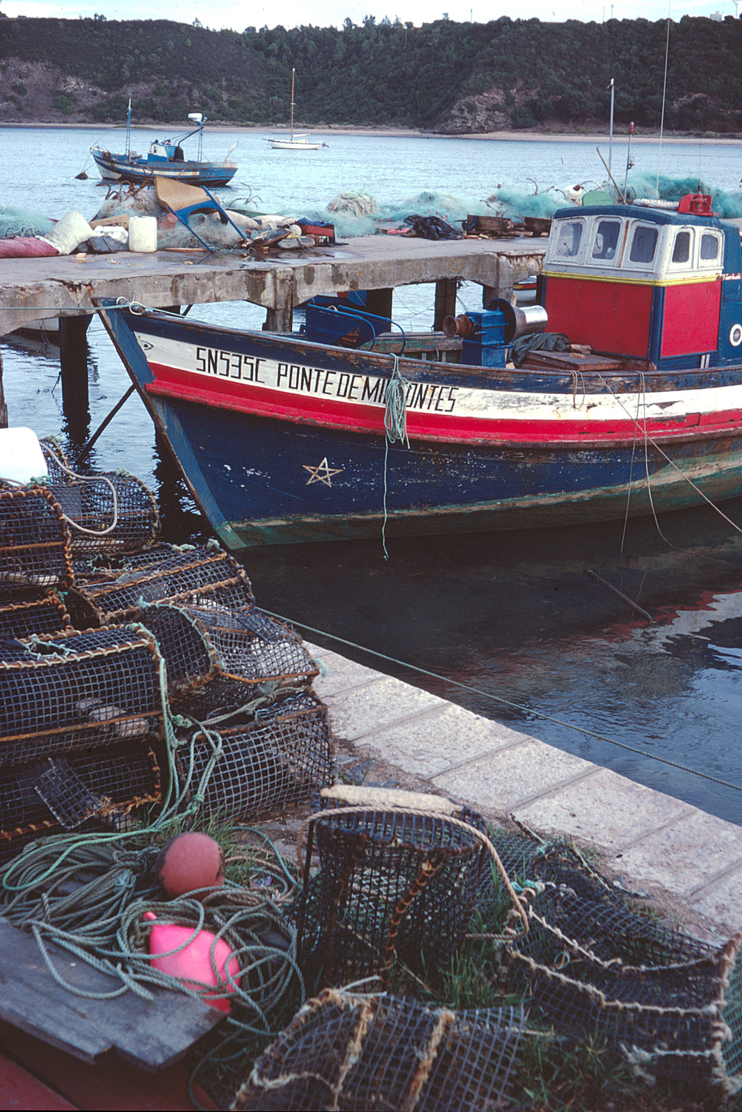

Canon Powershot s110 from light table
Portugal 1987.
Rollei 35 LED
Kodachrome 64
Plustek Opticfilm 7300

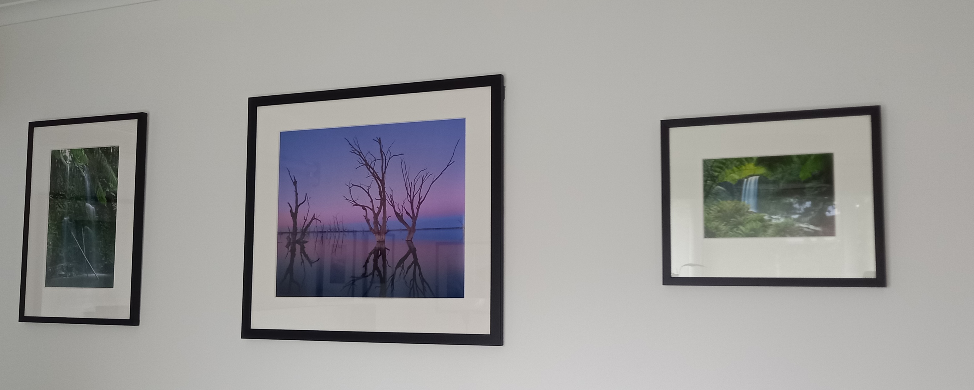

I get amazing inkjet (Canon) prints from a cheap printer. Original Kodachrome ASA 10 of my father's and modern Fujichrome and current Ektachrome. I was a Cibachrome/Ilfochrome printer in my day. I see 4 Cibachrome prints I made, hanging, from where I'm lounging right now. Beautiful 😍

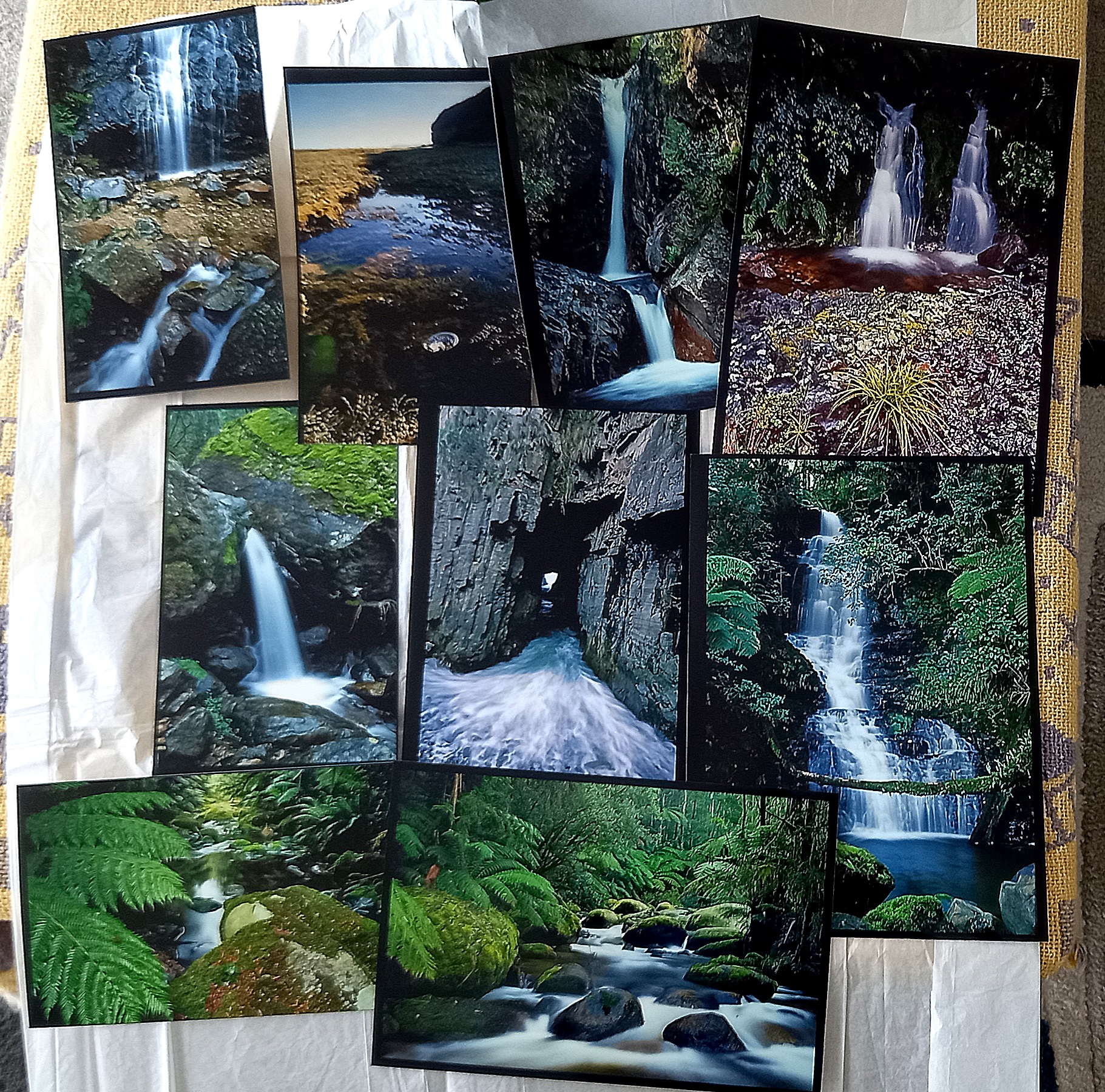

Pic of the Real McCoys in lounge... 400+ IC prints in dry storage in second house, raw or matted. I carry a few small IC raw (printer's proofs) prints around if I am using the 35mm kit, the format I doggedly adhered to before the jump to medium format. People are astounded such printing could even have existed, though a few get a ring of familiarity if the older term 'Cibachrome' is mentioned in conversation.
