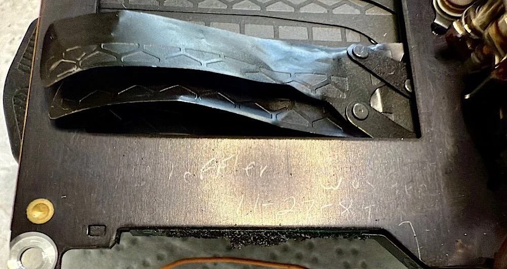

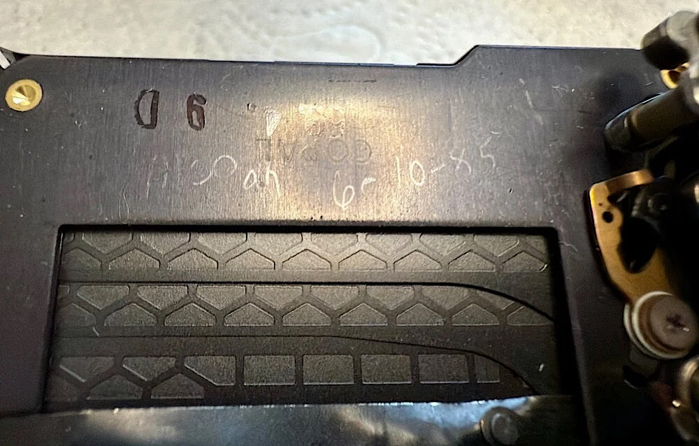

Here’s one from a Nikon FA:

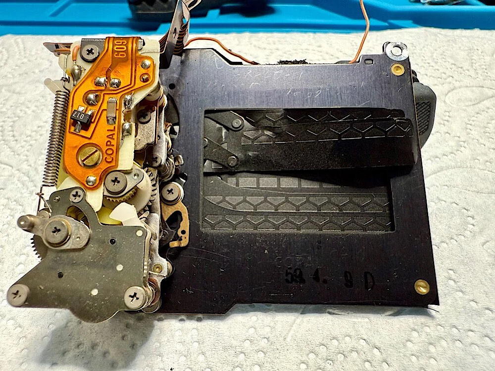

The vertical focal plane shutter from Copal.
A close-up of the damaged honeycomb titanium blades of the upper shutter curtain.
A repairman had immortalized himself twice on the shutter cover with an inscription:
S. Leffler was here 11-21-84
Also on 6-10-85
I rule out the possibility that the camera technician is responsible for the shutter damage 😉
Apparently, back in the day, it was popular among shutter repair technicians to engrave dates or other cryptic identifiers into Wollensak Alphax and Betax shutters.
