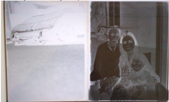

Raffay, Certainly no camera issue. It's a fine photograph and you need not make negatives any better than this!
I think density measurements, along with meter readings (you already gave), camera settings and development time...
There would be enough information (in terms of time/contrast) - to give you a point of reference that you can use going forward.

What could have gone wrong here, beats me.
The first negative on the left I shot sometime back and it is securely place in my folder. The one on the right I exposed last weekend, when i developed it I thought the negative had been scratched but when i scanned it this negative had double exposure of the briefcase picture, How is this possible?
But I am very happy with the exposure and development of the one on the right, am i rightly happy Bill?
excuse the quality of the picture posted, i snapped it with my blackberry off the monitor.
