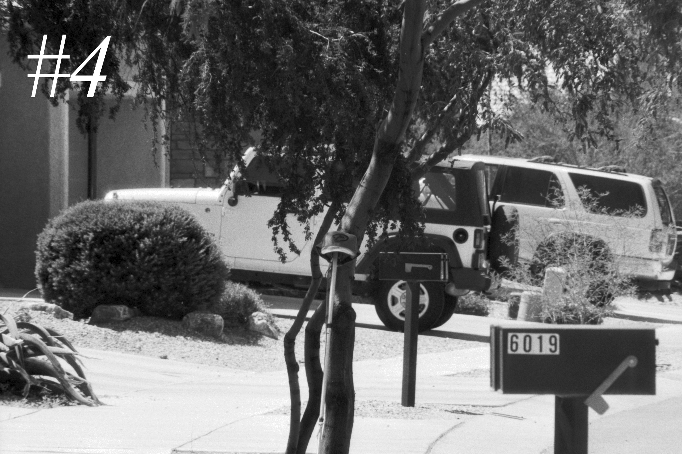

Friend gave me his old Canon AE-1 with several lenses.. but since I like my Nikon F2 the best.. the only lens that I have used with this camera is the 400mm. I yet to get a photo I like, but have to confess, I'm taking long distance landscape shots, and there could be some haze. So decided to check the camera out.

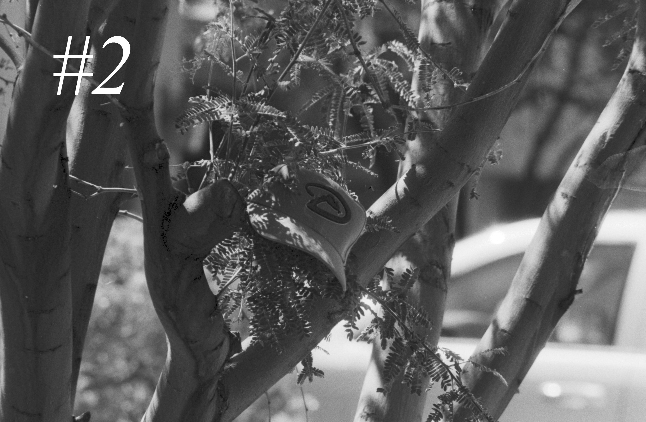

Decided to test the lens on a heavy duty tripod, attached with cable release, no filter and took a series of eight shots.. Focusing from near to far..

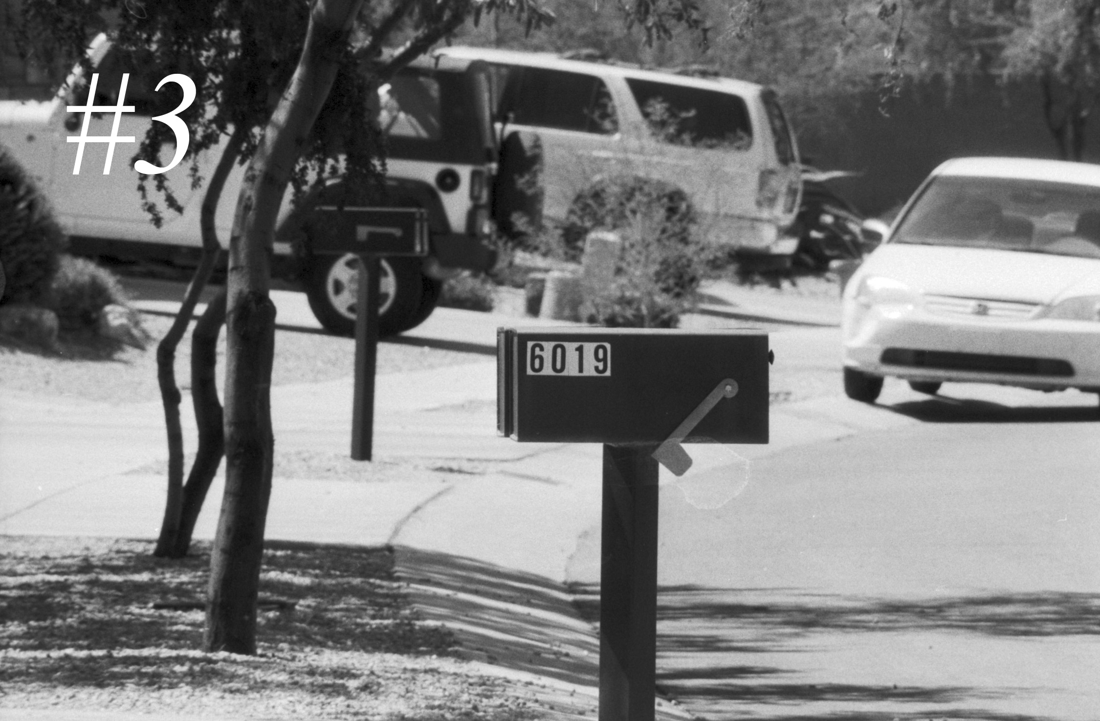

There is quite a difference between the focus of three and four.. On three the focus is on the mail box, on four the tree behind and you can just see the hat on top of the mono pod, leaning against the tree. The mail box looks more in focus.

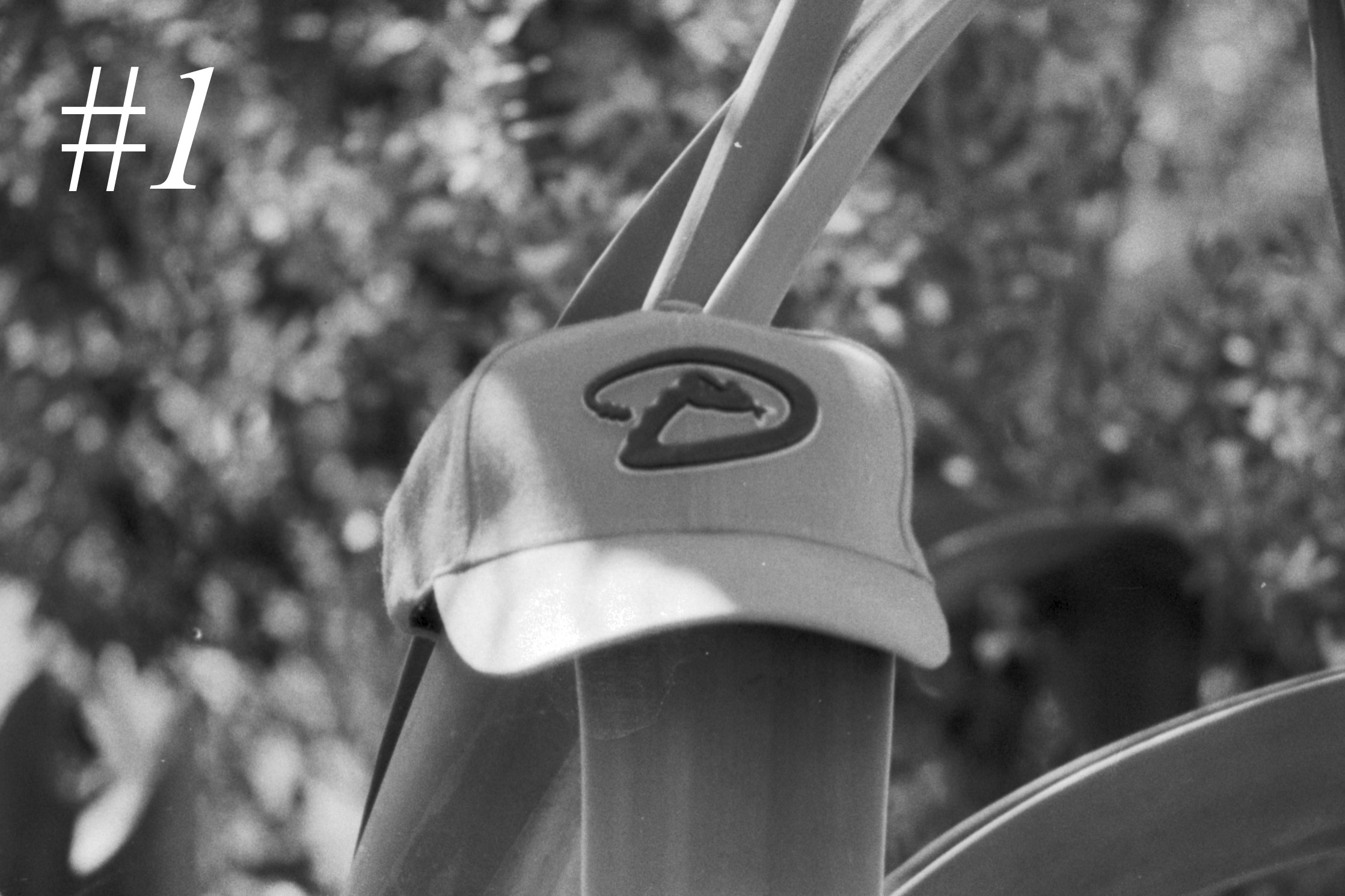

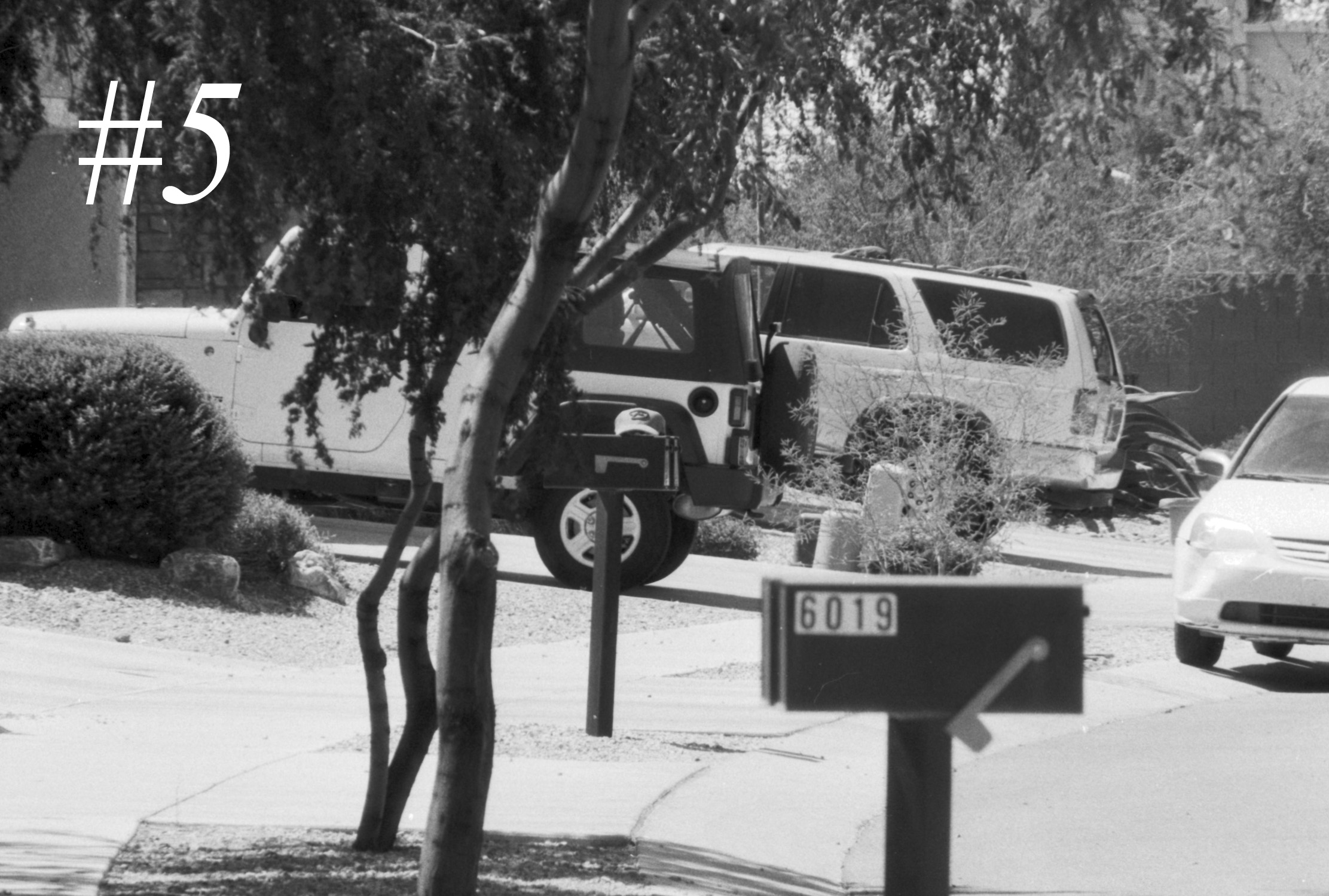

On fifth shot, the focus was on the mail box with the hat on it.

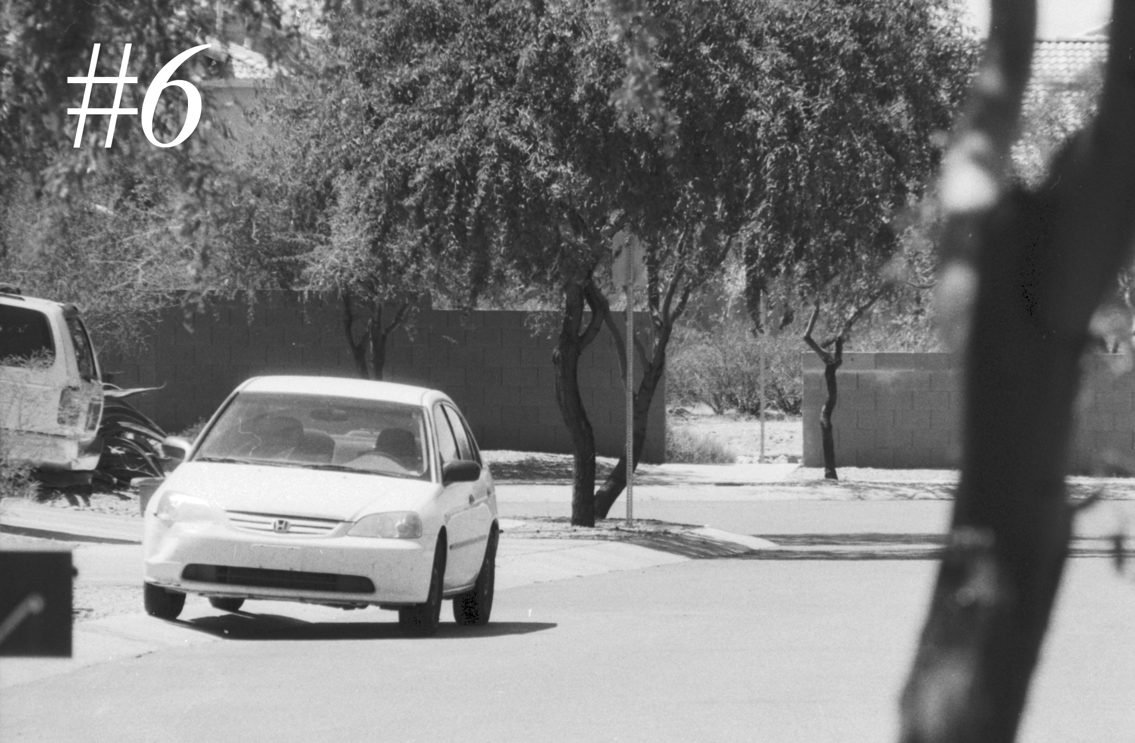

On sixth shot focus is on pole next to the two trees in center of photo

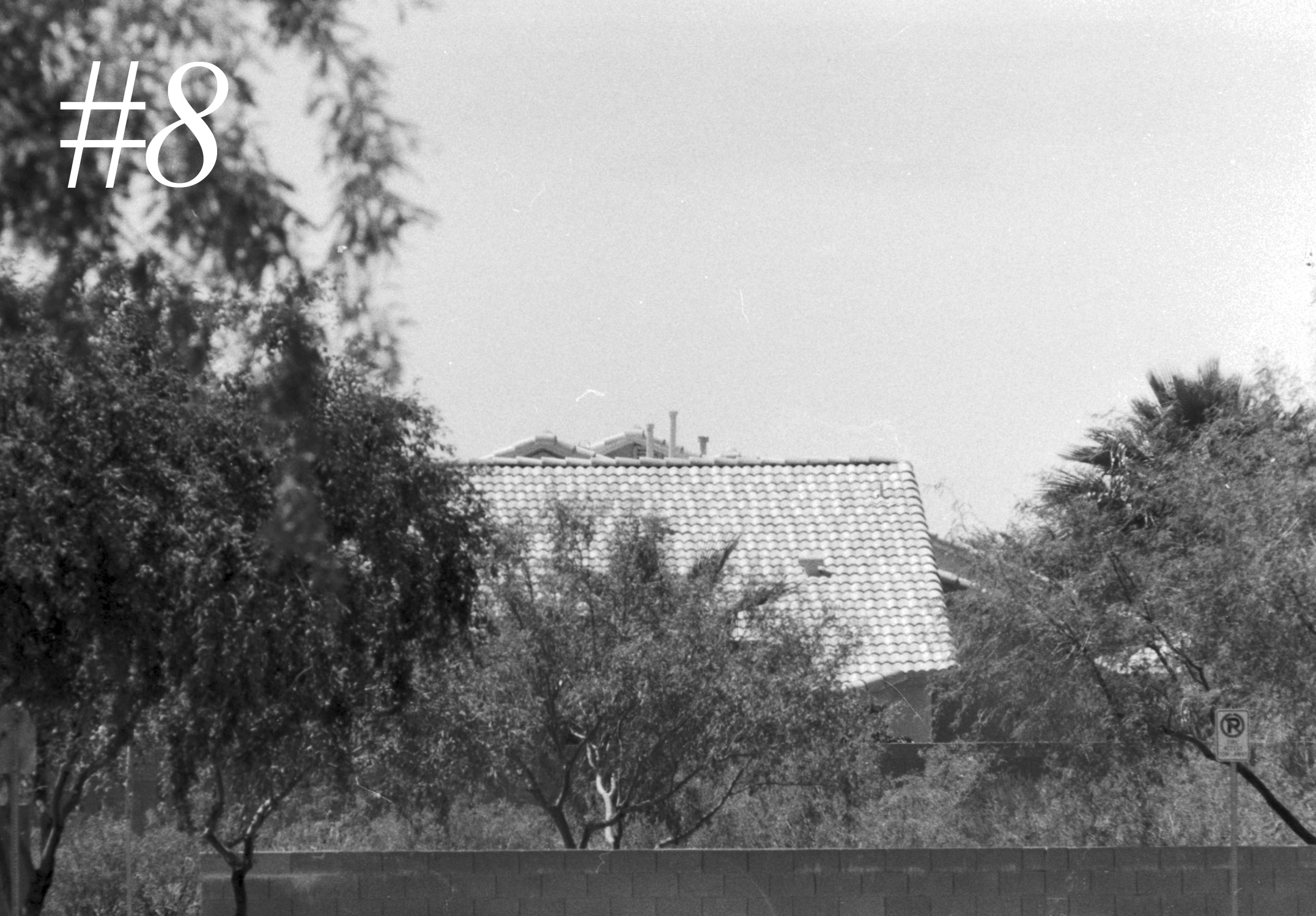

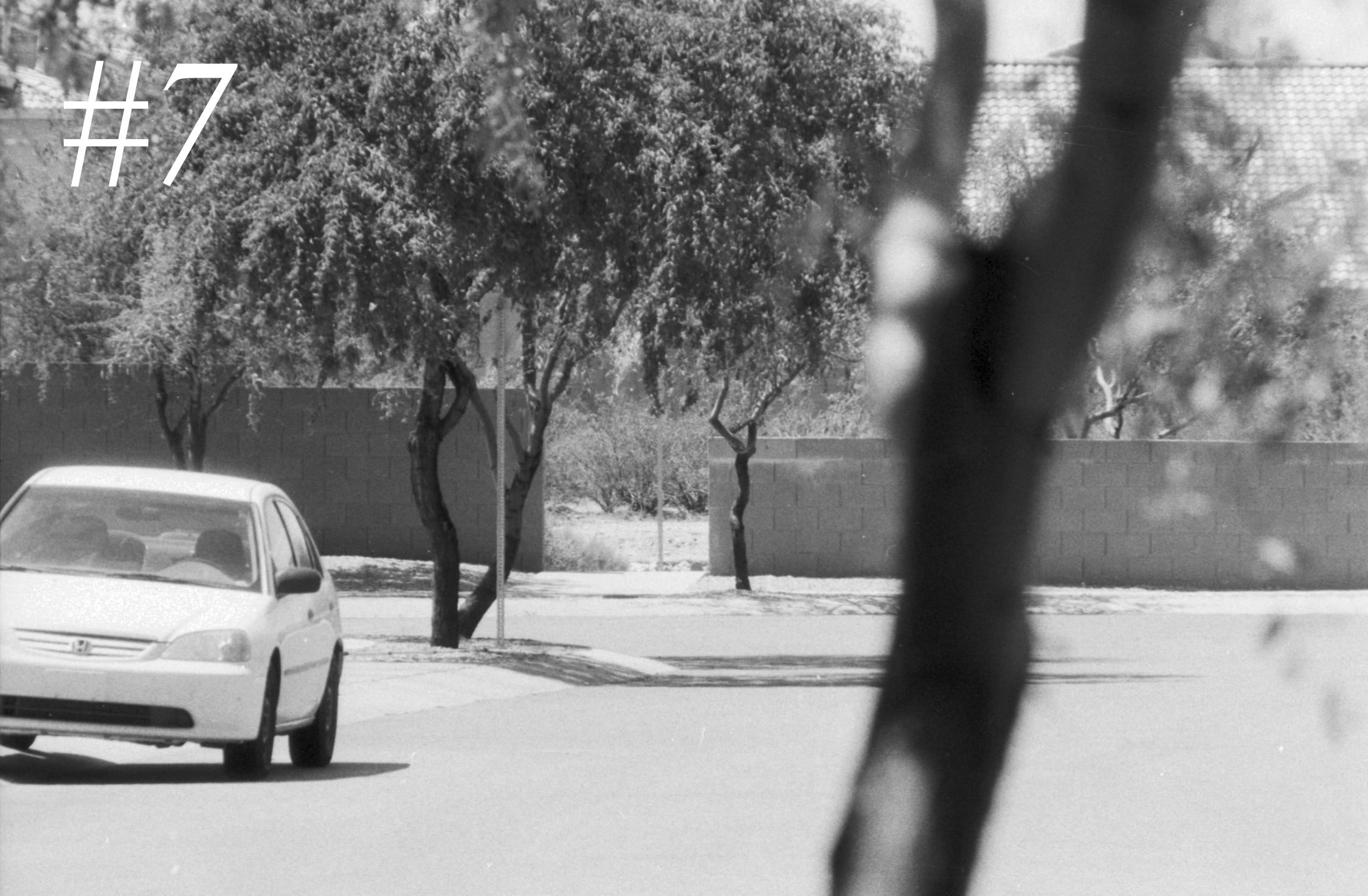

On the seventh focus is on edge of the back cider block wall opening

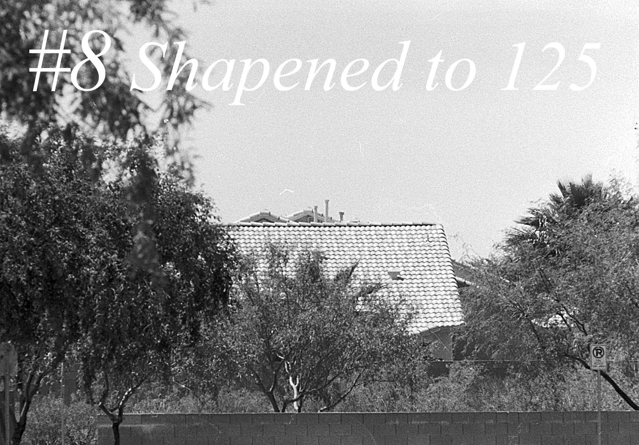

On eight focus is on the roof vents.
Am I expecting to much, and this is normal for such a long lens?
No sharpening done on the pictures, except #8 ..scanned at 1600, equals about a 4x6

  • #2.1 refArista400@1600 Neg16-8bNFHP5400 Auto 248.0 PicSet 20.0 +ME copy.jpg

  • #7.1 ref Arista400@1600 Neg16-8bNFHP5400 Auto 254.0 PicSet 4.0 +ME copy.jpg
  • #8.1 refArista400@1600 Neg16-8bNFHP5400 Auto 253.0 PicSet 1.0 +ME copy.jpg

This is not normal, it is not correct, and with such a long lens the motion it allows will kill image quality.
What apertures did you shoot at? Which film did you use? Is your F2's ground glass in correctly? Which tripod did you use?
After you've solved your stability problem, do a systematic test. Find a nice brick wall, set up so you're at least 100 feet from it and with the lens oriented at 45 degrees to the wall. Mark the line of best focus on the wall, I'd use masking tape. Take a series of shots at f/5.6, f/8, ... , smallest aperture. After the film is processed, check that the line of best focus is where you thought and see how the sharpness at and around the line of best focus changes with aperture. Do not scan for this last step, use a magnifier. 10x should be enough.
