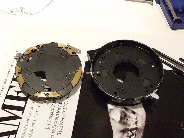

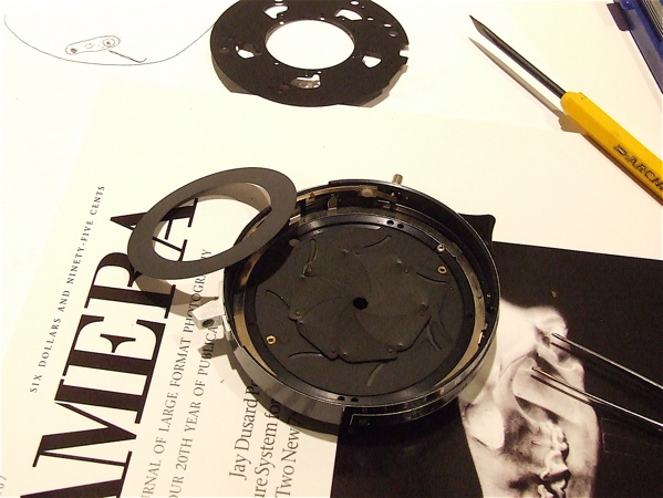

I had a 210mm Symmar-S in a Copal. An aperture blade had jumped its track because some clown put too long of an index screw in the hole. To get to the aperture the shutter blades have to come off. I took these pictures at the time; they may be of help to you.
