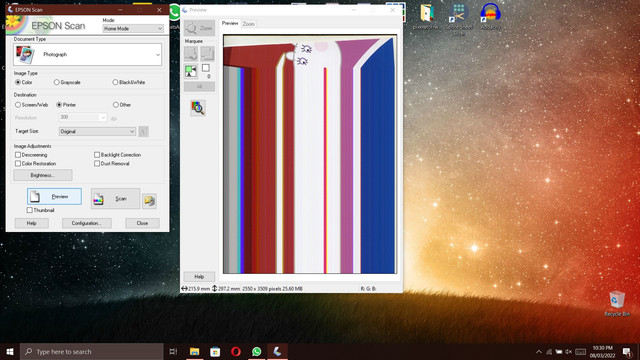

Hi everyone. My dad recently gave me his Epson v200 perfection scanner which worked perfectly two days ago. I went to use it today only to notice lines over my scanned images, also every now and then the scanner carriage will stop randomly and make a high pitched noise before returning to the start. I'm trying to back up some of my dads slides to digital format.
Now, I have done a little googling and cleaned my glass change out the usb cable and ports on laptop. the only thing i cant change or check is the power supply. iv tired the scanner on my dads pc, my laptop and my wifes laptop with all giving me the same results. Oh, i also reinstalled the epson drivers too. and tried linux.
Any help on this matter would be greatly appreciated.

3, Nope. Documents, photos, even a clean sheet of paper has all the lines on.
Ill post some scans off white, grey and black card it may help. would higher dpi help with the diagnosis?

I did notice that if I use VueScan it scans all the time albeit with the lines. But if I use Epson scan the preview always freezes and smudges the scan.
