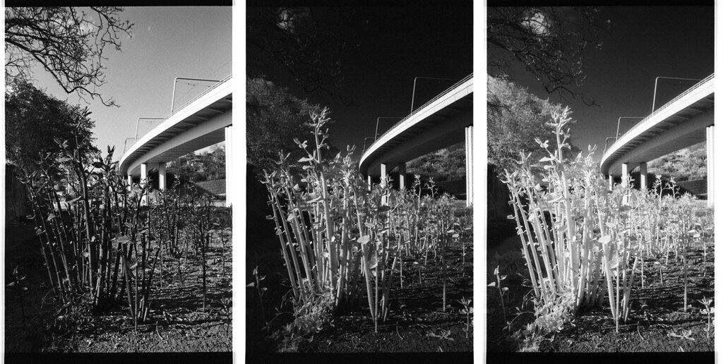

That's great, Alec. Is the middle image with the R72 and a higher EI? The last one really looks like Rollei IR.
Yes, the one in the middle is EI6, EI400 without filter on the left (all TTL measured with Canon 50). This was developed for box speed, with extended development the one in the middle will look better. Actually I tested Fomapan 400 with R72 from EI25 to EI1,5 and got the Wood effect at all speeds, the difference was in the amount of shadow detail.
