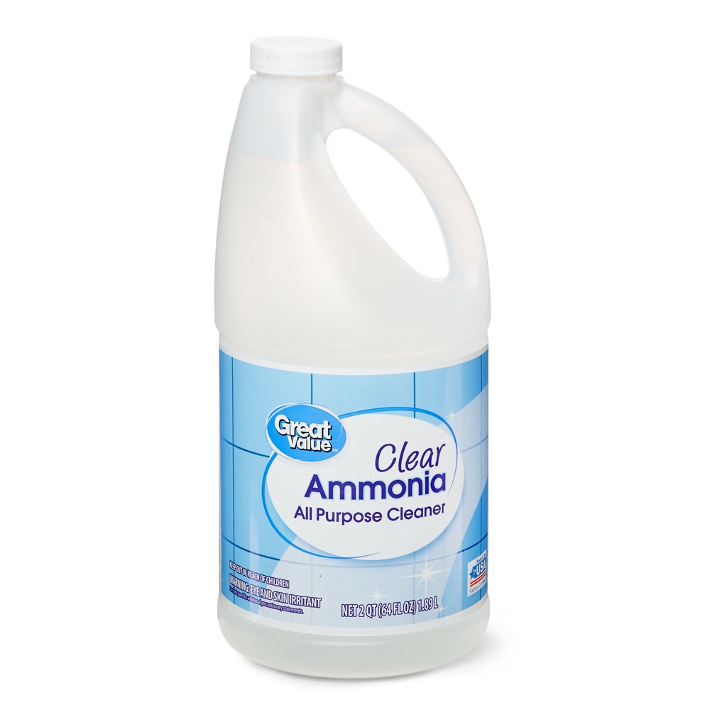

Walmart, Menards, other markets still sell "household ammonia" . My Mom would mix up her own, window washing, and general cleaner, I can still smell that stuff. Household Ammonia is a dilute solution of the powerful dangerous lab and industrial chemical, Ammonium hydroxide. This is seriously dangerous stuff..
Here's what Walmart has
I ran out of it when I was making kallitype fixer. I've used this fixer (25g sodium thiosulfate Anhyrdrous; 50ml ammonia) for many years. No one has it anymore as it's illegal to sell here, according to the store clerk. Oh well.... I mixed up one that I used to use (Sandy King's) and it'll do. I just appreciated the convenience of the ammonia based rapid fix, and its one minute fixing time. What are others using to fix their kallitypes?

This is an example of the plain old household ammonia that we have been talking about. It is "pure" only in the sense that it contains no detergent. It is, in reality, a solution of ammonium hydroxide that is sold as a consumer product which is commonly, but chemically incorrectly, called "ammonia ".
You will not find pure (in the chemical sense) ammonia in a plastic bottle anywhere. Pure ammonia is a gas. It comes in steel cylinders under high pressure. It is quite toxic.
