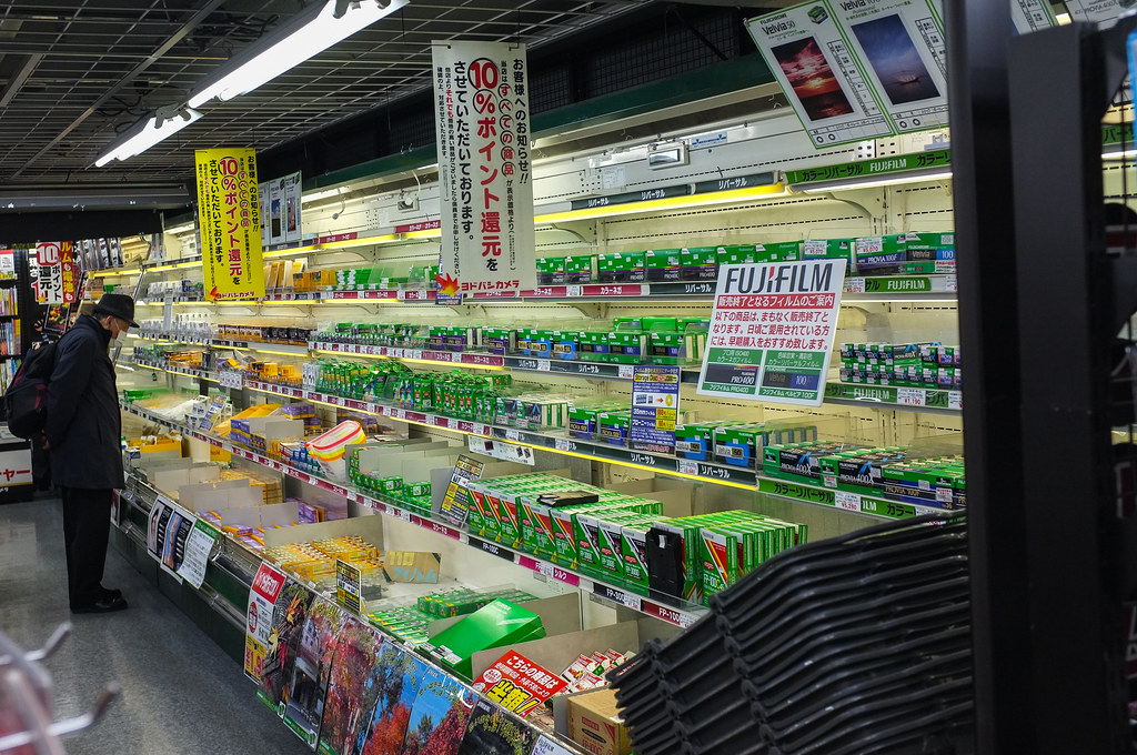

I do not believe this film has been discontinued... could someone show an official notice of this from Fuji.
Where is the redesigned box? Where is the stock of film? I was all over Tokyo stopping in stores looking for this film and found none.
If you cant find the film, doesnt that tell you that it is no longer made?

Well done. You found some old stock. This film is gone as many vendors have told me. I was in Tokyo's largest film store and if they can't get any. Again, 160NS has NOT had the new packaging design. That's clear as day that the film is gone.
There was no 160NS in this store.
I was there 3 days ago and they still had some in 220 I think. And if Yodobashi Shinjuku can't get it, no one in Japan can get it.
They also didn't have Portra 400 in 120 while I was there for 3 weeks. I think Kodak has really bad supply of film to Japan at the moment.
Also some film boxes have white sticker with red writing on them, they are discontinuation notices. as far as I can tell. Buy now or never again.

Well done, you found a camera store in Tokyo.
I buy my film from the Fuji warehouse in Mississauga, I have an account with them , I will take up the issue you present that I am buying old stock.

Not sure if you are sarcastic, but can you buy Velvia 10x8 in Miss....? Since that store in Tokyo has a stack of it as seen in the photo.
160ns was discontinued in all formats.
