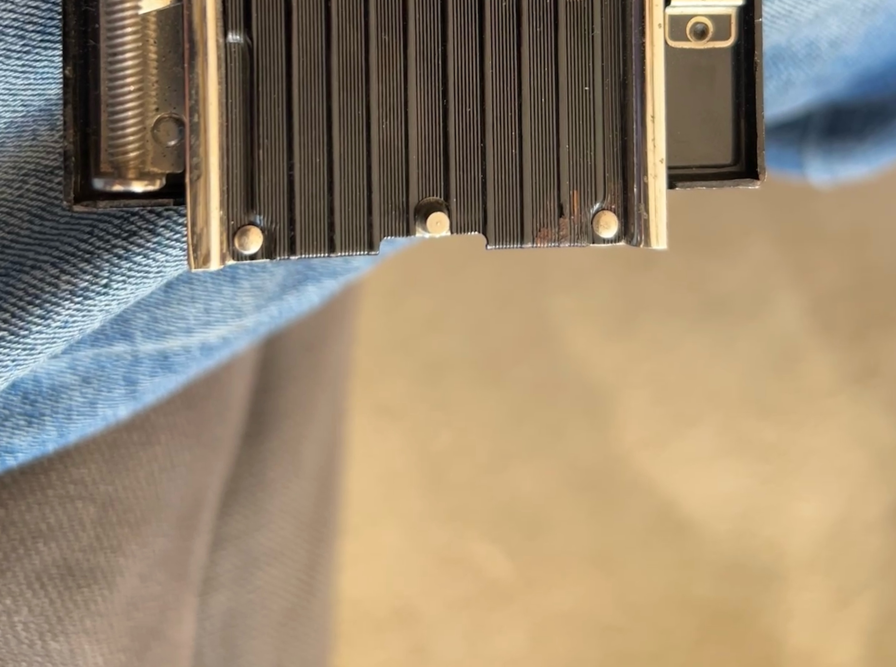

Hi all, I know this thread is perhaps old, but I reckon for a camera that’s approaching 100, there may still be some life in it.
I was wondering if anyone has had the issue I’m having, which is that the ‘bed’ or track that the shutter slides on…that track has moved. And the shutter assembly now no longer slides along the track, the bellows doesn’t extend either.
I’ve tried jiggling it in all directions but no luck so far….and there are almost no screws I can see; everything is riveted, so any more intrusive repair work will be destructive first.
Am I missing something I should be trying?
Thanks in advance
Bruce
