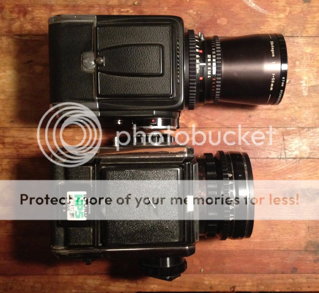

I'm going on memory here, but I think the Bronica S2 body is larger than 500-series Hasselblad but the lens is smaller. Without side by side comparison, I'd assume about the same overall size.
If the Bronica shutter is reliable, you should be very happy with that kit.
The Bronica is 1 1/4 shorter, but at least that much wider. The Bronica winding knob is quite big. I just placed then side by each to check.
Hi Frank, thanks for the comparison photo. Any comments on how the two lenses compare?
Hello Pete. I acquired both 50mm lenses just last year and a hip operation has interfered with me using them, so I can't say. I'm extrapolating from using the normal lenses from both systems: if you are a stickler for technical perfection (and cost is no consideration), Hasselblad would have an edge, but those results sometimes feel a bit cold and clinical compared to Bronca's Nikkors. We don't live far from each other so if you wanted, we could arrange to meet and I'll bring both cameras with their 50's.
