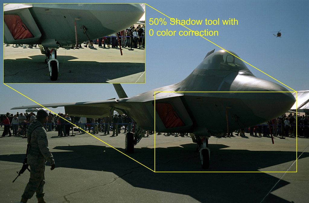

As I understand it, the 'shadows' and 'highlight' tools in nikonscan are basically just like slider in other photo editors, and it's applied after the scan
Interstingly I've noticed that Nikonscan can see in the deep dark shadows. For instance in this very high contrast shot using contrasty Kodak Ektar 100 with the shiny subject under an overhead sun, I can easily bring out shadow details that I would have thought lost just using the shadows tool. Notice no added "noise" or exaggerated grain either. I suppose I could have dialed analog gain another percentage or so to fully capture all the blownout highlights but I thought it would look less natural.
Untitled by Les DMess, on Flickr
I definitely prefer to scan with minimal adjustments and prefer to do that in post as the tools in Nikonscan are not as "selective". For instance using Nikonscan's GEM - grain reduction, is not as precise/selective and I usually leave that process as a final step if needed for the final output.

For example, on the image of the plane you posted, the reflection of the sun on the nose and the wing in the right part of the frame is blown and contains no information. Try setting your white point in vuescan to .1 or even .01, and see if there's anything left over that nikon is missing. i think there may be something.
