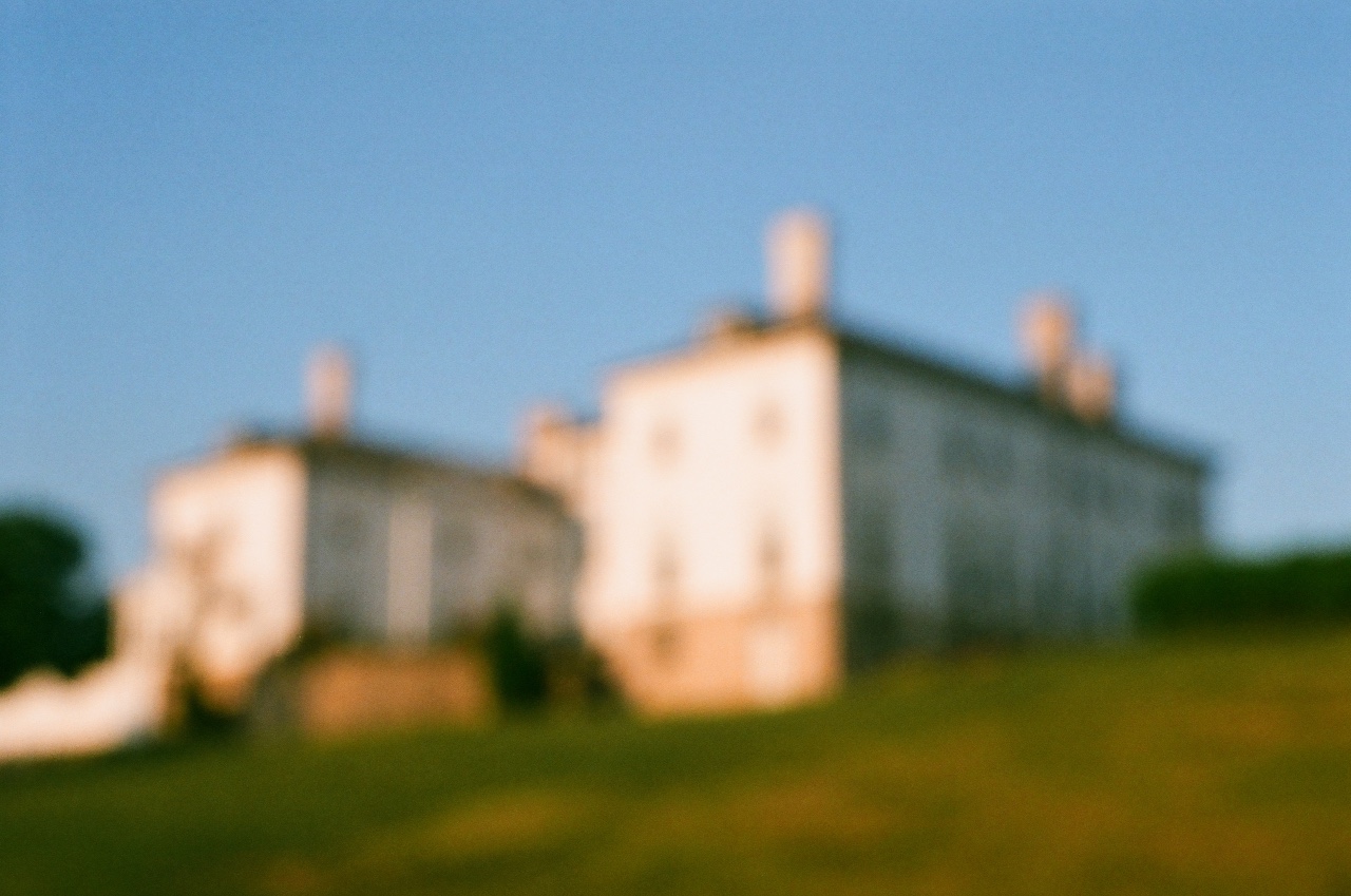

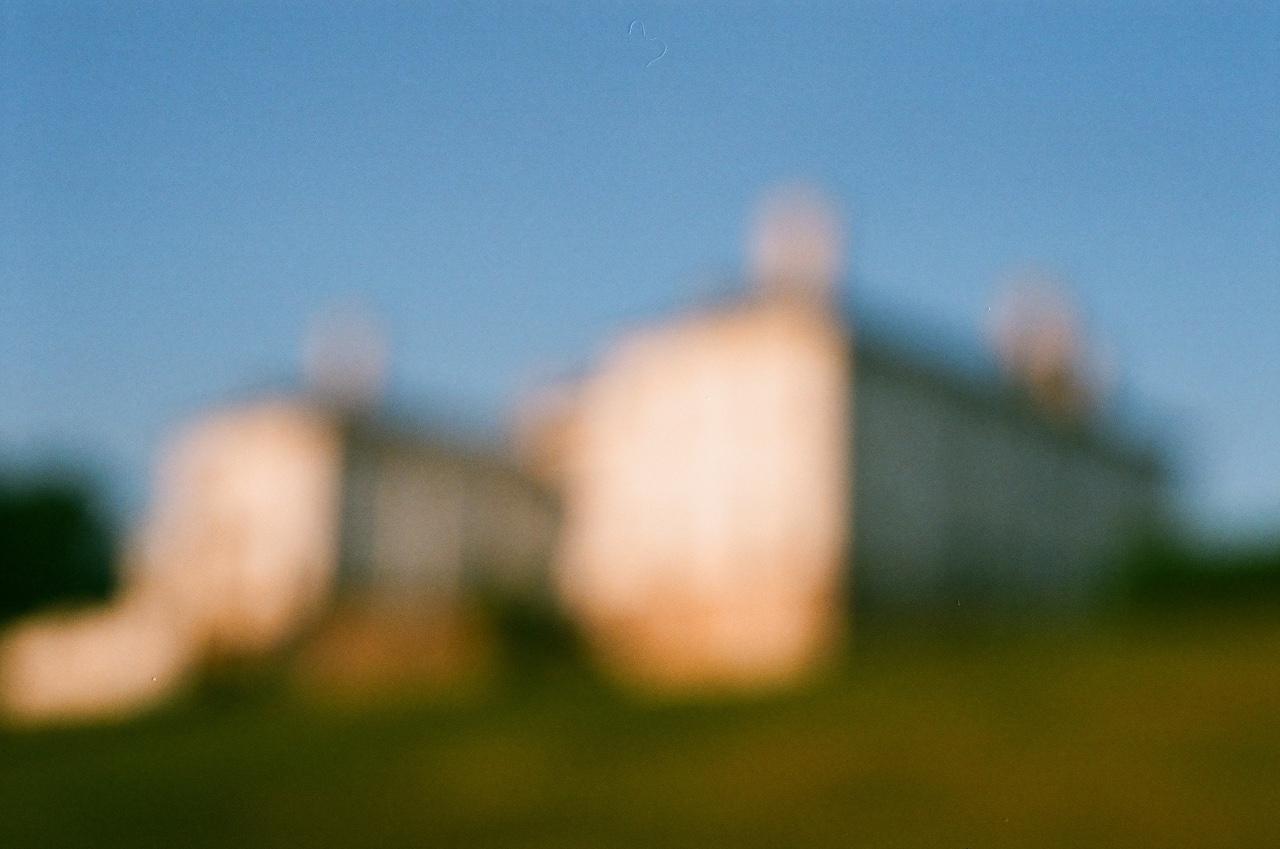

Uploading an example of one of the *best* images that came out of the last roll 🥲
The focus should be better than that. Did you set the focus to cover the depth of field range for the f/stop you choose?
I think so. I didn't take this one but I watched. There are two subsequently even blurrier ones of the same scene as different variations were tried that all should have covered the correct distance at the corresponding aperture.
Forget zone focusing. You're complicating things. Just set the focus point to the distance you want in focus to test it first. For the samples you're posting, it seems like they're at infinity. Once everything has been checked out, then you can use zone focusing.
Forget zone focusing. You're onplcating things. Just set the focus point to the distance you want in focus. For the samples you're posting, it seems like they're at infinity.
We have a few in which we know were set to infinity (mountains in the distance) and those are blurrier than these. I'm really starting to think something is up with the lens.

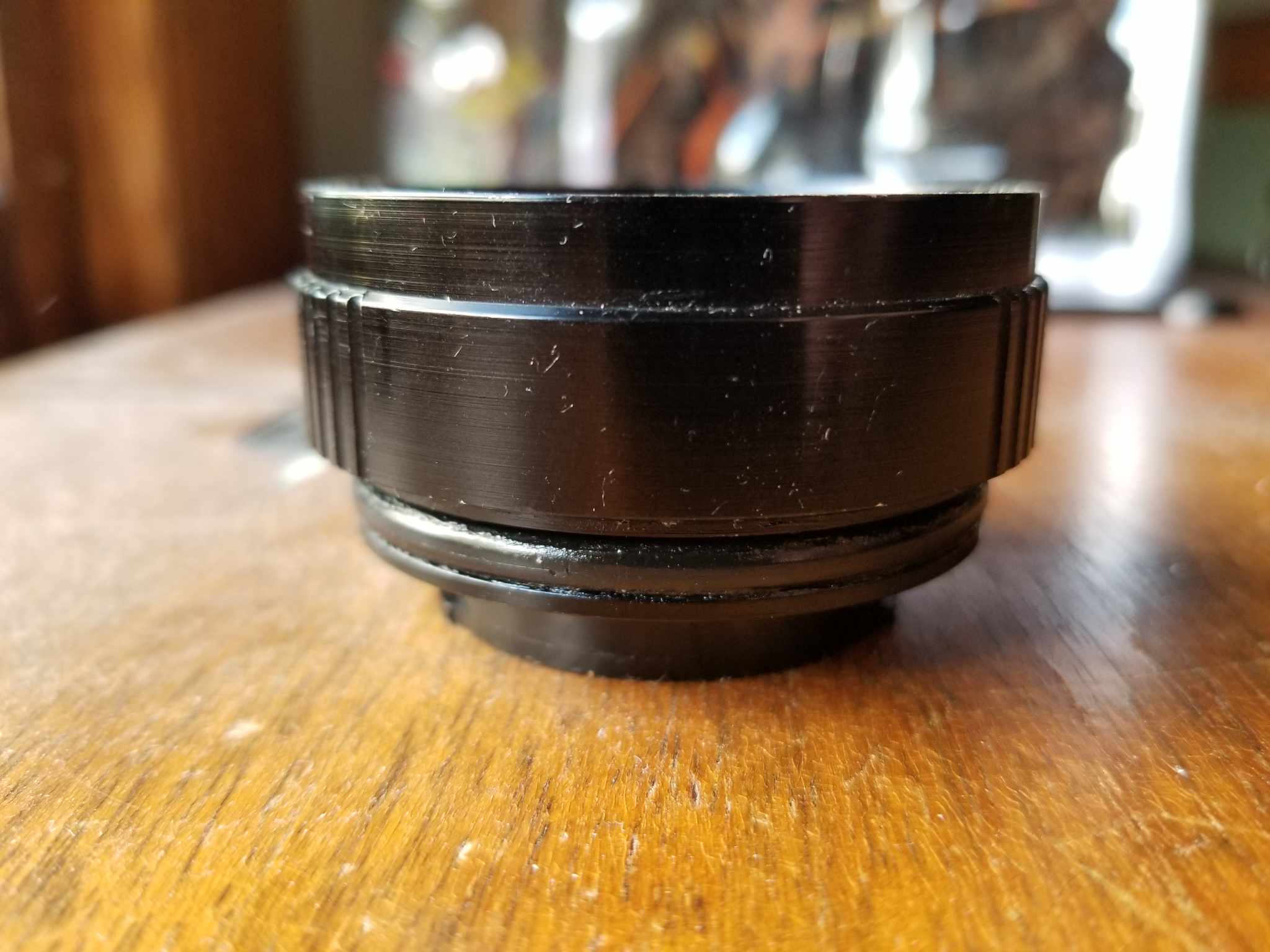

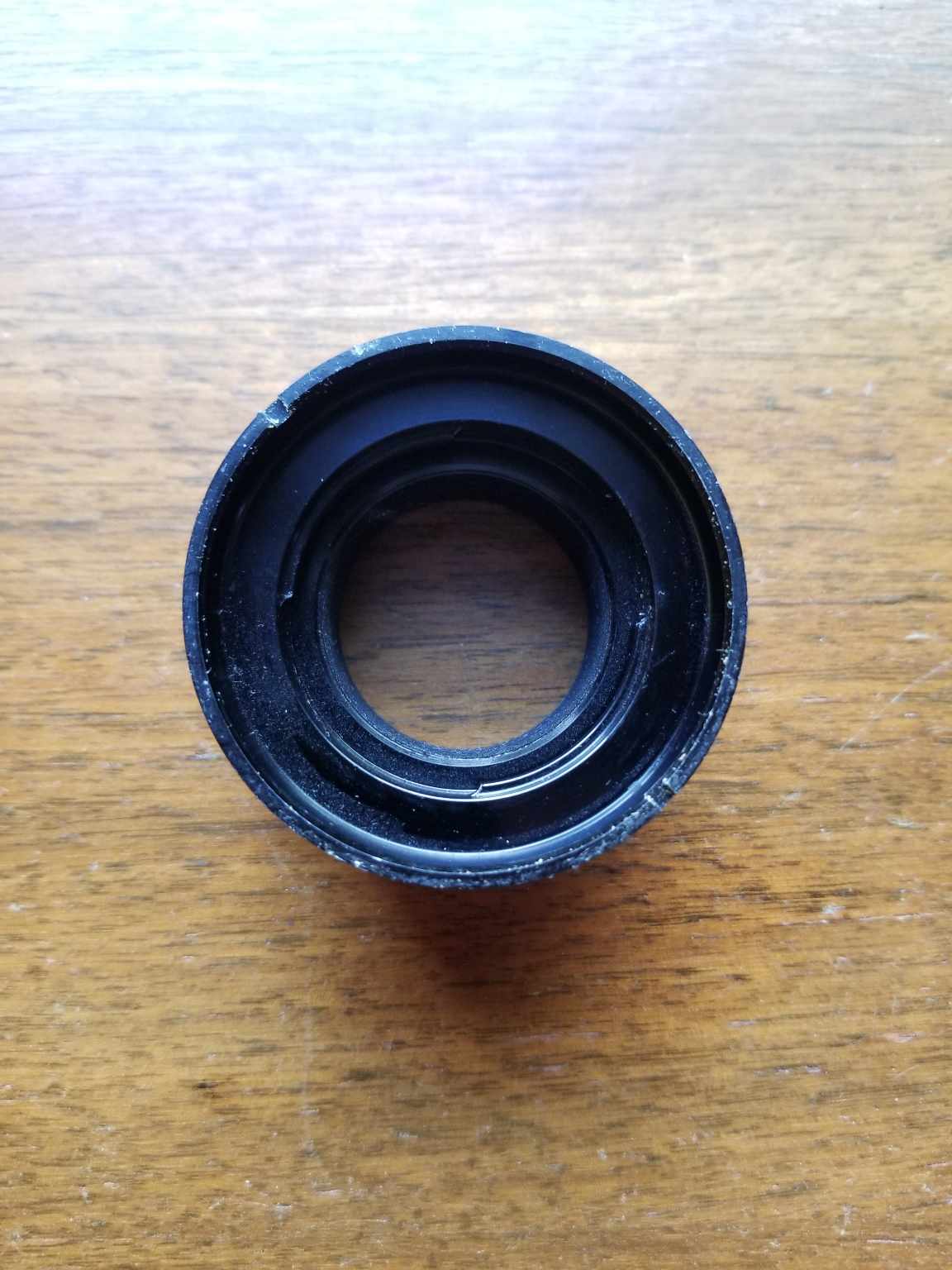

I THINK I FIGURED IT OUT!
I was looking at pictures of the same lens for sale and I realized the back looks nothing like the one I have. I think there's an extension tube stuck on it. I feel so dumb now, but I didn't even know they made them for this. Now I just have to figure out how to get it off without breaking anything.
Edited: Confirmed. Got the tube off. 🙄
Forget using the depth of field! One might as well save the expense of using film with that attitude!
I've never heard of an extension tube for a Nikonos lens. But I haven't heard of everything. Can you post a picture of it?

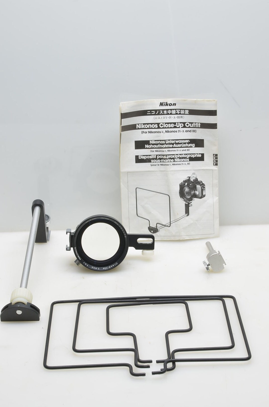

Your issue reminded me that I have set of macro closeup focusing set for my Nikonos IVa. The three come with a set of three range viewfinders where you put the subjects in to line up the shot.
