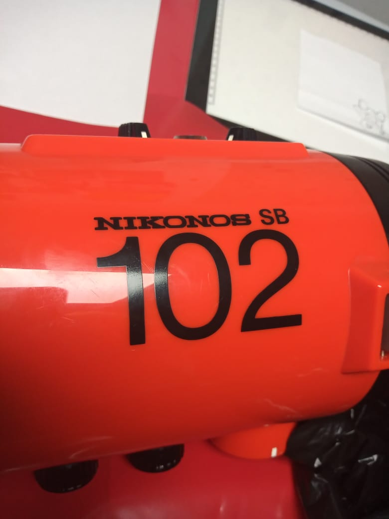

... so recently I got an almost complete set of Nikonos V with extension tubes, lenses and a B102 Speedlight. The seller told me that he didn´t use the flash before so I have to test by my own. The thing is I never tried any analog flash before and OTOH I don´t have a lot of expectations about this old guy so I was wondering if anybody here have tried to use a generic flash with their nikonos. Can I adapt any old studio flash with my Nikonos ? I have to say that I´m not planning to use it into the water, my main idea is shooting some macro photography at home or in the forest. Thanks in advance for your replies.
Aug 29, 2017
9,885
New Jersey formerly NYC
Algo después
Oct 26, 2020
241
Ecuador- Argentina
It seems to work with the SB-102 speedlight. See pg 55. Are you sure he's selling a B-102 and not the SB-102?
...sorry, is the same one that you said: SB102

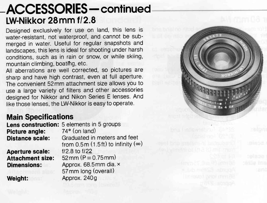

Obviously, that's not a Nikonos underwater lens. I'm assuming this lens works with a Nikonos camera. It fits the special mounting ring? Do you know if it works with the Nikonos IVa model?
Note that the 28mm U/W Nikonos lens cannot be used above water.
Sirius Glass
Jan 18, 2007
50,623
Southern California
All the Nikonos lenses are both upward and downward compatible with the various Nikonos bodies.

I'd suggest that a few good used ,B&W filters for the atmospheric photography 35 & 80 would be a more suitable investment, especially for b&w + pola. and ND with today's fast films.
Cheers
I checked and my 28mm, 35mm and 80mm are good for above and below the water. I have a set of black & white filter for them, but I only use polarized lenses on my slrs of several formats.
