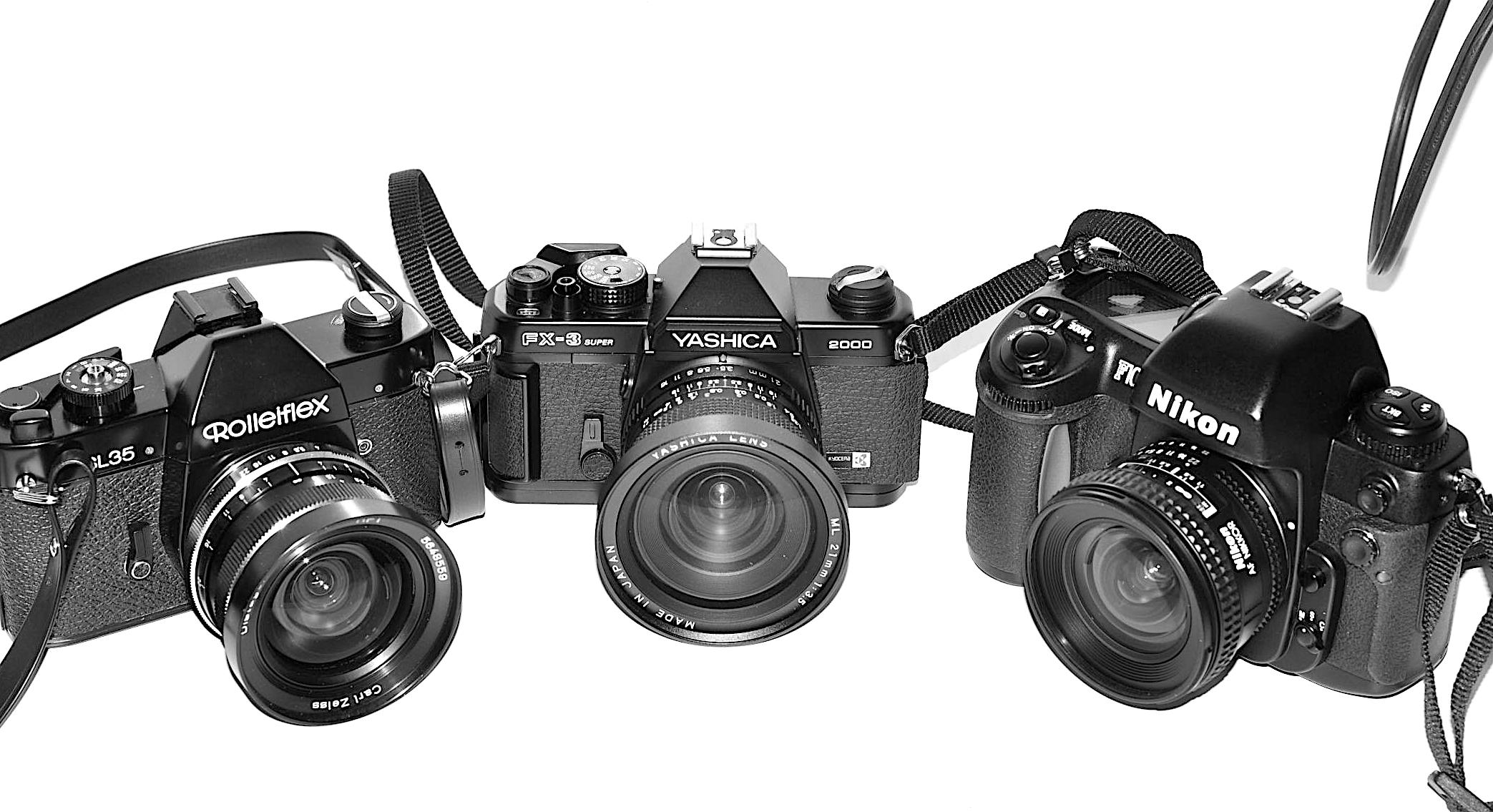

For me, these lenses are all give the same visual effect and I use these cameras interchangeably. 18mm Zeiss, 20mm Nikkor AF-D and 21mm Yashica ML.
