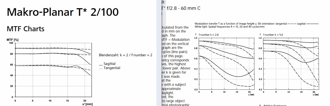

It is impressive to see the MTF of the modern 100/2 Makro-Planar compared to the classic, German-Made Makro-Planar 60/2.8.
I have the 60/2.8 and it is very sharp. But comparing the MTF of the two lenses (both tested with frequencies R = 10, 20 and 40 cycles/mm) the new lens seems to have come from a different planet.
The very nice fact is, that is not only when you compare the MTF of the new Zeiss lenses to older lenses, but when you compare photos side-by-side. The real photos totally confirm the MTF results.
At first I was a bit sceptical, but some years ago my brother started using the new Zeiss ZF glass, and was absolutely happy with the results. He told me "look by yourself", gave me his lens for my own testing. And I was positively shocked. I had not expected such a big difference in comparison to my older lenses. Since then I am building up my own Zeiss Milvus 'family'.

Thank you IC-Racer for posting "How to read MTF curves" article!
I can really highly recommend that article. The author, Dr. Hubert Nasse, was the leading physicist and scientist at Zeiss for optical / lens testing. An excellent expert, extremely well-respected / reputable in the optic and photo industry. And a very nice, friendly and helpful / supportive person.
I've known him personally: He was so kind and supportive to help me establishing my scientific, non-MTF based standardized film and lens test. He checked and approved my test procedures, and we exchanged and checked together our results. He also liked using film (Rolleiflex user) and slide projection.
Unfortunately he passed away some years ago. Much much too early. Really sad.
