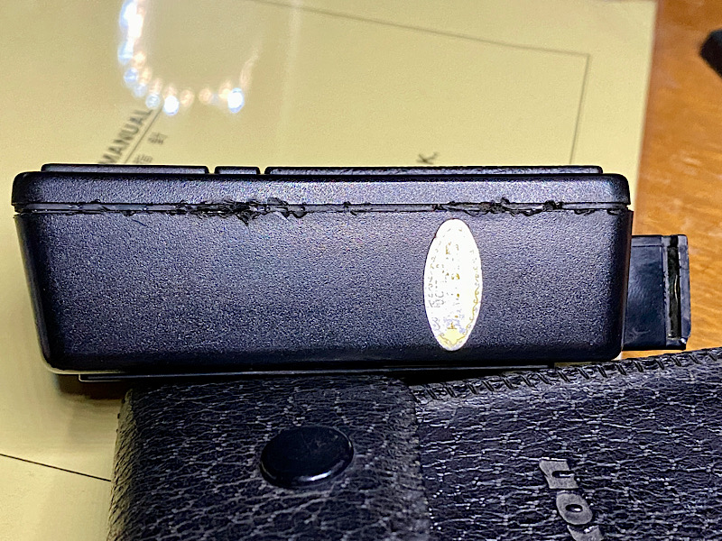

Opening the SB-E and looking inside it is also interesting because it has obviously been tampered with, as the pry marks on the casing show.
This means I will handle the flash even more carefully, as the previous intervention will no longer guarantee its operational safety.

I managed to open the case this way. However, this SB-E is no longer in its original condition and some of the plastic clips used to lock the case were broken off.

Broken plastic clip and lever marks.

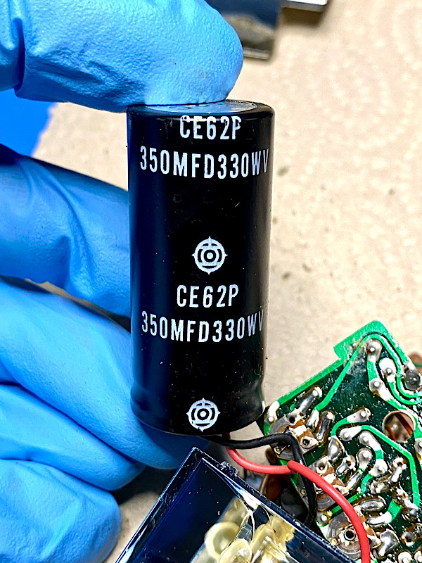

The flash capacitor (black) with red and black cables. When charged, high voltage is present at the two cable connections (but be careful, not only there).
Therefore, I measure the voltage here ...
… which is 0 volts as expected.
After such a long time, the capacitor has completely discharged.

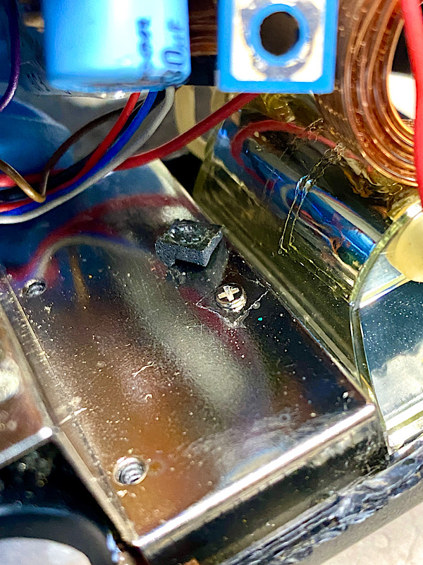

Two screws, one missing.

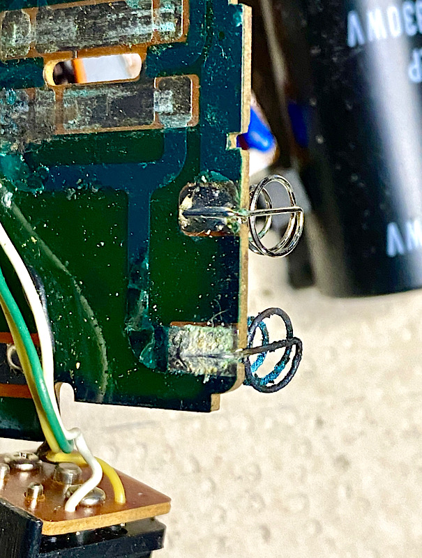

These contact springs located in the battery chamber are severely corroded.
In this condition, they can already break because the leaked battery electrolyte attacks metal.

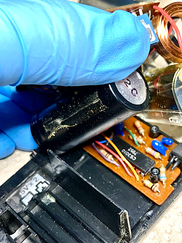

The flash capacitor is glued to its holder.
The electronics are detached from the front housing part.
Three trim potentiometers, accessible from the outside via the nameplate.
The component side of the smaller board with an IC.

The contact springs in the battery compartment are now accessible for cleaning. To do this, they can be desoldered from the main board.

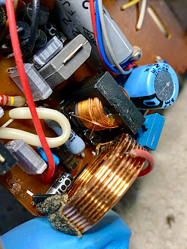

Power transistor and electrolytic capacitor.
Coil
Mitsubishi high speed switching thyristor CR3AMZ

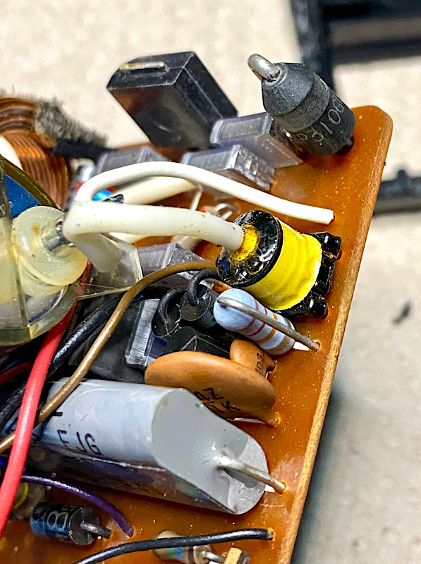

Yellow: one of two transformers.
According to the service manual, the gray component should be a 2.2 uF capacitor.
In the middle the second transformer.
Rotten foam

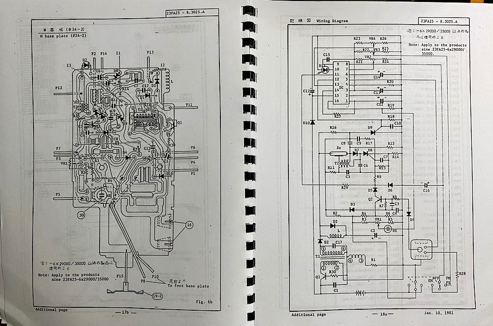

Layout and circuit diagram.
In the service manual there are two construction versions.
