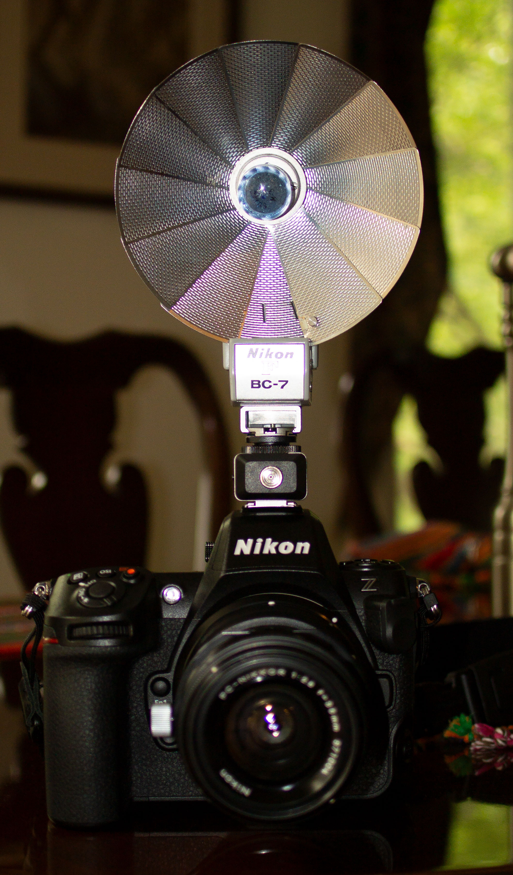

I have a couple of other "favorite" flashes. The first is the lowly SB-30. On my Nikon FA and it served as a popup flash. It has a built-in optical slave, so it can be used as a small kicker light. And it also has a built in IR panel to use as an optical trigger for monolights.
The second is a Nikon BC-7, just because. One of the first things I did when I bought my Z8 was to use them together.
