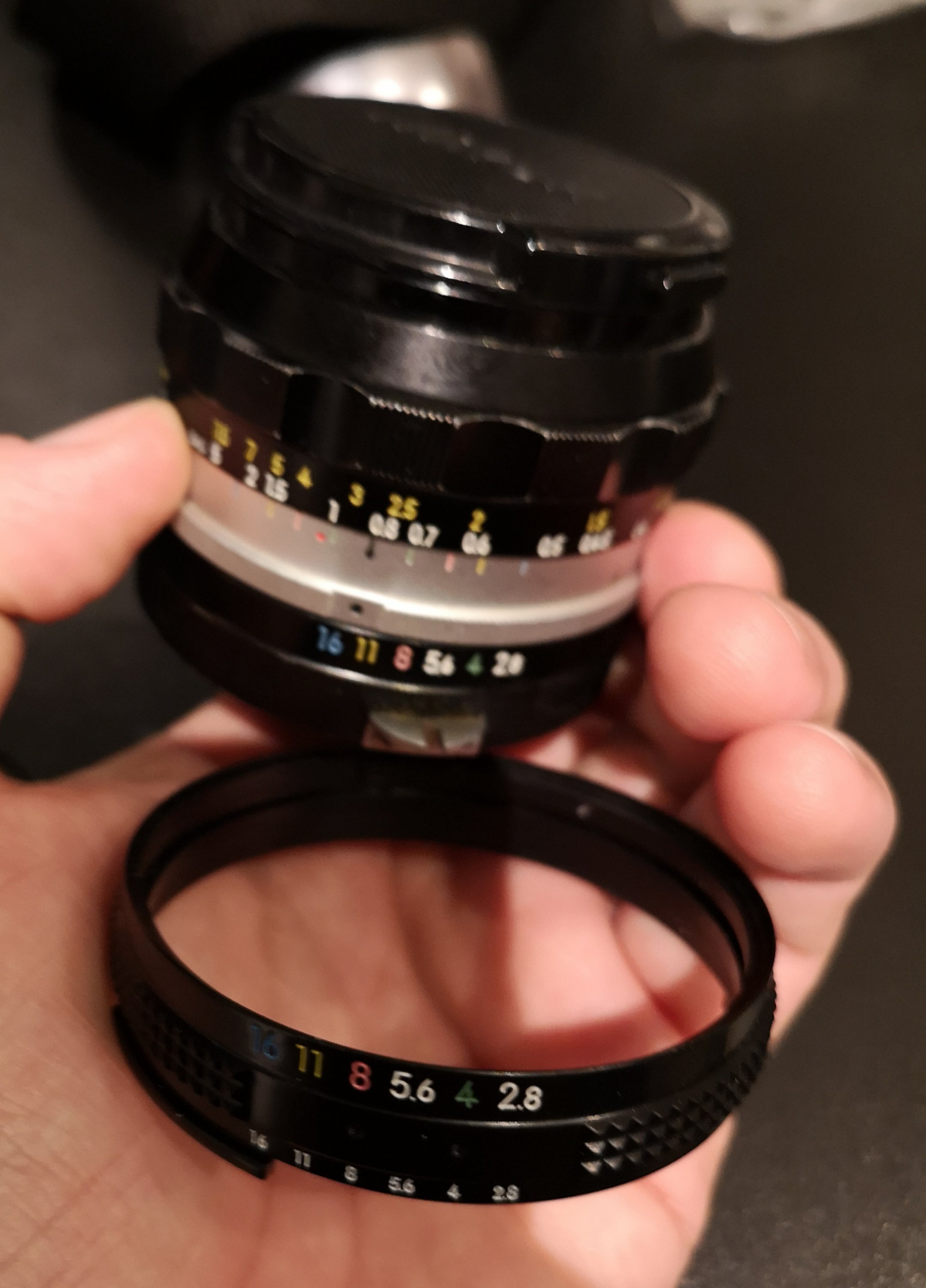

I just got a Nikon F2A off fleabay and will flip my regular F2 with the DP-1 finder. I do however want to keep some of the lenses, actually only 2. I first thought I had to replace them but googled it and found some DIY conversions that I wasn't too keen on, I then I stumbled on a place selling conversion kits for $15. I ordered it two days ago together with some film and it turns out to be actual NOS Nikon conversion kits. It came in a sealed bag with what looks like an old faded original label. It even has mounting holes for the mouse ears. I'll dig out the small screw drivers tomorrow and see if this works.

Just shot the first test roll with the F2A and it looks good. Same 12 year old bulk film as before.
Thanks for the link!! Finally managed to order an AI conversion kit for my 85mm f/1.8 !!

Years ago I had 2 50mm 1.4 SC non AI lenses, I modified one to work with my FM by removing the ears and using a dremel tool cut a recess in the lens to match a AI lense of the same sixe. Still using it on my FM2n 30 yrs later
