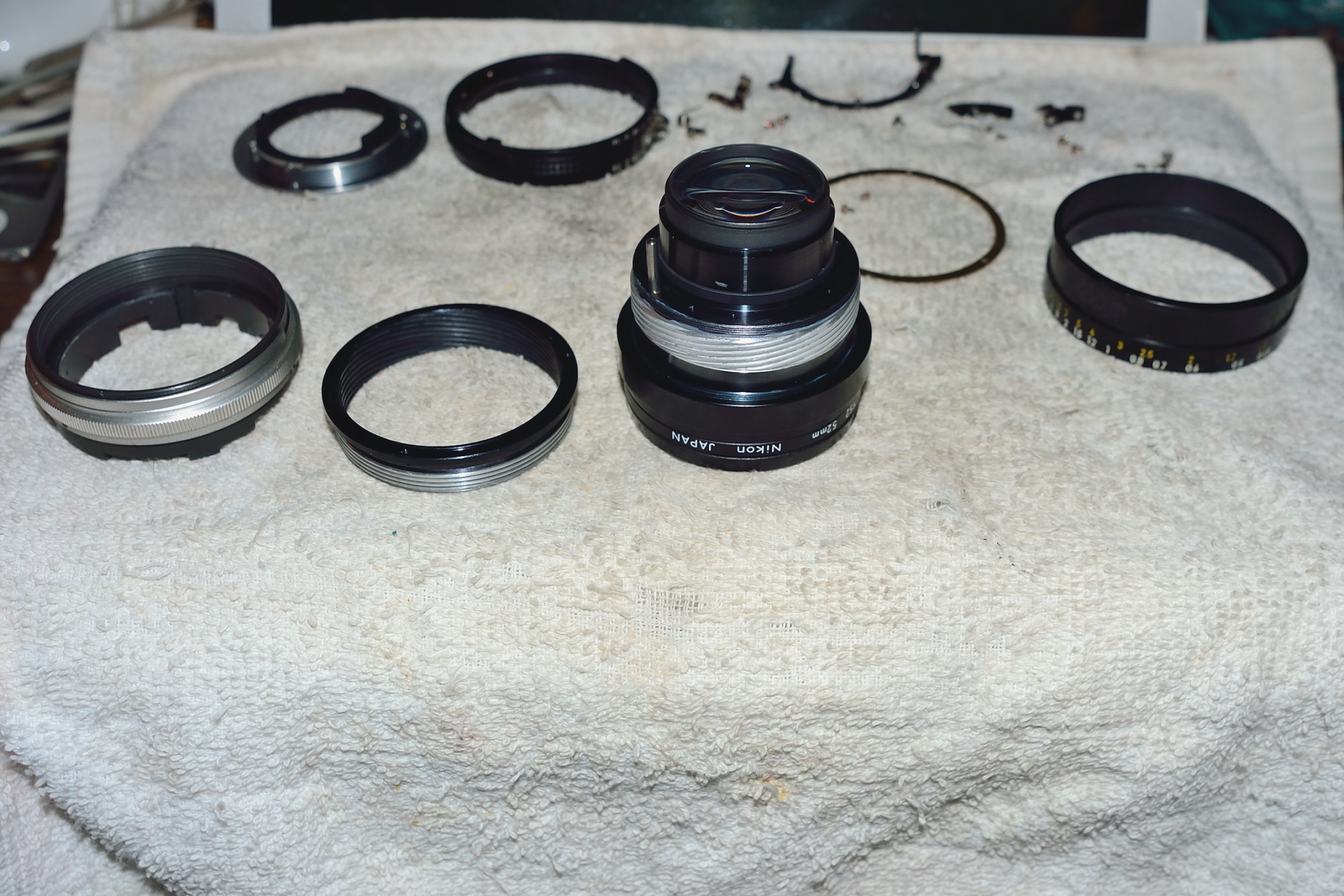

This is my 50/f1.4 Ais when I had the same issue. First time I ever tackled a lens. Works well now. I searched online and found an article outlining how to do it. It was nerve wracking but I made it through.
