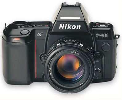

Another thing I noticed is the dealer with all the f90 said they ALL were sticky. He also had on display two n8008 for $35 each that essentially looked like new without any stickyness, so maybe n8008 are not prone to that issue.
ic-racer
ic-racer
Feb 25, 2007
16,664
USA
This is a stock photo (n8008/f801), but the ones I saw today looked just like this with no evidence of sticky residue on front or back.
Another realization is just about everything I recently purchased or inspected closely on ebay has issues. So, after not going to the photo show for a few years, I have a new appreciation of the face-to-face purchasing format. Seeing the camera and getting to try it out in person is the way to go.
