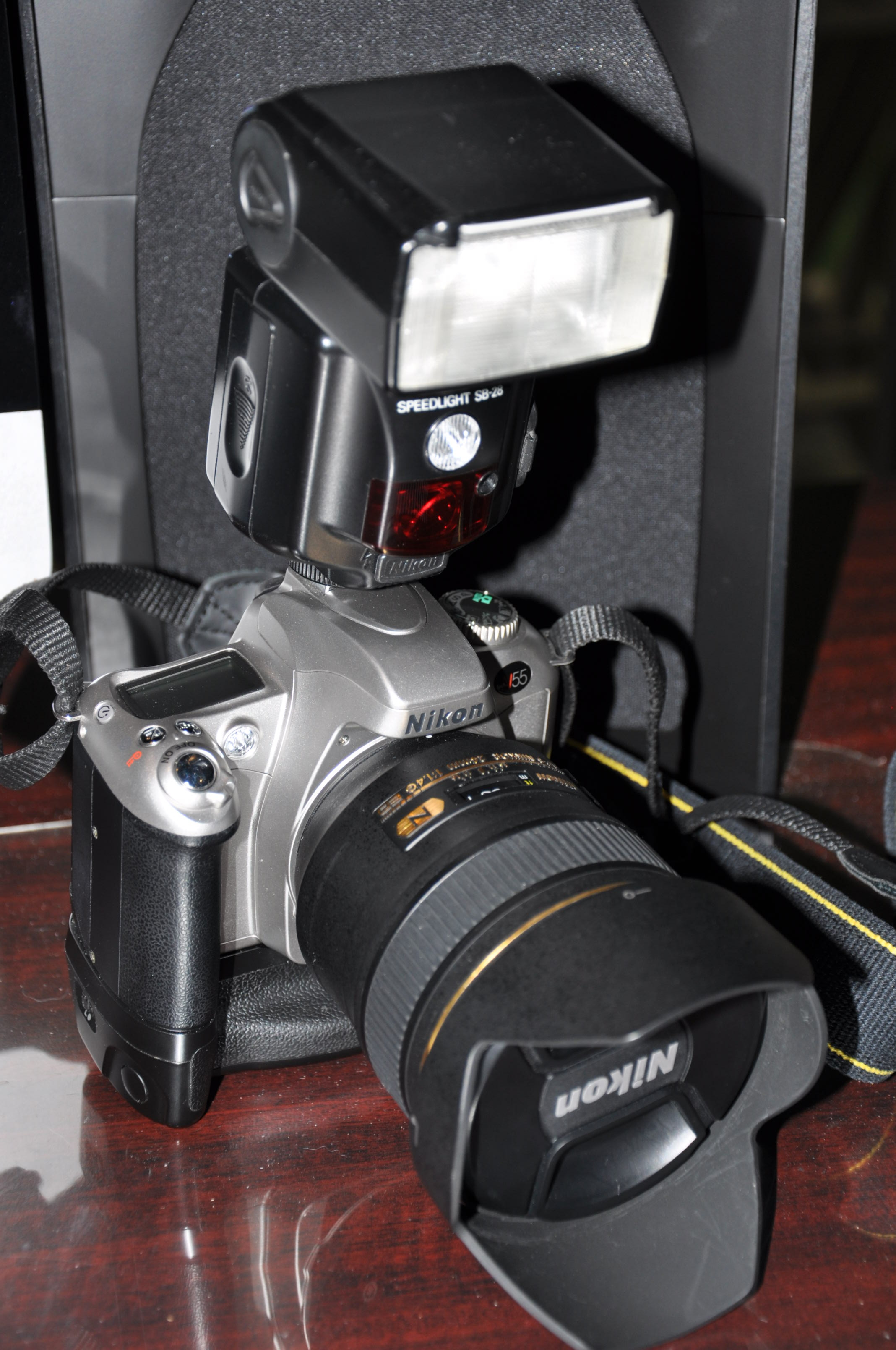

The Nikon N55 is similar to the N75 in many respects. However, there are a few features that are present on the N75 and not on the N55.
Some things the N55 Lacks compared to the N75:
TTL Flash
AF-S Autofocus
Aperture Preview
Two Focus zones (3 instead of 5)
Custom Features
Metal Lens Mount
Display Illumination
Exposure Lock Button
However, the N55 is still a vey capable camera, packed with other features like fast autofocus, Matrix metering, built-in flash and winder, shutter speeds from 30 sec to 1/2000 including "T," multiple exposure, bracketing, exposure compensation, A, P, S and M exposure modes, self timer, AF assist illumination, focus lock and more.
The AF-S lenses still work with all the metering modes, including Matrix.
The N55 can still be used with external flash, as long as the external flash has its own non-TTL sensor.
Here is an example of a configuration that works great and gives good results.
SB-28 in non-TTL Auto works great.
AF-S 24/1.4 lens gives focus confirmation with manual focus.
Also, a non-documented feature; the external 4-AA battery pack for the N75 works with the N55.
In general use, sometimes the lack of features is a plus. Operation is simpler. Perhaps less complexity can lead to improved freedom from failure in the long run.

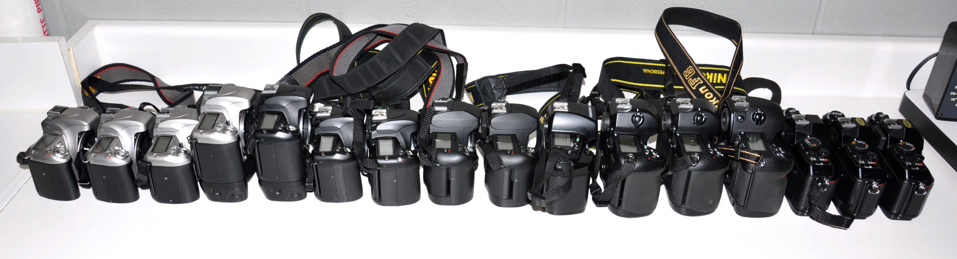

Due to some precieved reliability issues (that have never cropped up in my 12 years of late-model Nikon use) I acquired some spares.... (see picture below)

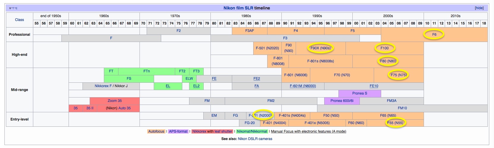

What is crazy here is that these are all 100% functional. If they came broken I was able to repair. So, I don't have a similar picture of broken Nikons. I actually have ZERO broken Nkion parts cameras. I have a 100% purchase success rate here, not a single dead camera in the whole bunch! Nikon was at its film camera peak with these cameras. The chart below has all the cameras in the picture circled.
Another thing about the chart below is the year the cameras came to market. You can see that prior to the F6, it was the F75 and F55. Thus my fascination with those two.
I think everyone is not surprised the average price ( leaving out the F6/F100) for these cameras was about $35 each.
I think that is crazy good compared to my Rolleiflex cameras.
I can post a picture of my Rolleiflex 35mm SLR cameras and I'm guessing it will show 75% functional and 25% bnroke on which I gave up on after quite a bit if trying (and I don't give up easy!).
Are you referring to that vertical grip which fits like a glove in the photo? that's neat. Does it have vertical controls for the shutter and aperture as well?
Yes the vertical grip that holds 4 AA batteries. However, the N55 does not have the contacts in the battery compartment to allow the extra shutter release to function. Other than that it works fine powering the camera. Also, unlike the N80 battery pack, the battery door can stay attached with the AA pack in place.
