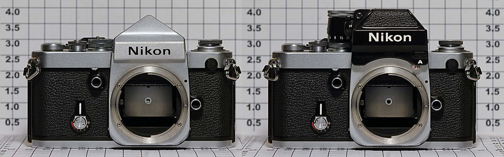

F doesn't have a meter unless it's the Photomic. I have an F2, which is an absolutely LOVELY camera, but the meter is old school and use is clunky, but works once you learn how to use it. The camera itself is extremely nice to use, though definitely all mechanical.
That said, If you're REALLY looking for mechanical with a meter, get an F2 and be done.
To be sure, the F2 only has a meter when using a metered viewfinder just like the original F. The F2 as a place for a battery in the body but the plain prism viewfinder does not have a meter.
