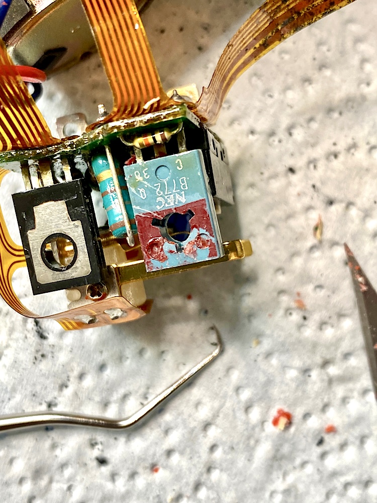

A craft solution
So I tied the tabs together with a fine jumper wire. And to reinforce it, the tip of a toothpick was used as a wedge:
The opposite station of the small „cable car“ is one of the power transistors in the handle of the MD-4.
I threaded the wire through the hole for attaching a cooling plate and fixed the work with a drop of Loctite:
It worked!
However, this means that there is constant tension on the transistor, which could affect the soldering point in the long term.

The green power transistor on which I mounted the „cable car“ is almost back to its original optical condition. Cable, toothpick tip to tighten the pull and glue are removed.
The scratched finish doesn't matter, the main thing is that the transistor switches as expected:
