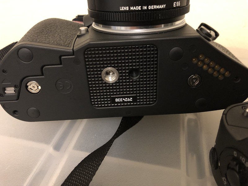

ok, the Leica R8 and R9 have add on motor drives w rewind that do not have a hole in the baseplate.
Unless the (rewind) motor is built into the body, I don't see how an add-on accessory motor drive could possibly power rewind the film without there being a hole in the bottom of the camera for a shaft to engage the film spool inside the film cartridge. The shaft has to retract so to allow the film to be loaded and unloaded - it cannot just be there. I guess one could posit a complex mechanism with gears and levers and all manner of mechanical clap-trap that could accomplish the task but it seems crazy and uneconomical to do it that way.
Leica R8 and R9 do.
Crazy shizzle! How do they do it?
Interesting…a review at JCH says some early ones scratched film!
https://www.japancamerahunter.com/2022/02/camera-geekery-leica-r8/
Yup my R8 scratched film. There is a nylon guide that the film runs over that pushes it into place. Actually a very cool design that sets tension etc. except that Leics specced too soft a material so it can wear prematurely and scratch film. I fixed mine by applying a tiny piece of scotch tape to the guide! That covered up the rough patch.
