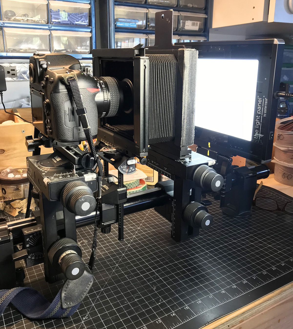

Before selling my otherwise perfect 9000ED scanner, I did rigorous tests of my Nikon D850 and 60mm Macro lens on the things I typically scan which is color slides and black and white negatives. I found that in most cases, the range and certainly the ease of using Lightroom CC to stitch into one large DNG file to well exceed what I could get done with my LS9000ED.
So I sold the scanner and bought a good used Sinar P2 with some spare parts and made it into a scanning station. I still use it for long lens work for stability but stitching a 120 or 4x5 neg is such a breeze with this setup I could never go back to what are now one trick ponies ( scanners ).
Here is the setup when in test stage:
AI Print: If you don't mind my asking (since I don't have any LF gear) what gear are you using for a 120 film holder... and the rest? Looks like a much better set up than I've used.
Looks like a nice setup if you want to spend time stitching, but the ICE, batch-scanning, and overall better optics of the Coolscan 9000 are still better than that setup.
