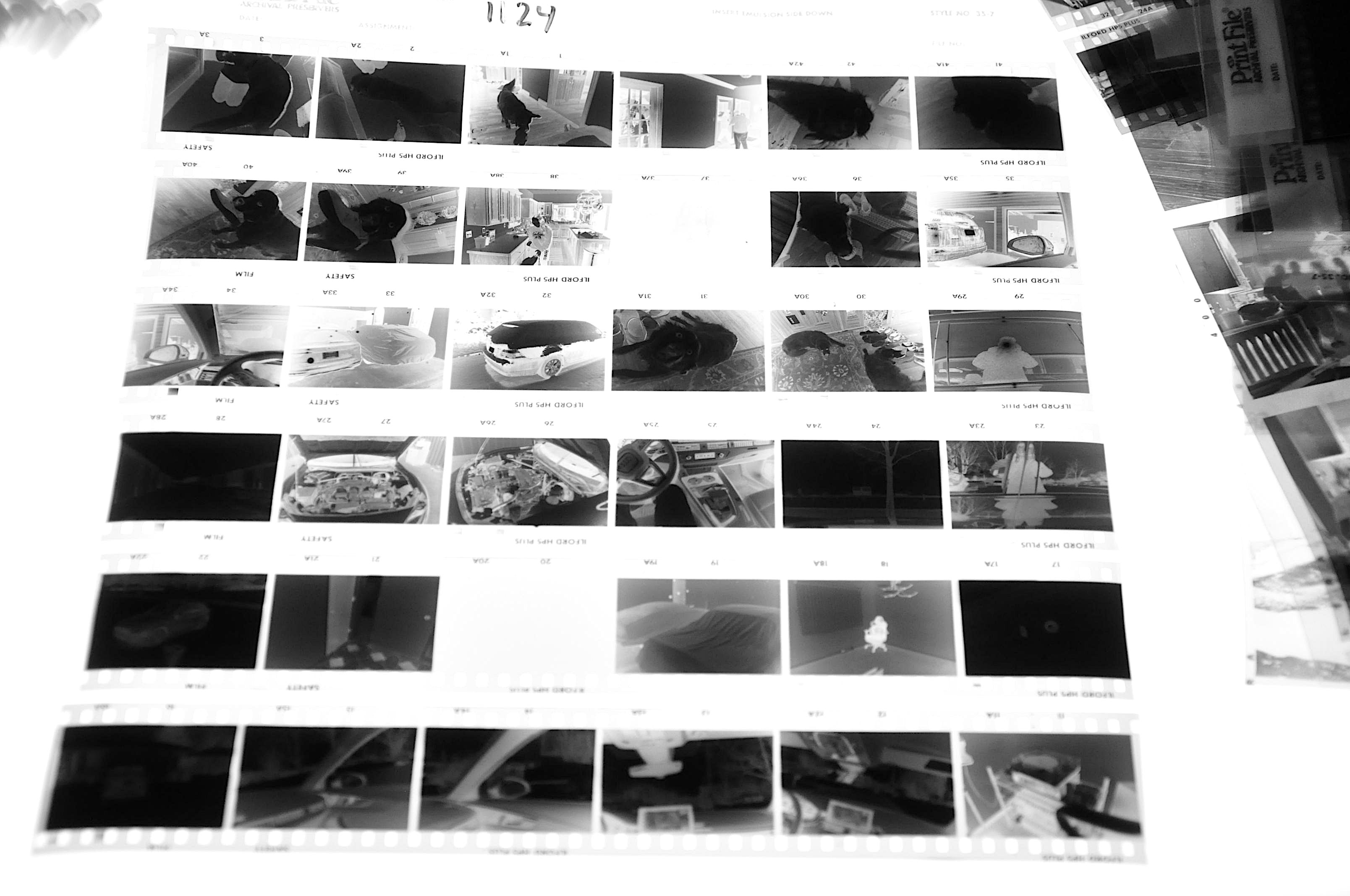

*To get the camera to fire with the exposure testing sensor at the film plane, a test roll needs to be loaded, then back opened and film removed. The latch needs to be popped closed by pressing on the little release. To cock the shutter, the gear that rides the sprocket holes, needs to be manually spun with one's finger.

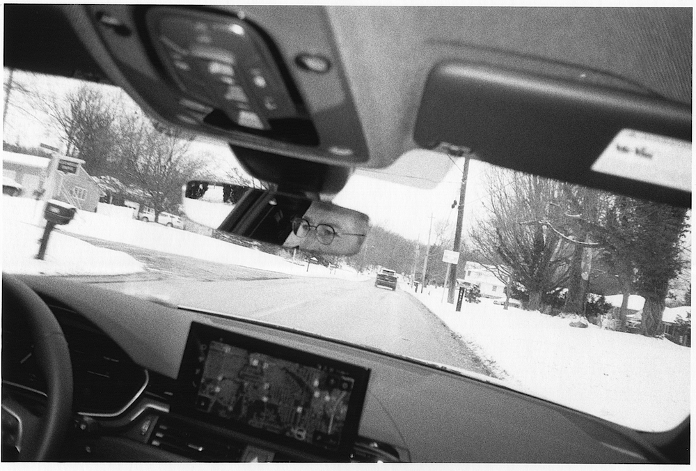

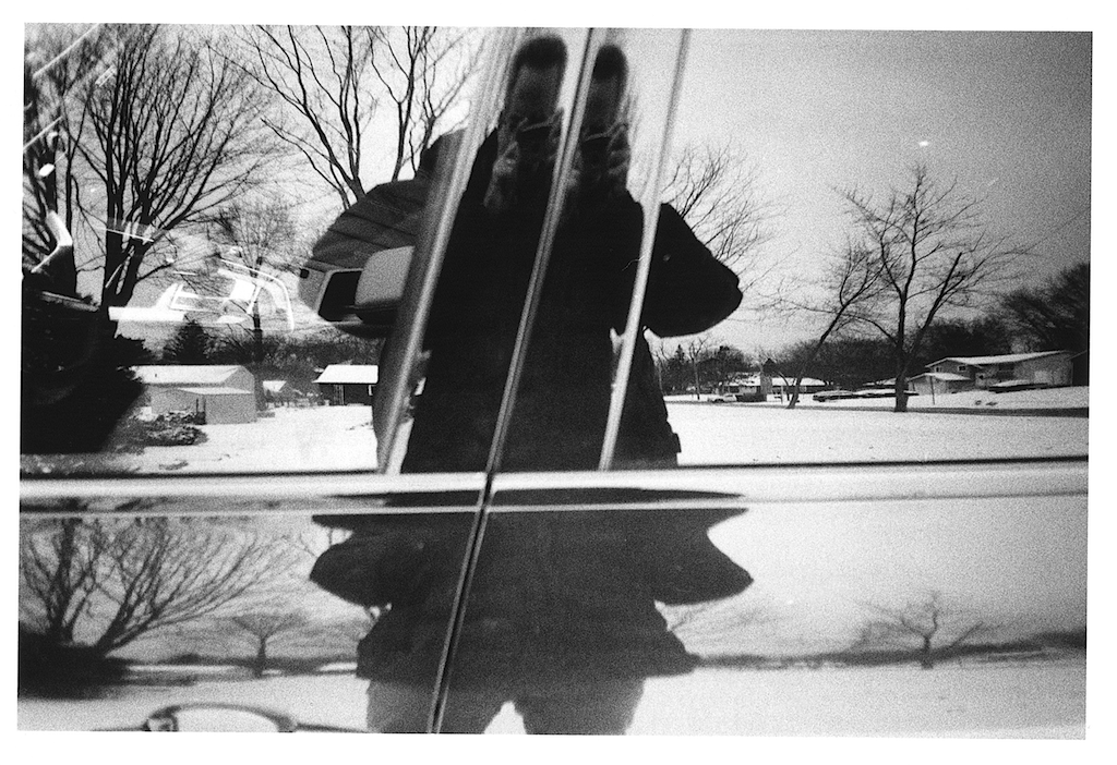

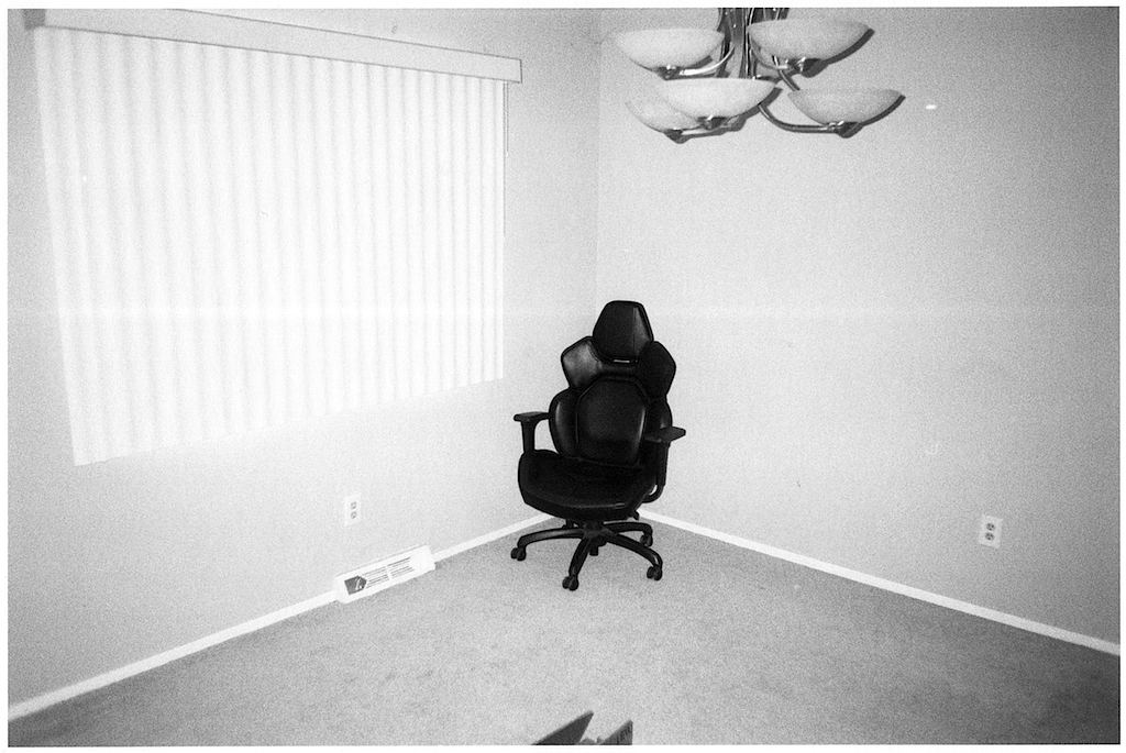

In spite of that poor proof sheet, if the light was correct, there would be the possiblity of a 'chance' correct exposure.
These are on 8x10" Foma warm tone, but scanned in B&W (note scanner artifact). Usually I photocopy my prints to avoid that kind of thing.
