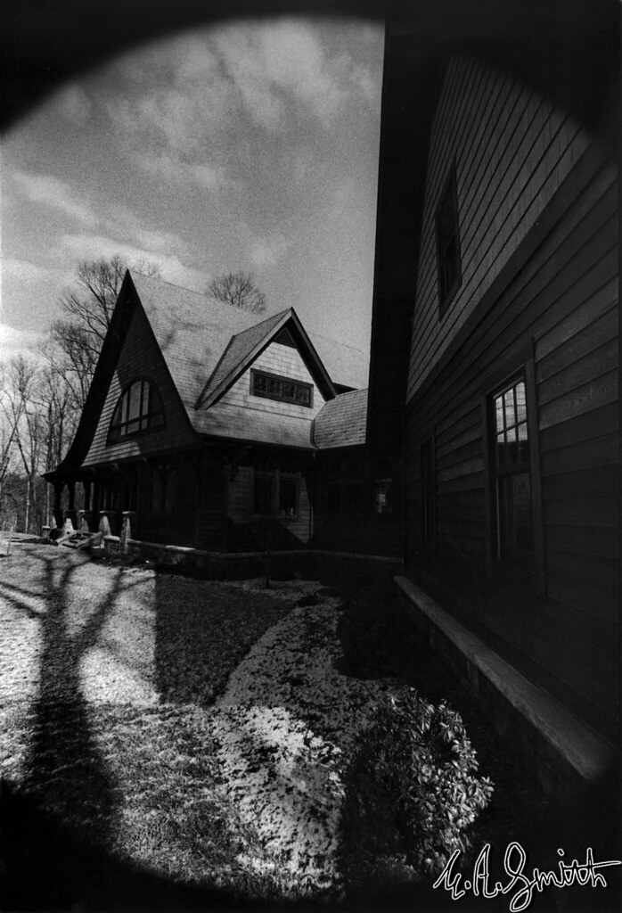

Try putting a DX 18-55 on a full frame SLR. It shoots everything at f32, but at 18mm is super wide.
removed-user-1
Try putting a DX 18-55 on a full frame SLR. It shoots everything at f22, but at 18mm is super wide.
*Some* of the DX lenses will cover full-frame even though they aren't designed to do so (the 18-55mm is one, I had one once and it would cover a 35mm frame from 24mm to 55mm). However, I'm not aware of any DX lenses that aren't also G-series, therefore they will not allow aperture adjustment on cameras like the FM. A better modern super-wide lens for the FM would be the AF-Nikkor 18-35mm f/3.5-4.5D, which is a full-frame lens with an aperture ring.

Very wide angle
