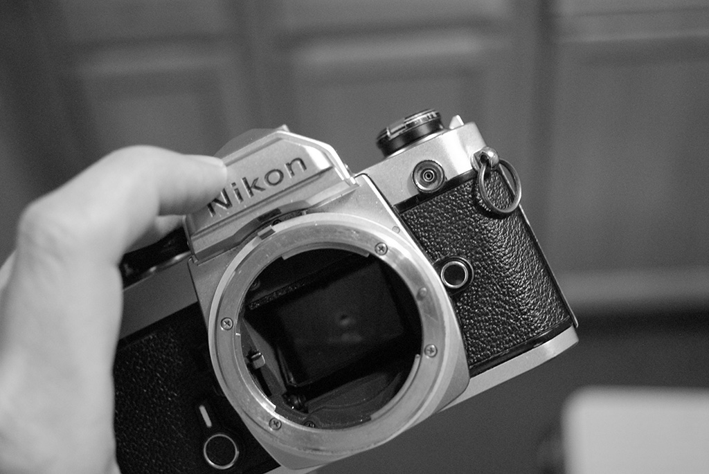

Just got a Nikon FM off eBay (I just never learn...though I mostly was buying the lens, FM was a bonus), and it seems to work pretty well, except the meter. At first, I couldn't get it to do anything besides light up underexposed (-). I set it to ASA 3200, 1 second shutter, and had the lens (28mm f/2.8) wide open...and it was saying underexposed - even with a bright subject. Switched to the 50mm f/1.8 lens, and played with it at bit, eventually got it to show up switching between over/proper exposure when pointing at my ceiling light (with the same ASA/shutter as before). I figured this was at least better, as it was showing some amount of reaction, but I new that it was wrong.
After some searching online, some had luck with just turning the ASA and shutter, blowing compressed air at it. I twisted about for awhile, and it had definitely gotten better, though I'm pretty sure it is still off. I don't have a can of compressed air, so haven't tried that yet.
Anyone have a similar circumstance in the past? I'm hoping some use wakes it up, since it has shown large improvement just in about 5-10 minutes of fiddling, but thought I'd check and see if anyone here has suggestions or experienced something similar.

OK, well I'm at lunch. Compared it to readings on the FE, it looks to be about 3 stops off (if the FE is correct anyway, I haven't had film developed from it.)
When I removed the lens to exercise the meter coupling lever...I noticed the lever is just a hair left of top center (looking at the front of the camera) as far as I know (and the pics in the manual, and online) it seems the lever should be at about a 33 degree angle to the right. Could this have something to do with it, and is there a way to ... return it to its rightful position?

The coupling is supposed to be about 30 degree to the right and not left of center so it's not in the right position. It's spring loaded to return to the right. You can push it back and forth. Won't do any harm. It could be a bit sticky. The fact that it's slight left of center then the camera think the lens is stopped down a few stop and thus your wrong reading. In another word, give it more exercise.

Sorry, I worded that wrong. I said the lever is off to the left, but the whole ring that the lever is a part of is off. As in, the lever pulls to the left further than where it sits at rest, and it springs back like it should...but the groove that the lever is in and moves back and forth in...it's too far over. So I believe the whole ring needs to move? This is a case where a picture is worth 1,000 words. I'll try to get one later!
Nov 3, 2012
29
Sorry, I was wrong with that last post. That's what I get for posting from memory about how a camera works that I've had for 1 day. Haha.
Gave it a little more force pushing with the lens past the point where the lens releases...and the coupler seems to have popped over to the proper position! Now to exercise it and get it (hopefully) loosened back up and working right.
Just for fun, here's the pic of where it was stuck (taken right before I got it.)
Thanks for the help!!
EDIT: Played a bit with the coupler, and no issues with it getting hung up again, so I mounted the lens back up and metering seems to be on target (though I haven't yet compared to the FE)
