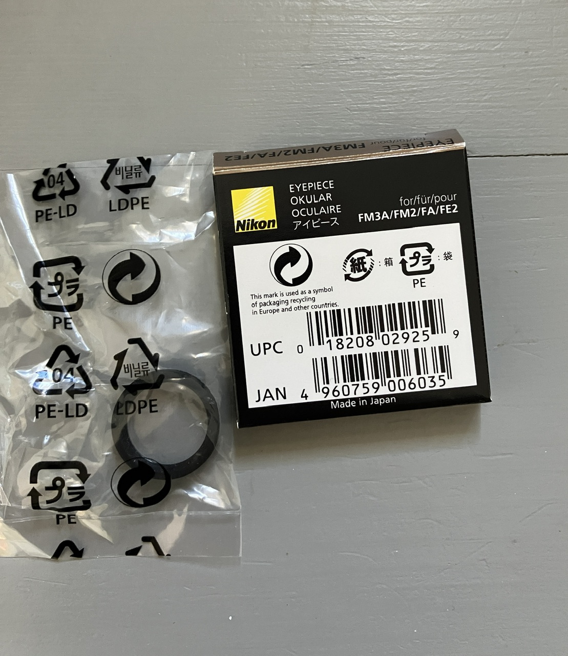

I look at Amazon and bought yesterday the eyepiece for Fm3/FM2/FA/ FE2 , and is not the right one, is too small and, the fact is that
my nikon FM has the screw thread externally ,while the internal part of the ocular is flat so is no way to screw something in it .

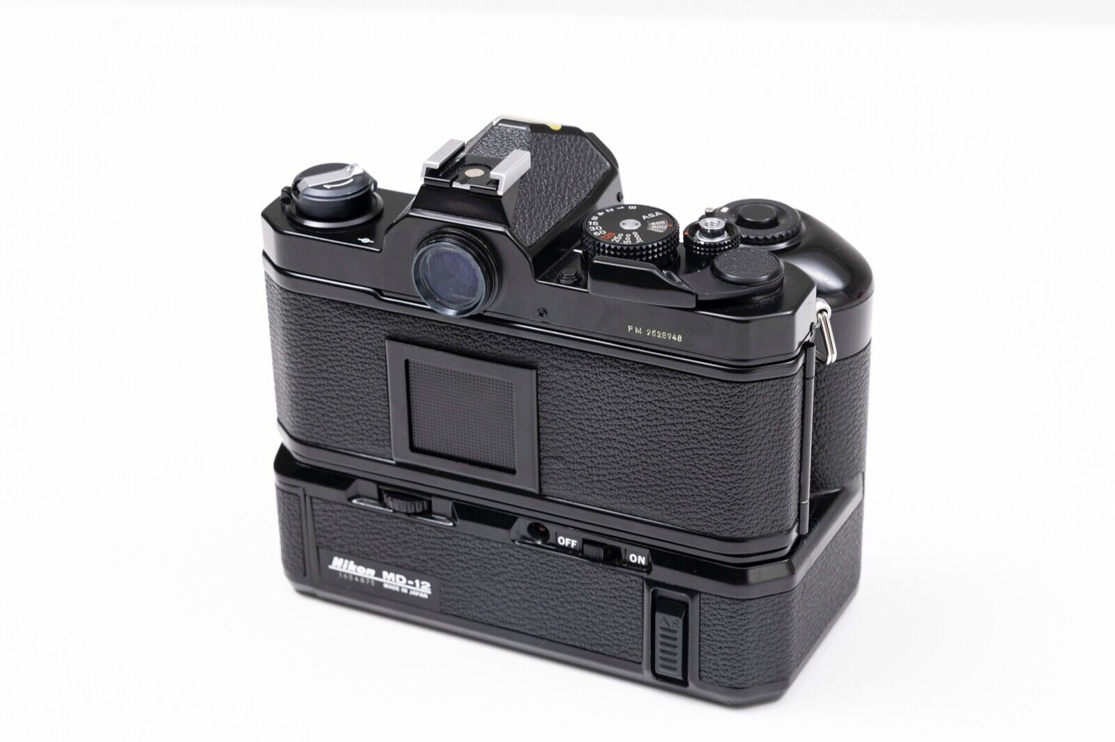

Hope the image works
As you can see the inner part of the ocular is flat so is impossible to screw the eyepiece,
while the external part has the screw thread .
The camera looks fine, so I think you're just having back luck with the eyepieces you are receiving. "Nikon 2925" is the proper part number.
Is what is written on the small box i bought , "2925" item number , so the ocular is the right one but can't be screwed,
i'm getting crazy .
In the photo shown in post #10, it appears that the eyepiece is present but the rubber outer part (to prevent scratching eyeglass lenses), is absent. You need to unscrew the damaged eyepiece so that you can screw in a new one, if it is your intention to replace it.
Without the rubber outer ring, there isn't much to grasp with your fingers. You might want to wear a pair of reasonably thick rubber gloves to increase the friction so that you can unscrew the original eyepiece.
With the eyepiece removed, you’ll see the rear surface of the built-in loupe, which is several millimeters deeper into the camera body than the eyepiece.

You're right, there was the ocular , damnation... i was getting crazy to find a solution,
i've screwed it out , now put the new one .
Thanks Ian, great observer .
