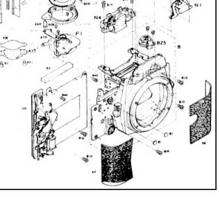

Do you see any tool marks on the mount screws that suggest someone has taken it apart before? Maybe someone took it apart and didn't get the pieces seated exactly right. IIRC, there are not any shims in an FE lens mount, but you have to nudge the spring for the aperture sensing ring out of the way when reassembling. The service manual has a good picture of how the pieces go together, although it doesn't show that spring.

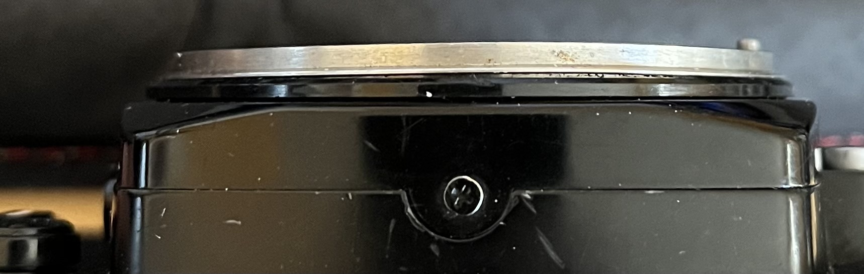

Well, I finally got around to removing the mount and checking it out. In what I hope is good news, it does not sit flat on a flat surface! There are a couple of spots with a very slight warp to them, which as it turns out are actually visible with the mount still attached. Why didn't I check that out earlier? The world may never know!
I ordered a spare mount for $15, which will be an absolute steal if it ends up working. Fingers crossed.

I don't see any shims or adjustment of the lens mount, just the specs in the service manual of 46.67 +/- 0.02mm to the pressure plate. If the camera has never been apart or dropped, maybe you are mistaken that there is a fault with the lens mount distance and should check other places of focus error.

Yes, a little odd. They describe checking the distance, but don't indicate what to do if it is off.
