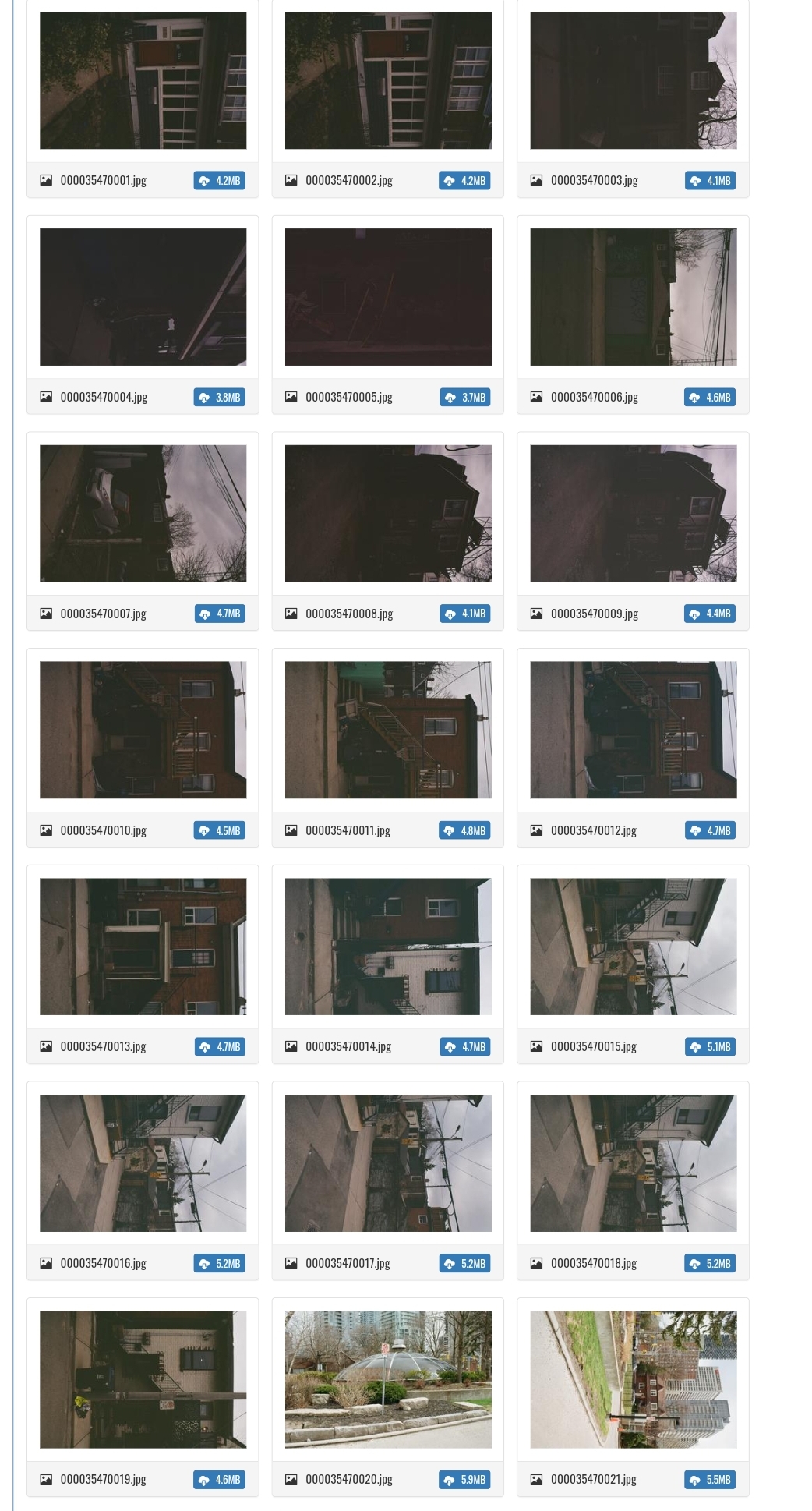

Hello, currently having an issue with my Nikon FE2, any advice would be greatly appreciated.
I've shot six rolls of film through this recently purchased FE2, oddly some negatives are properly exposed and some are not, some rolls have all 36 frames perfectly exposed and some rolls have mixed exposures with some frames being extremely under exposed being almost completely black (none over exposed).

What film are you using? Can you post a picture of the negs that are “black”? Even a cell phone pic will work. Include the rebate.

Thanks Brian! I'm in Ontario, Canada... I wish I was in California! I've attached some test shots of a partial roll with this message.

Some malfunction FE2 would release the shutter at 1/4000 from time to time regardless whether it's in auto or manual or what the exposure meter indicates. If it lost power to the second curtain magnet then the shutter speed is 1/4000.

Thanks Huss, sadly that seems to be the case with this camera as well. I think it's a faulty/dirty resistor.
Thanks Chan! Sounds like it's definitely time for me to take it in for service.
