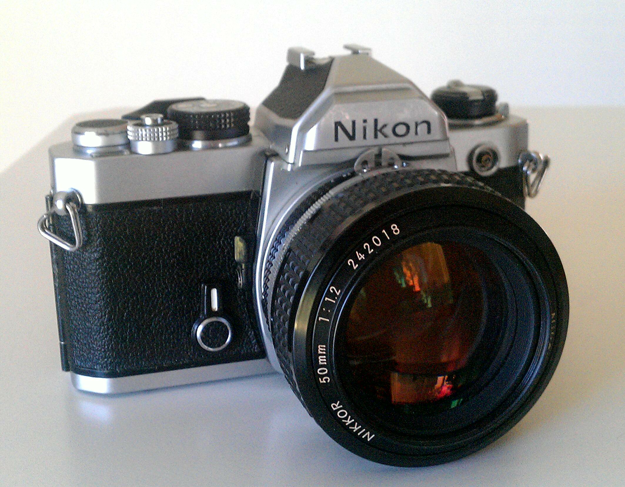

Having some Nikon issues and wondered if you could please help me.
The shutter button works every 30 or so winds. I move that locking lever on the advance so I can keep winding.
The mirror is not stuck and is down. I have tried using the mechanical B and M250 speed and have new batteries.
I’m guessing something is gooped up or worn. Strangely I’m having the same problem on both cameras. Any suggestions would be great!"
Here is a short video:
Thanks so much!!

There is no separate shutter lock lever on these cameras. Pushing the film advance lever flush against the body will lock the shutter button. Are you talking about the multiple exposure lever which is to the right of the advance lever?
Agreed that it's very strange to have intermittent shutter firing on the FM2. Being a mechanical shutter, it's either working or it's not. The FE2 may have an electronic issue, but these are both generally reliable cameras.
Have you downloaded the user manuals for these cameras yet?
In the video, I notice you're pressing on the shutter release while the film-wind lever is flush against the body - the lever needs to be pulled out to the "stand-off" position - otherwise the shutter won't release.

I had not noticed that and it looks as if there is no fault except the owner has not read or even seen the manuals for these cameras.
Thanks so much! I appreciate it. I'll have a try again and find an online manual, guess I assumed wrong about the wind lever. I guess it allows the user easier access to wind it again if it sticks out a little?

That for most cameras but the FM requires you have to have the wind level stick out.
Only the second version of the FM requires the standoff - the first version (identifiable by serrated release collar), does not:
None of the pro Nikons lock the shutter in this manner.
The second FM version and the FM2, FM3a, and FE2 require the standoff.

I have to check it out. I have both version the first version with lock collar around the shutter release and the second version which does not.
From the camera-wiki:
http://camera-wiki.org/wiki/Nikon_FM
"Variations
Early production FM's had a knurled rotating collar/switch located concentrically around the shutter release button; this switch functioned as a shutter release lock when the camera was used alone...
On these later production FM bodies, the shutter release lock was integrated into the film advance lever ..."

And you are correct. The first version works similar to the F2 that the film advance level out only for turning the meter on.
Thanks again everyone! So the FE2 works fine now, the FM2 works but its a bit more tricky.
The winding lever works most of the time, but it does get stuck and needs a little rattle to be able to wind it. Like this:
Any thoughts? Thanks!
