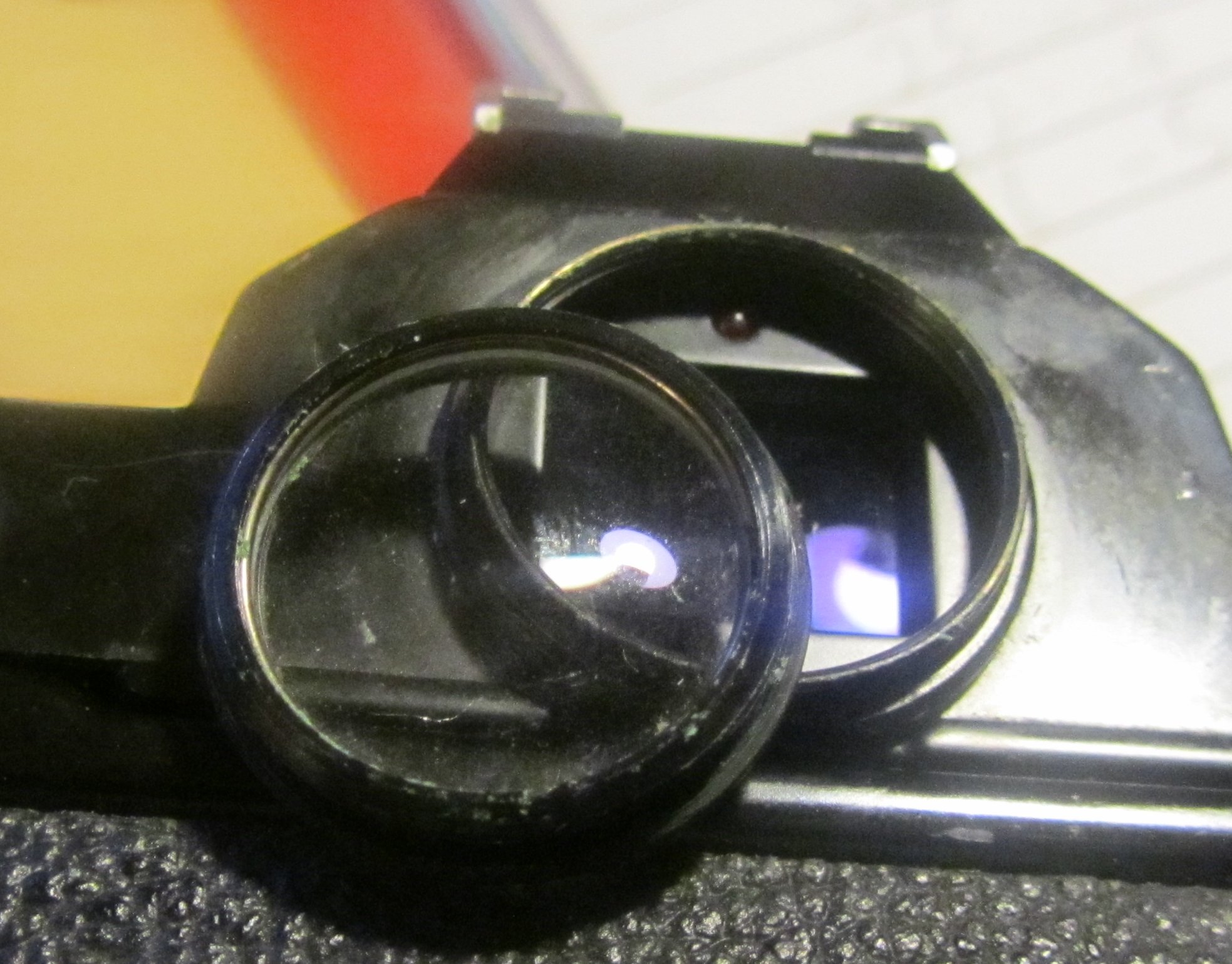

See if there is a glassless retainer ring screwed into the viewfinder of the camera.
Does it look like this?

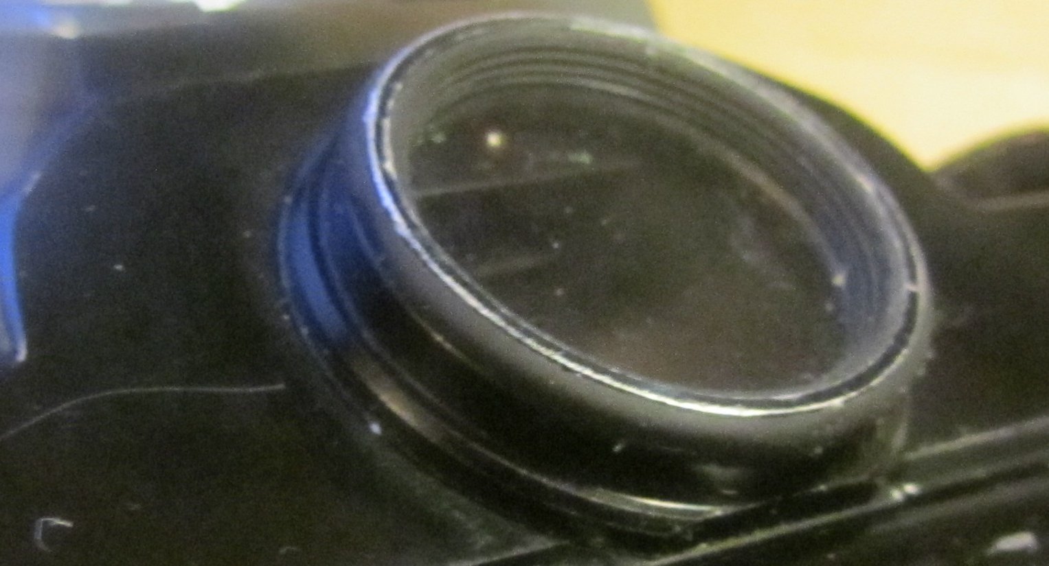

This is what a Nikon Eyepiece looks like when it's so old all the rubber has decayed away. It still unscrews though, so you should be able to replace it or use it to mount the rubber eye cup:
(note that the thread is internal to the ring where the eyepiece screws in)
