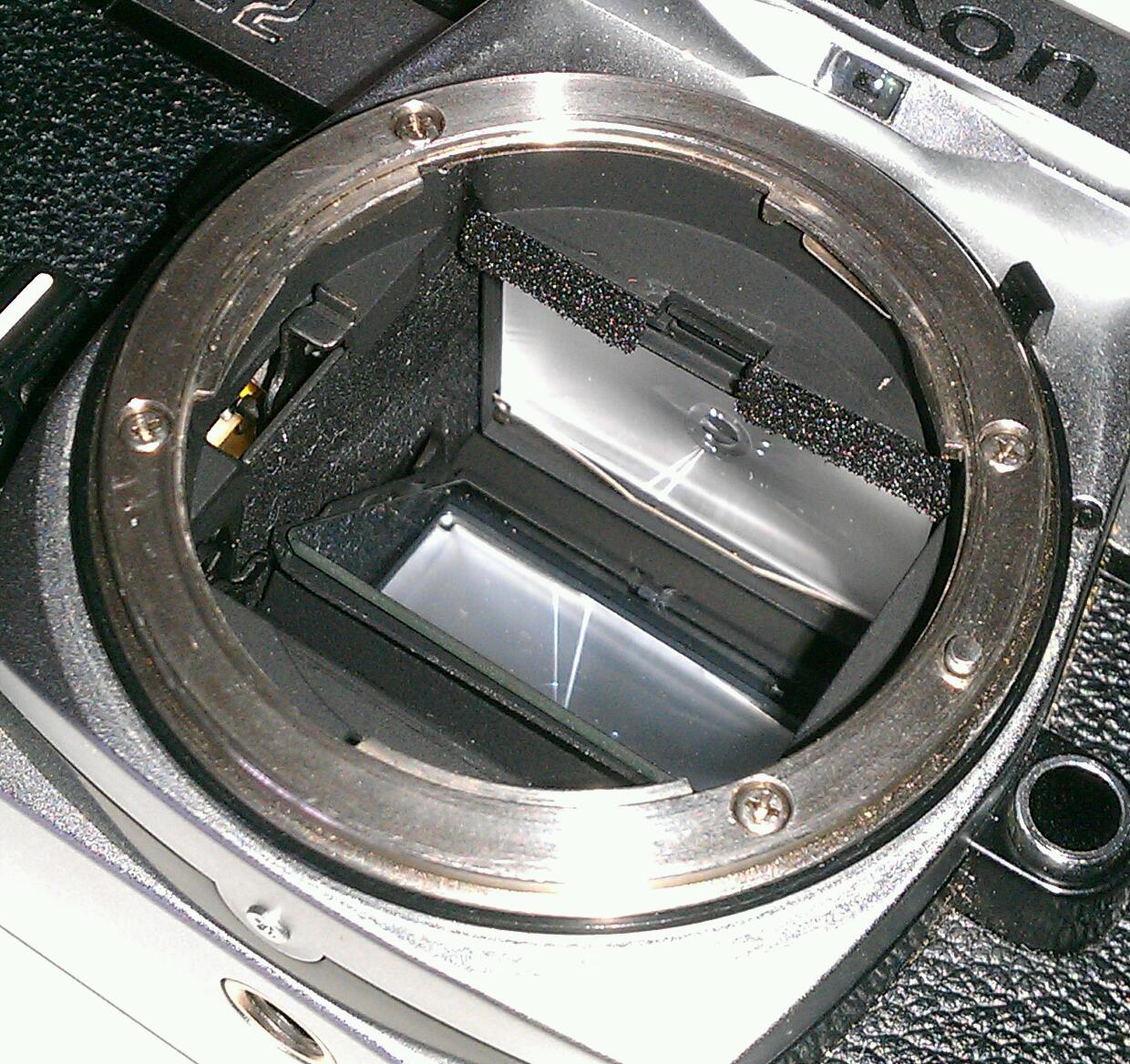

I'm playing around with a new-to-me FE2 body and I've tried a few Nikkor 50mm lenses on it. I'm focusing on an object that I always focus on whenever I get a new camera or lens. What I'm getting is 4' showing on the distance scale of various lenses when these same lenses on other bodies show the correct distance: 6'.
So, there's something wrong - the only thing I can think of is the focusing screen not being in the right plane. I've looked at it and it seems to be ok.
What say you?
Thanks in advance for help.

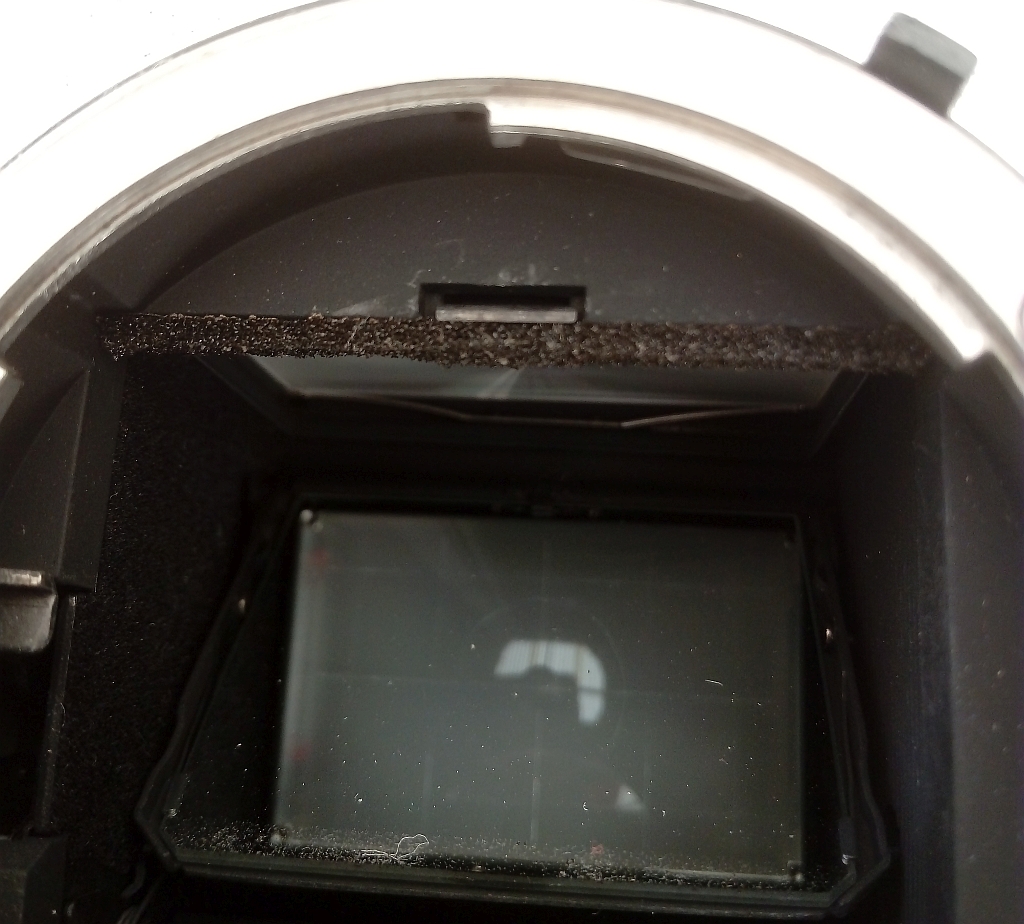

The screen:
Seems normally seated, right?
To remove the screen I don't have the tool that came with the camera - ok to use tweezers?

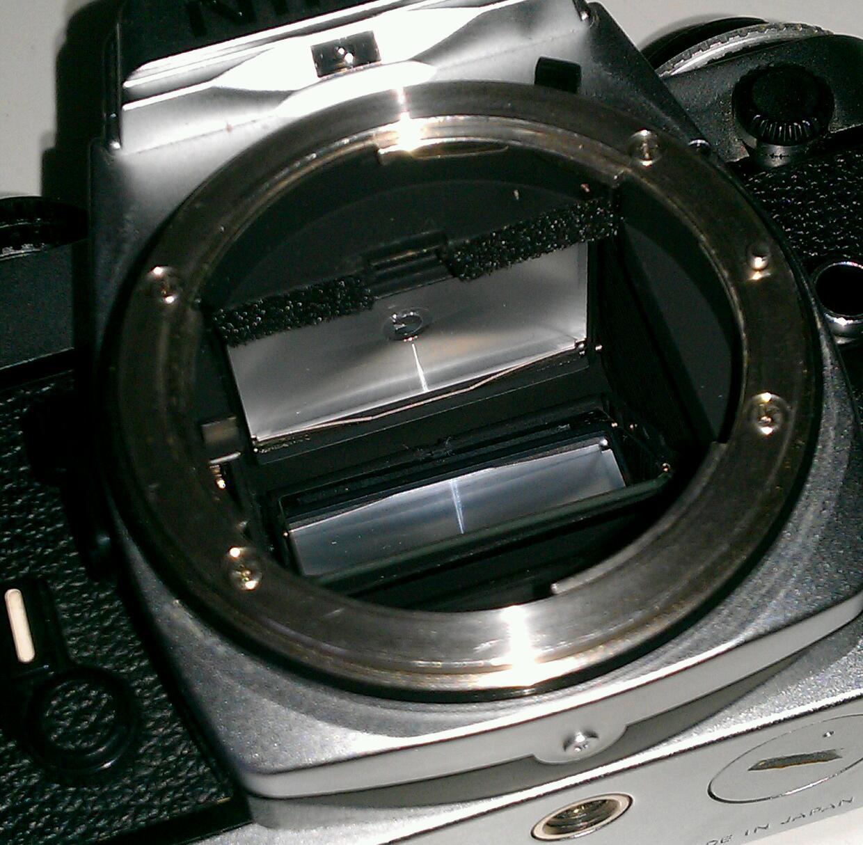

I pulled out my FE2 which is a very early model as I bought it more or less when they became available.
The tab that sits at the top of the picture, is in a different position on my camera, perhaps your focusing screen is not inserted correctly?
