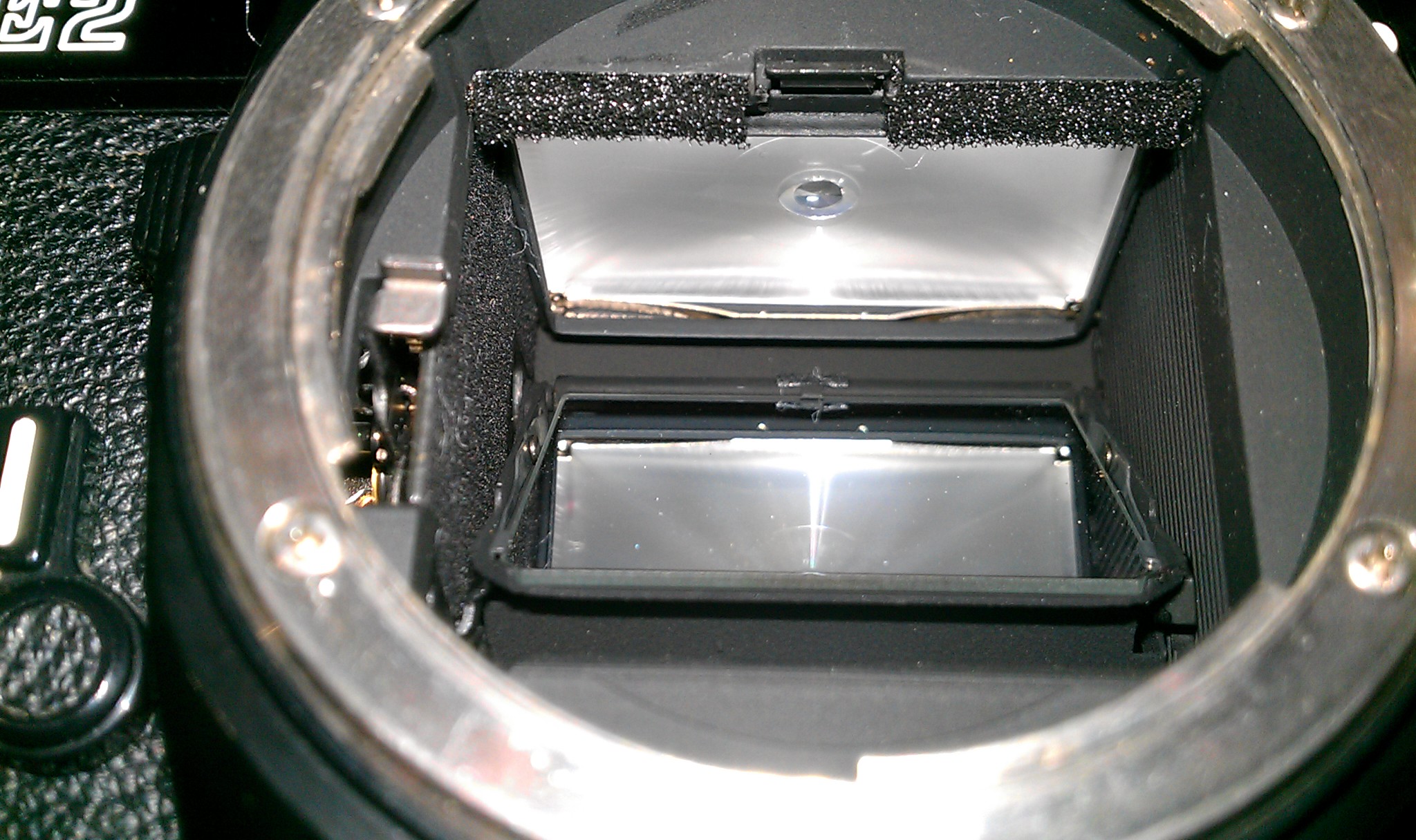

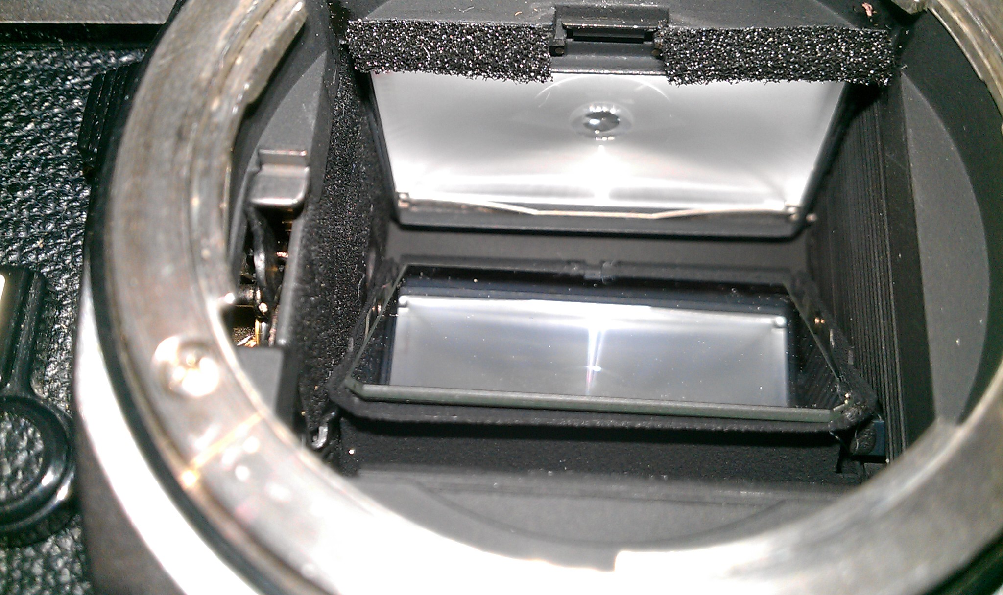

Ok - here is a photo of what the situation was.
In the first photo you'll see another FE2, black, with the mirror seated normally. Looking at each side edge near the bottom you'll see a small rectangular tab (gray and blurred) that goes over the mirror.
In this photo is my FE2 and the lower edge of the mirror is clearly up over the tab, not being held:
I'm embarrassed I didn't spot this (see post #10!). I was too focused (heh) on the groundglass.
