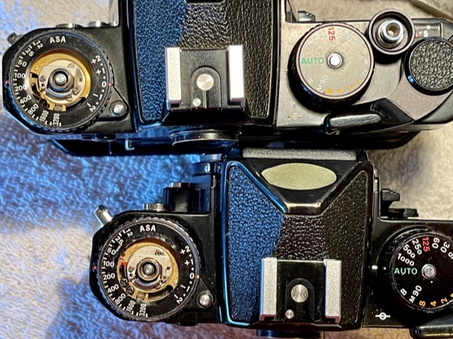

As a last effort before I give up I opened both Nikon FE's to compare the two potentiometers to see if something was obviously out of place, assembled wrongly, if that is even possible. Nope, they look identical. But they are 2 2/3 stops apart. The proven one that I have been using as a benchmark compared to the one I worked on. If I put identical 50mm lenses on both cameras and put them on a twin camera platform looking at the identical scene, I can get identical results in the "Auto" setting if I set the good meter at 125 ASA and the bad meter at 800 ASA. So it's usable as a backup with that caveat. But that's a rather huge caveat.
