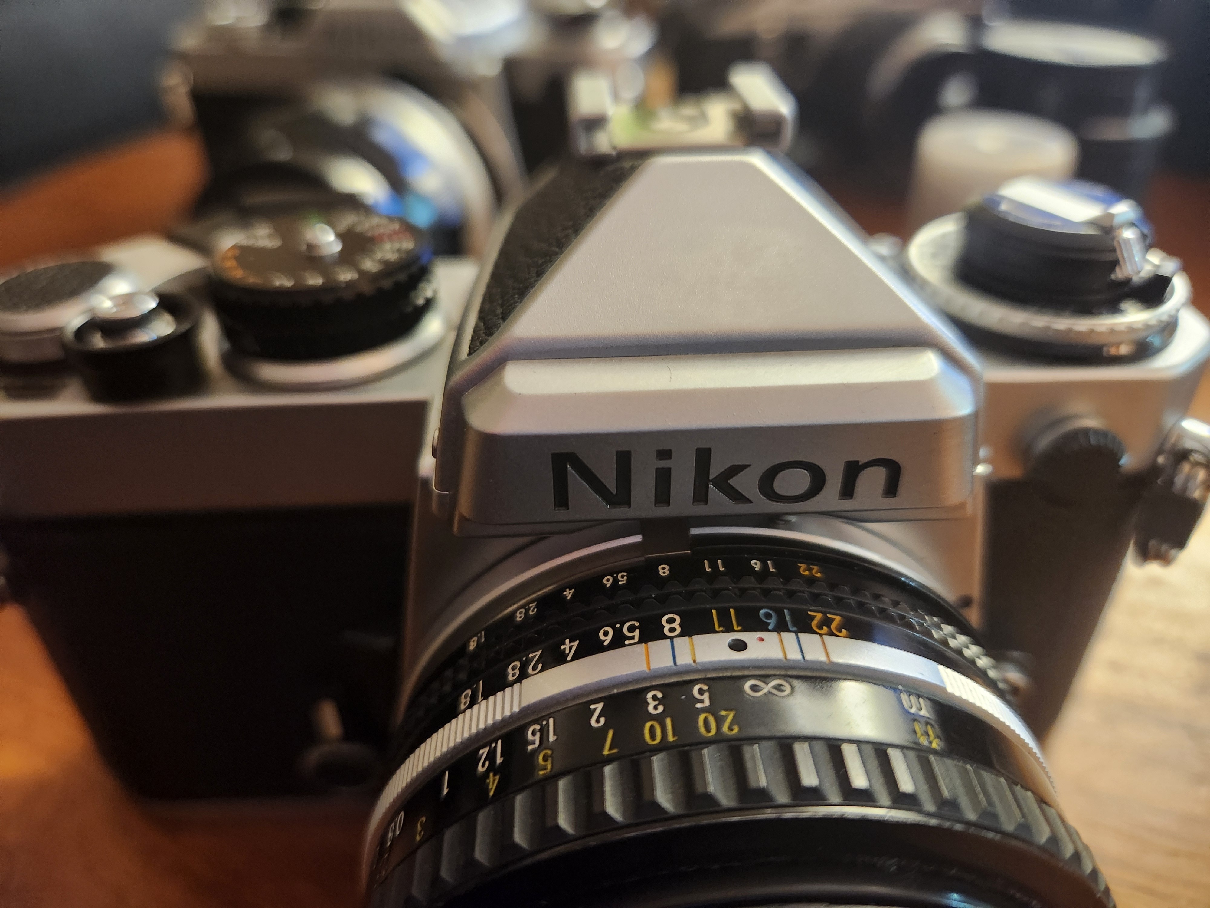

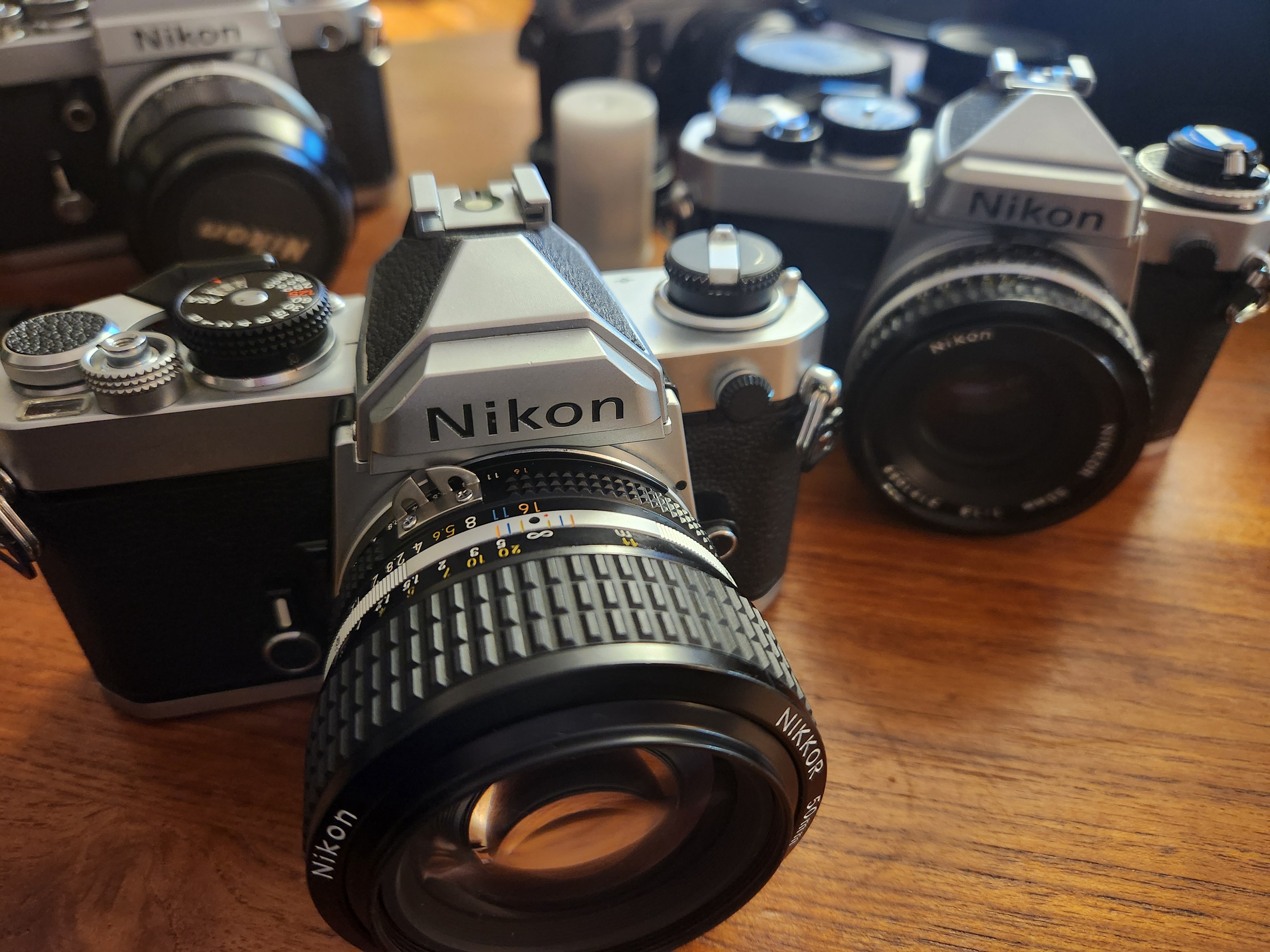

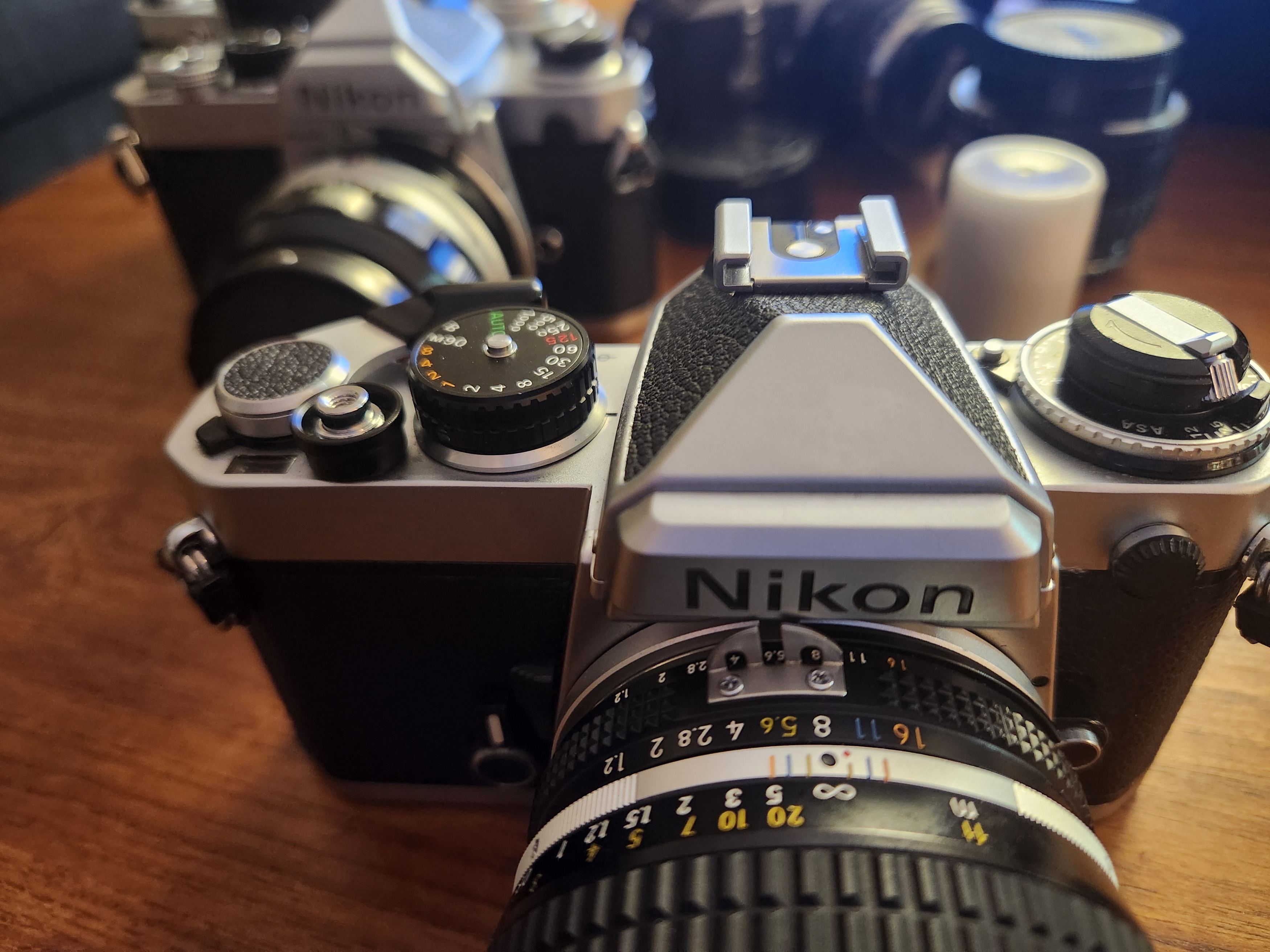

Hi,
when I mount an AI lens to my recently bought FE, I can not move the aperture ring past f/11. This also holds true when no lens is mounted and I try to move the AI tab manually (the lens is not the problem). The light meter shorts as well when I reach the hard stop at f/11.
What could be the issue?
-Leikkor
Japanese Pancake at minimum possible aperture.
50mm f/1.2 at minimum possible aperture.

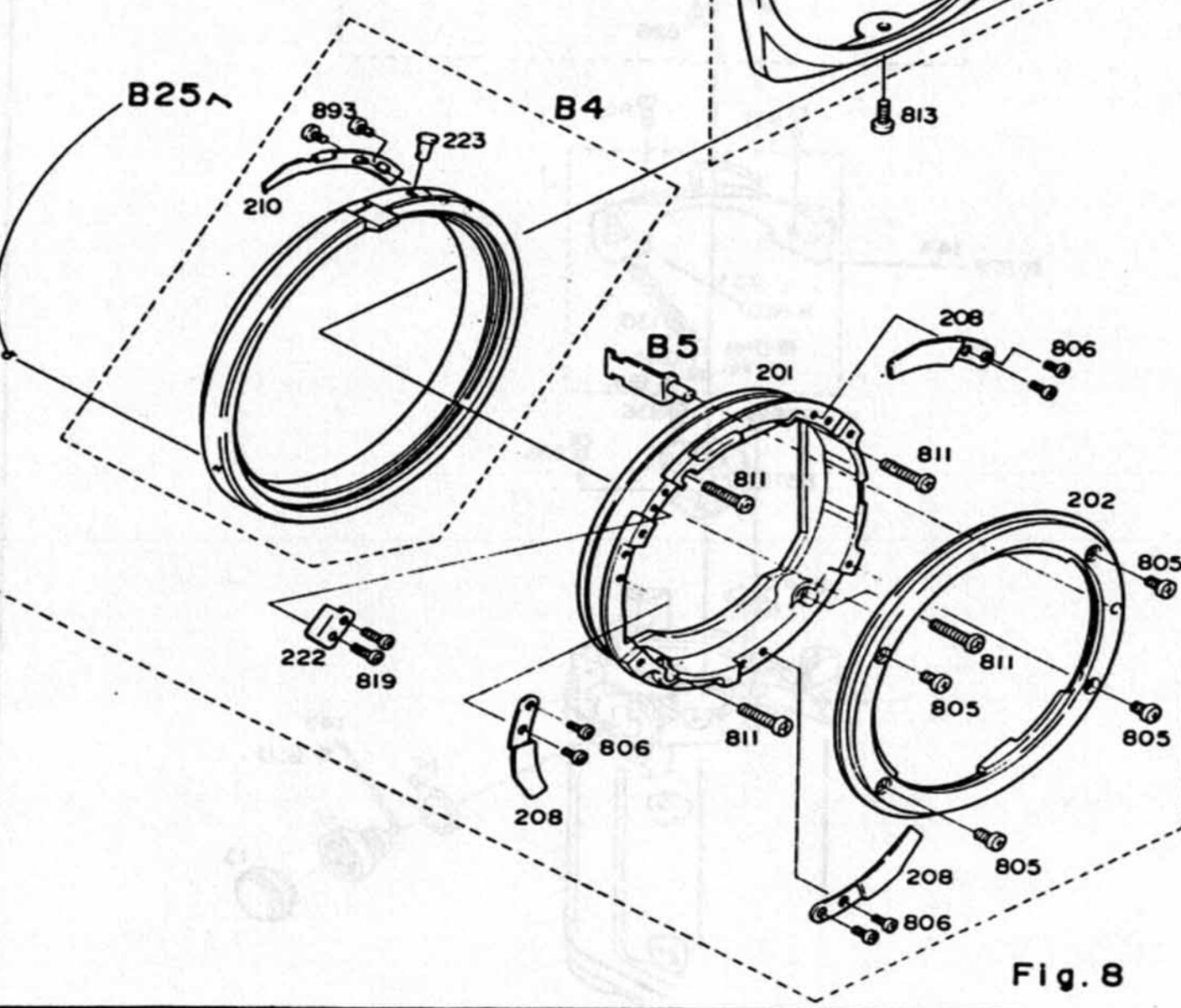

The AI tab is attached to a ring that rides around the lens mount under the flange that you see. There is a long coil spring attached to the ring that pulls it back into position. There may be dirt or an obstruction that is preventing it from turning, or the ring itself might be slightly bent out of shape, or possibly the part that the ring is attached to is preventing it from turning (what Brad suggested). If you have the right screwdriver and the right touch, it is possible to remove the lens mount flange and inspect the ring. Reassembling it requires keeping the spring in position while putting the flange back on, which is more difficult, IIRC.
Here's a diagram from the service manual.
Thank you MFstooges and reddesert. Your replies set my off towards the right direction.
Be careful with the lens release mechanism (B5) if it is removed then it's a little bit tricky to install, the hook on the body side has to engage the push button. Like reddesert said, putting them back together is the challenge so take a LOT of pictures of things before you take it apart and every stage of your disassembly from many angles.
