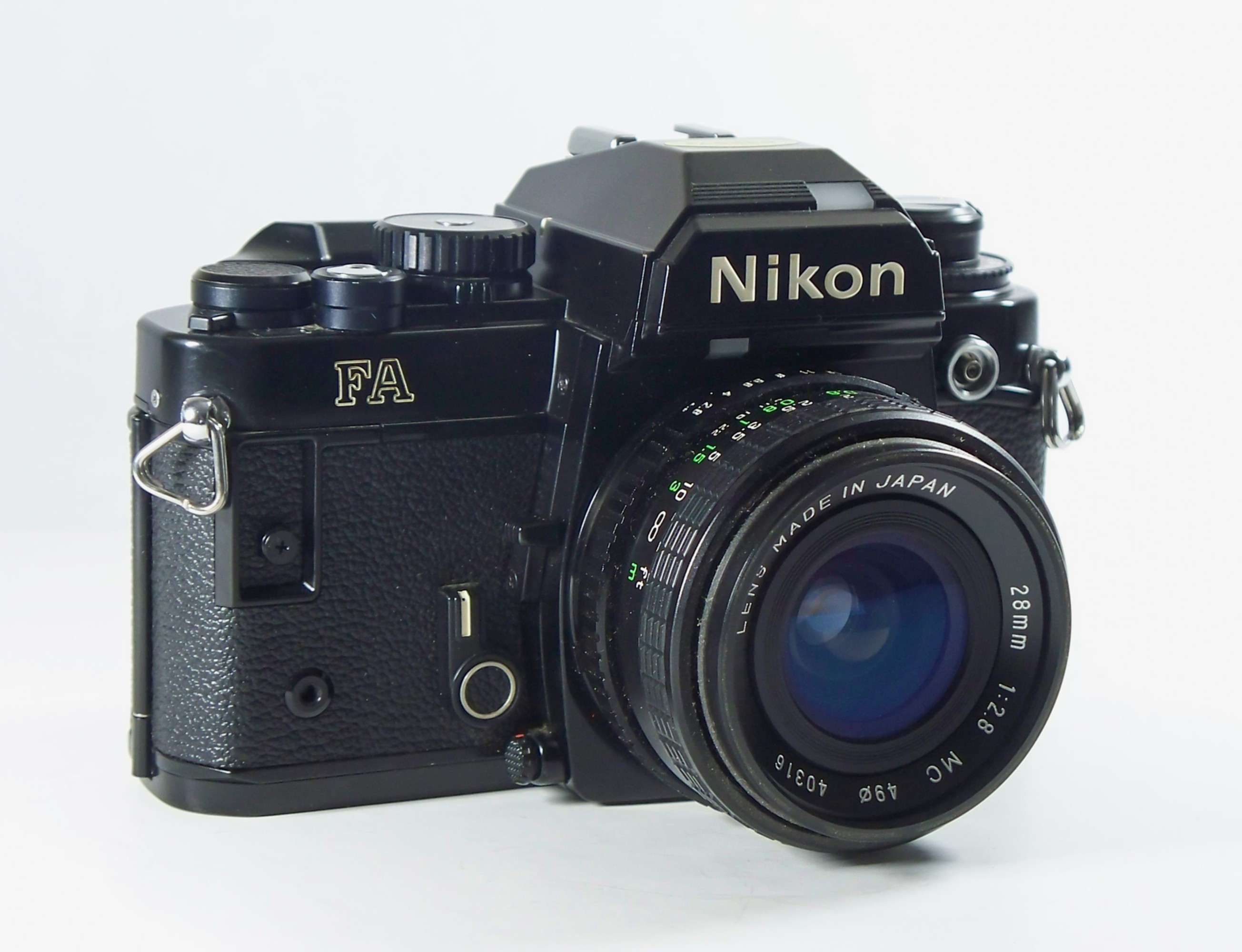

Well, mine works just fine. The FA is a must have for any Nikon collector.
