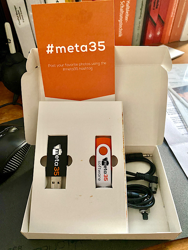

This is an opportunity for me to get back to work with meta35.
This is a set consisting of software for Windows and Mac, a USB adapter and a connection cable for a specific SLR.
I have the cables for the Nikon F5 and Canon EOS-1V.
These can be used to load metadata from the camera's data storage and assign scans.
In addition, individual camera functions can be set, for example on the Nikon F5.
Nikon's software for this was Photo Secretary in conjunction with certain MC data cables.
It's a pity that meta35 was discontinued in 2021.

I have the Nikon software and I used it to ease the shooting data and set the custom function. I use the custom function to eliminate P and S modes.

Didn't Nikon use proprietary plugs/adapters on the cables? Why didn't Nikon use USB?
When the F5 was introduced USB was very new. The F5 10 pin connector are for both serial communication and discrete controls like remote shutter release.
From what I remember, the Nikon 10 pin adapter is their own proprietary serial implementation and dates back maybe to the N90? They actually pretty freely shared it with Kodak to build the DCS 200 and 400 series digital backs, which use that port to sync the digital functions of the back with the camera body. The DCS 600 and 700 series are based on the F5 body and I think use the protocol internally(leaving the port on the front free). I've been inside my DCS 760, though, and it very much looks like a "Digital back for an F5" just without the obvious place to detach it. The DCS 14/n and SLR/n have this same sort of feel also, although use a lower end body.
The original MC-34 and MC-35 cables for use with Photosecretary used the then common peripheral ports-DB9 RS-232 for the PC version and Mini-Din-9 RS-432 for Mac. BTW, I have the Mac version of the cable(along with the Meta-35 set-up) but have never found a copy of the Mac version of the software. If anyone has a lead on any version of it, please let me know!
Unfortunately too, for those of us who use Macs, we've been left behind by Meta-35 also on our current computers since AFAIK they never updated to 64 bit. The only version I have runs on I think OS X 10.9(Mavericks) or so to macOS 10.14(Mojave). I wrote to them at one point and asked for an older version of the software that would run on 10.6.8, since that's what my scanning workstation runs(compatibility with NikonScan...) but I don't think the version they sent me worked...
Ah. I had never considered the remote release interface. That makes sense. I've forgotten how frustrating the old computer systems were when it came to peripherals.
