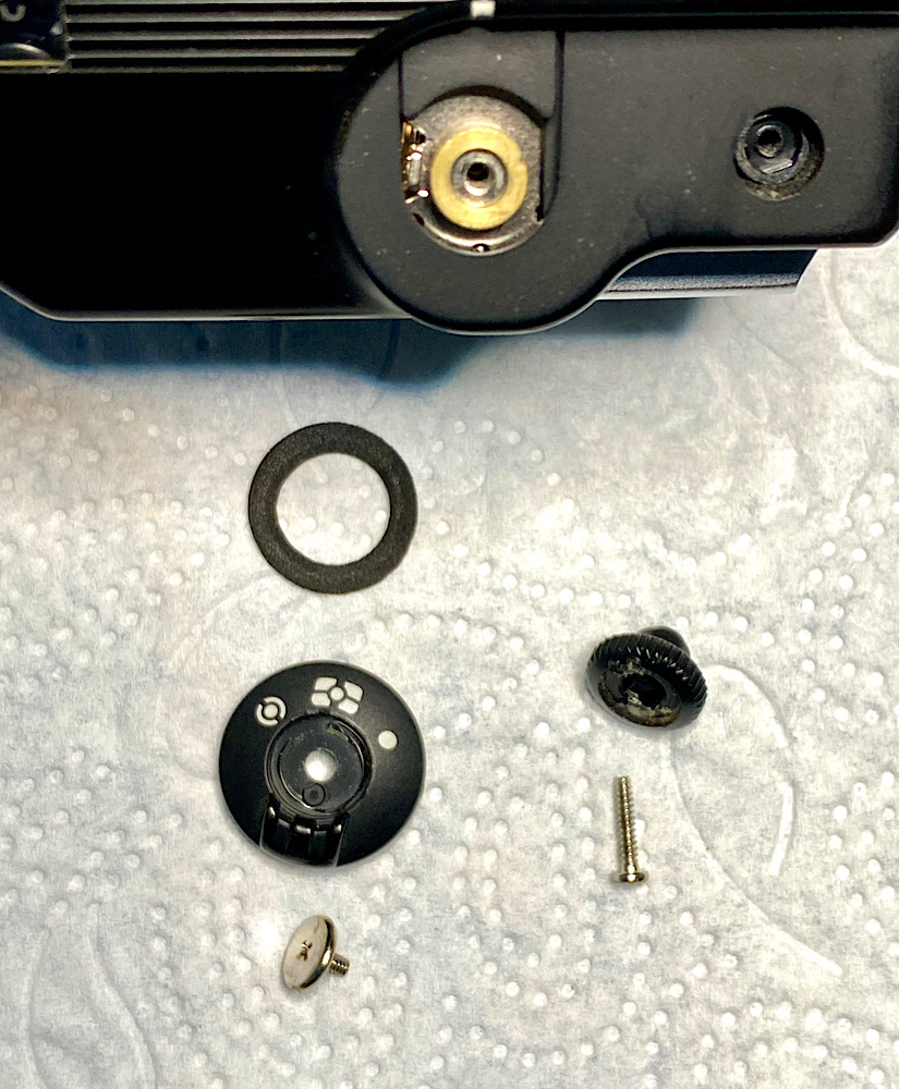

During his lifetime, my father gave me his F5, which he had used to photograph archaeological excavations in North Africa.
He cleaned the dustproof housing of desert sand residues, I found a few grains of sand which I removed and removed a rubber ring which my father had inserted under the safety switch in addition to blocking the portrait format shutter release.
Everything worked.
Everything worked.
Yours looks like mine.

I wasn't talking about viewfinder, I was talking about the metering selector (tiny switch to go from matrix to spot to centre weighted)
It's probably made of plastic as with its predecessor F4.
I assume it will look similar underneath to this:
I don't know how you could break the ring through normal use.
But if you're talking about the F-100, what happened to the ring?
