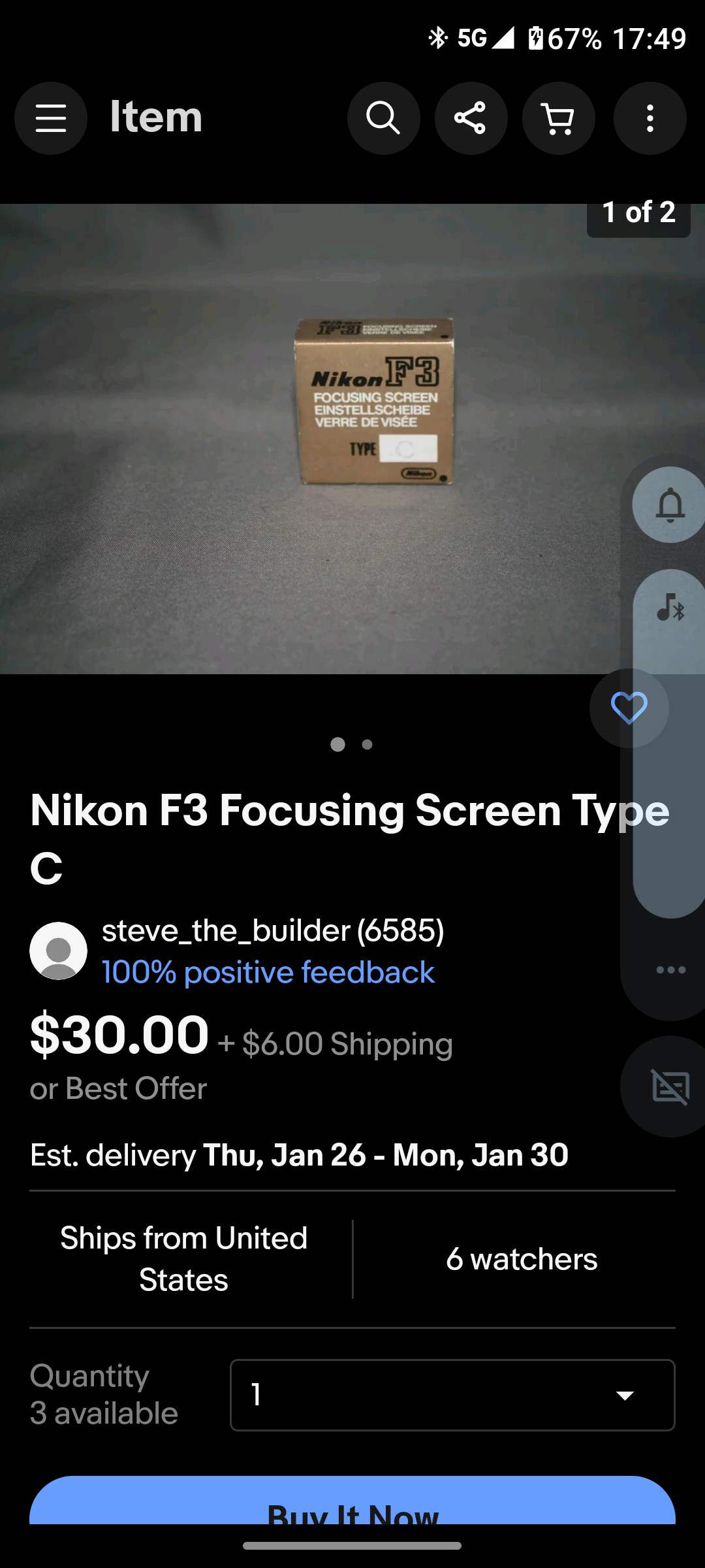

Do a Google search for exactly what you are looking for...I think the F3 focusing screens might work?
An F3 screen will Not work. I would suggest either the B or the U screen, both of which will likely be easier to find than a C screen. The B and U do not have the LCD inter-layer, so the view is brighter.
